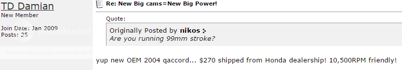

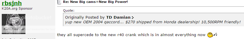

#31 ·
Bump again guys . Anyone rev this crank higher than 9k I think I've heard of the accord crank being reved to 10.5k . Since this crank is forged it should be able to rev to the moon . ?
