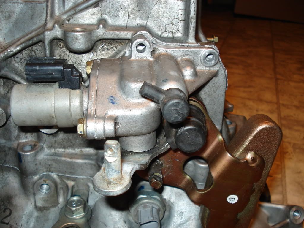

Its doable, but you really need to secure the case, you'll never drill perfectly straight. I have yet to install my modified case, but it should work. Oh and a drill bit is like 50 bucks. I got mine at www.mcmastercarr.com
Before:
Drilled:
You have to grind the tab to it sits flush and then drill and tap it.
Done:
If you have any questions you can pm me. I'll try to answer them.
