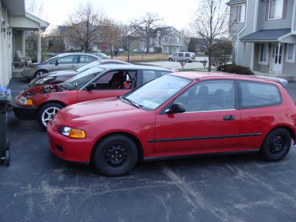

So the story behind this swap i find a bit amusing, this EG started out as my daily driver. It was a single cam non-vtec D15 turd. But it got me around while i was building my old EF race car. The original motor started burning a lot of oil so i swapped in a D15B i got from a friend for $100, i picked up some teins at the same time, so i threw those on and put my kosei's off my EF on it

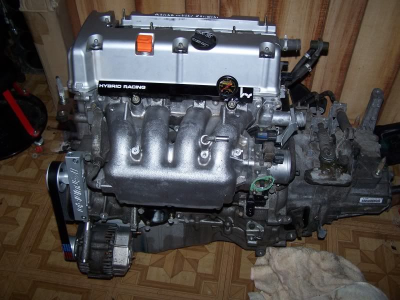

the D15B started to annoy me in its lack of power, so i ended up driving from chicago to mi to meet vietdragon and buy his B20 and GSR trans. Got back to chicago to hear that a friend of mine was getting rid of his K20A2 because he went to a K20A. Immediatly sold the B20 and went and picked up the K20A2. That all took place around november and i bought the K20A2 in December. From there i just began collecting parts. I dealt with both Mike@Ktuned and the guys over at Hybrid Racing, both great companys :up:.
the parts i have:
Hybrid Racing Black Anodized mounts
Hybrid Racing Bolt in shifter :up:
Hybrid Racing Jumper harness

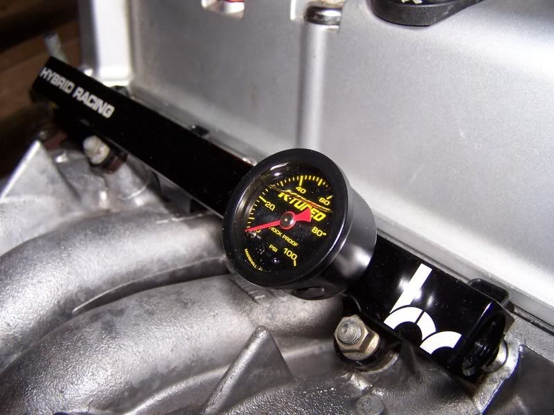

Hybrid Racing Fuel Rail
Ktuned Fuel pressure regulator
Ktuned Fuel pressure gauge
Ktuned A/C and P/S delete
Ktuned Billet throttle cable bracket and cable
Ktuned stainless clutch line
Ktuned thermostat housing
Ktuned passenger side radiator kit
Ktuned immobilizer bypass

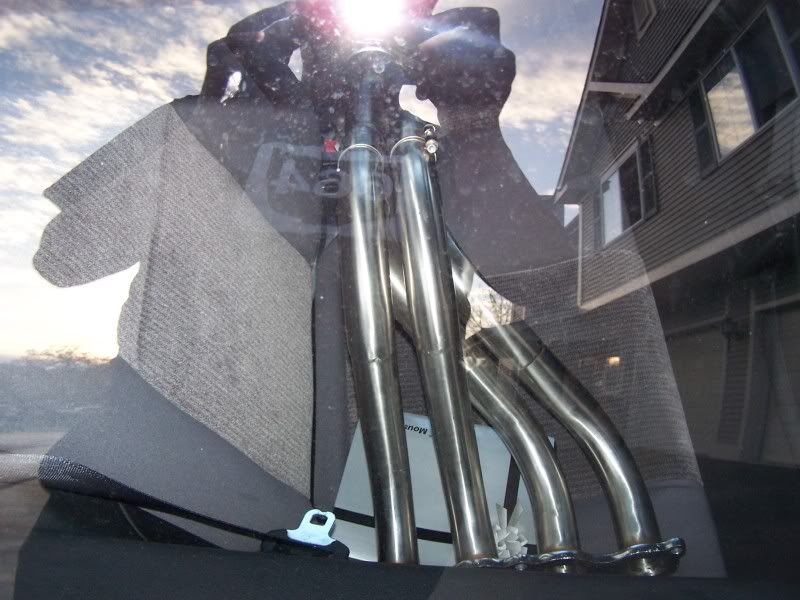

Swap header

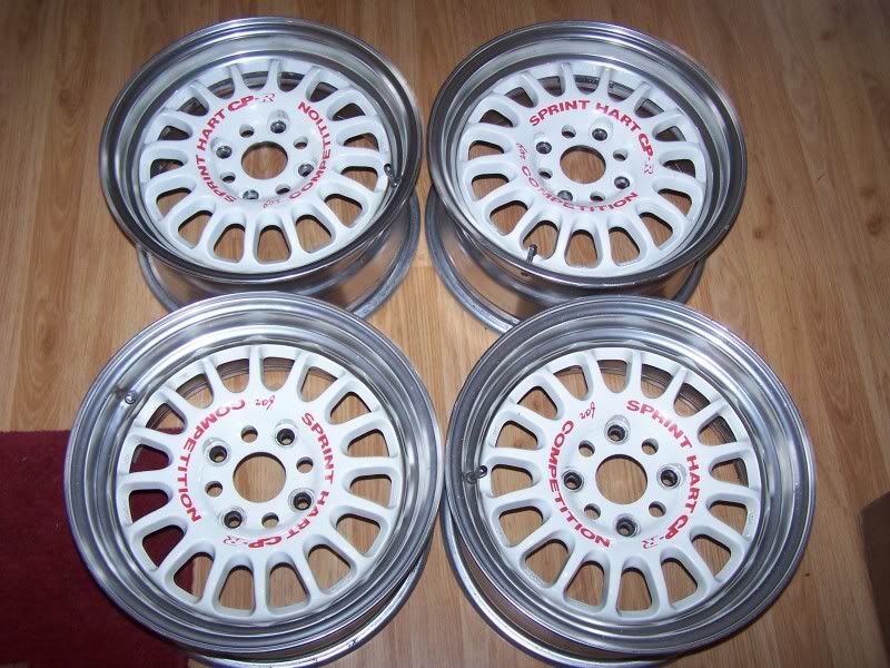

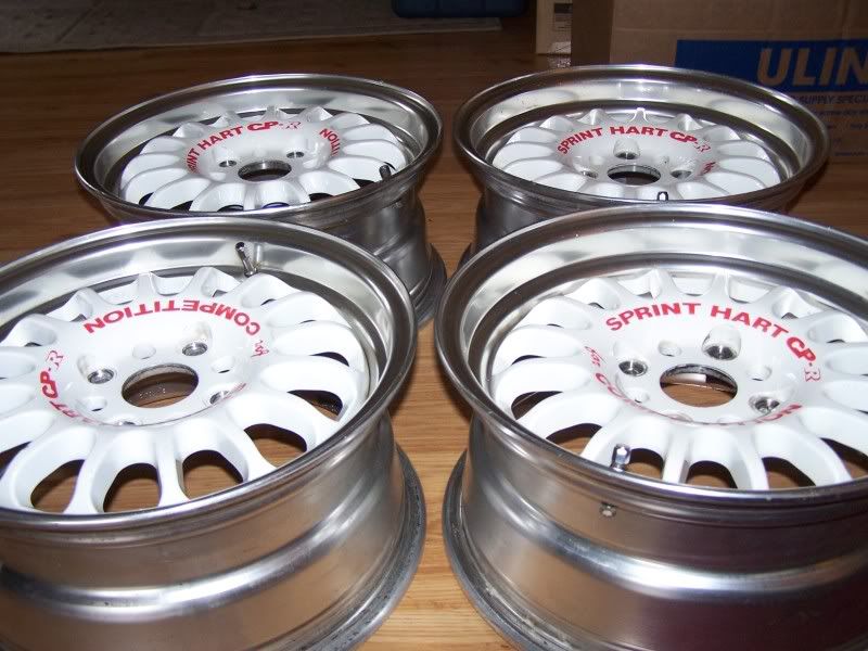

While parting out my old EF i managed to aquire a complete 4x114.3 type R conversion along with my favorite wheels of all time, a set of Sprint Hart CPR's
sizing:
15x7 +38 (front) 15x7 +22 (rear)

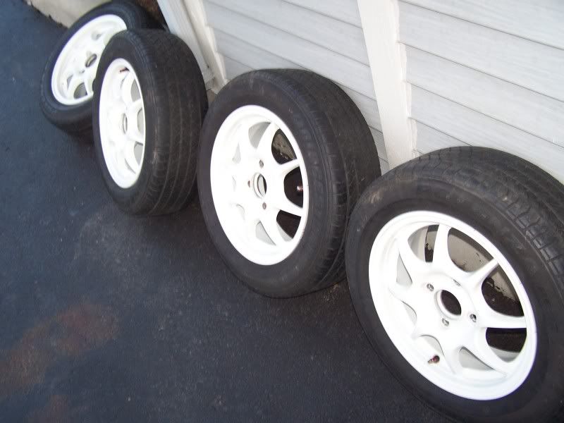

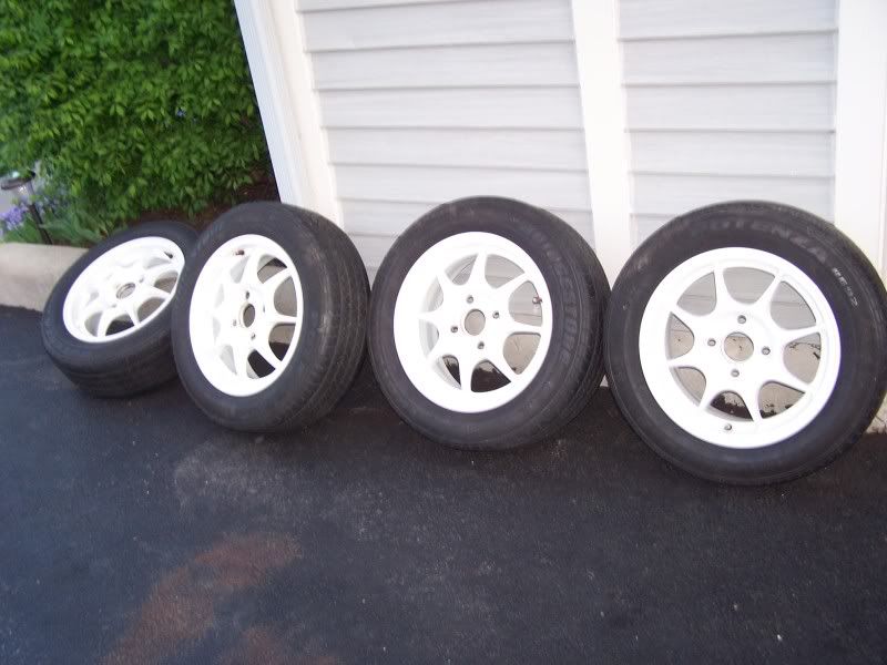

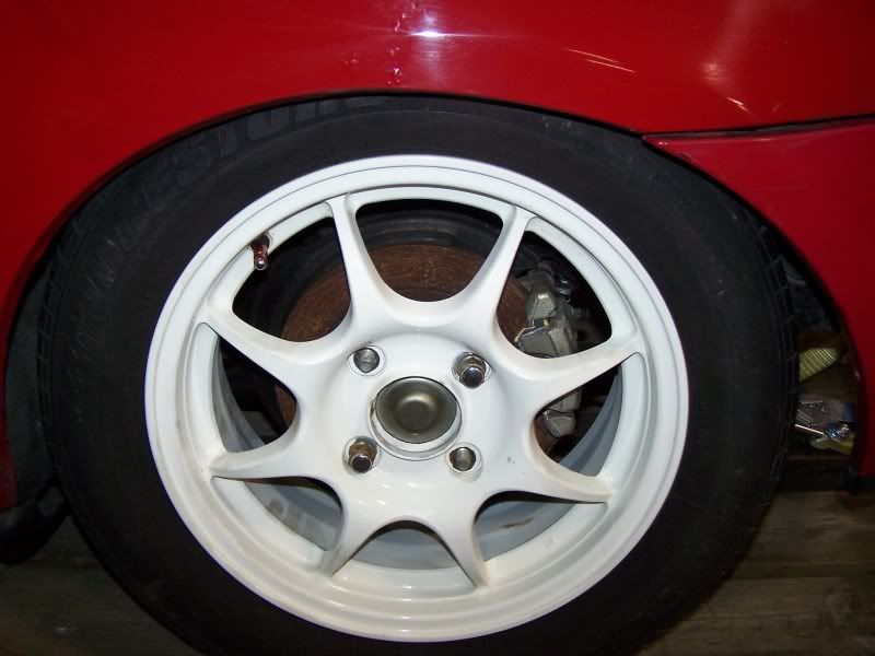

i also ended up comin across a set of 4lug White ITR wheels

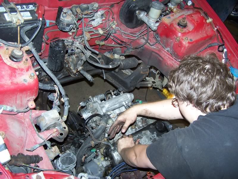

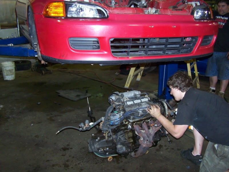

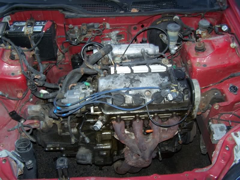

I started working on pulling the single cam out on Sunday

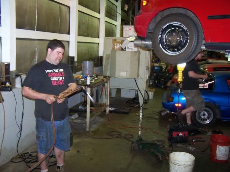

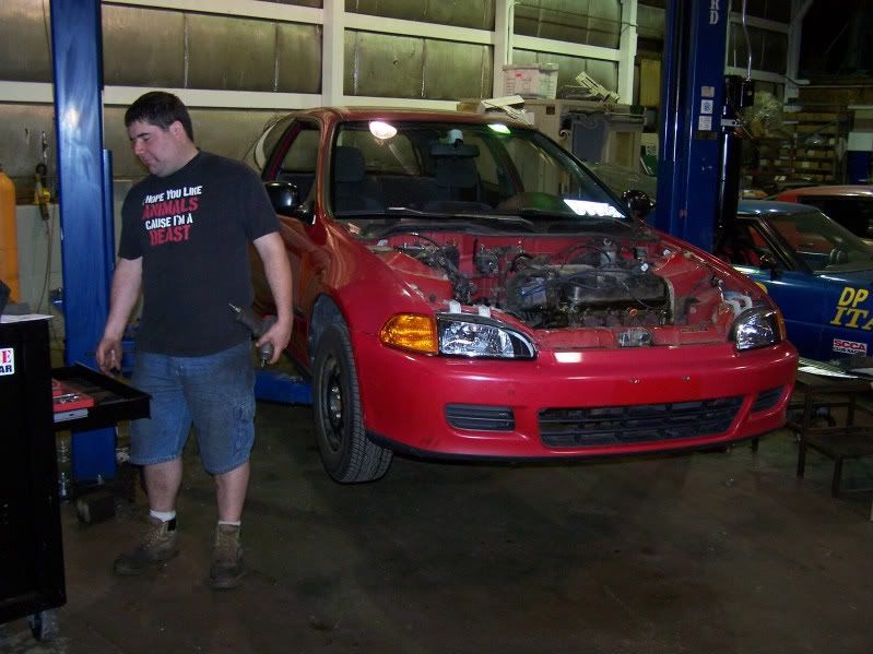

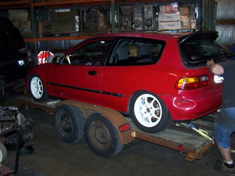

I ended up breaking my Matco 1/2 drive ratchet trying to take the axle nuts off, when my buddy Mike stopped by and asked me why i didnt call him to take the car over to his shop :rolleyes:. He left and came back with his van/trailer, and we towed it over to his shop sunday night at 7pm
car loaded with parts

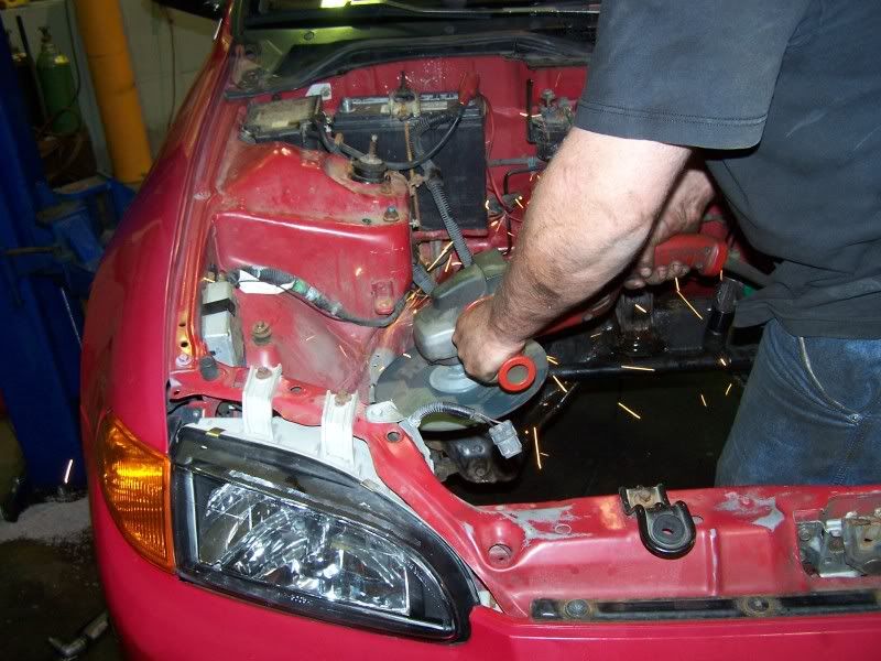

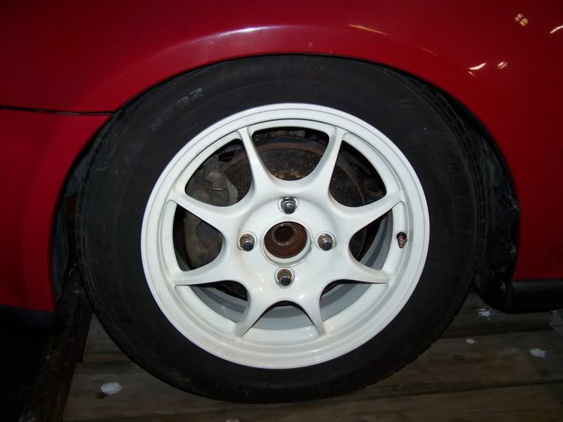

Since there was no way the axle nuts were comin off, we just decided to do the big 4lug at the same time as the swap, especially with having a lift.

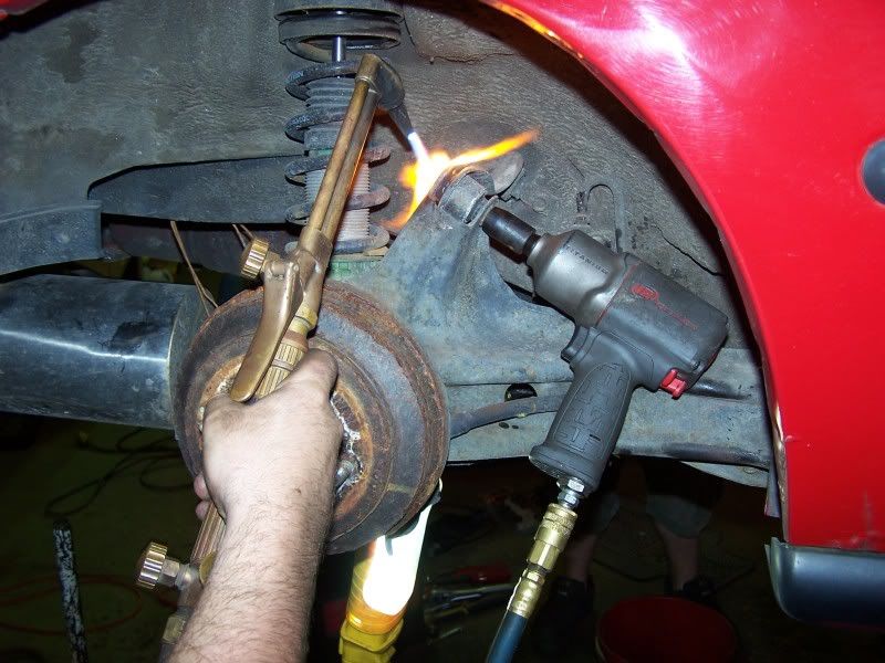

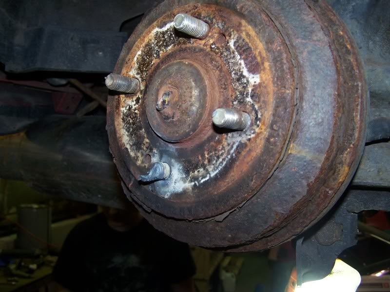

things got better as we started working on it when one of the lug nuts just started spinning the stud with it, thank god we were at the shop and had a torch

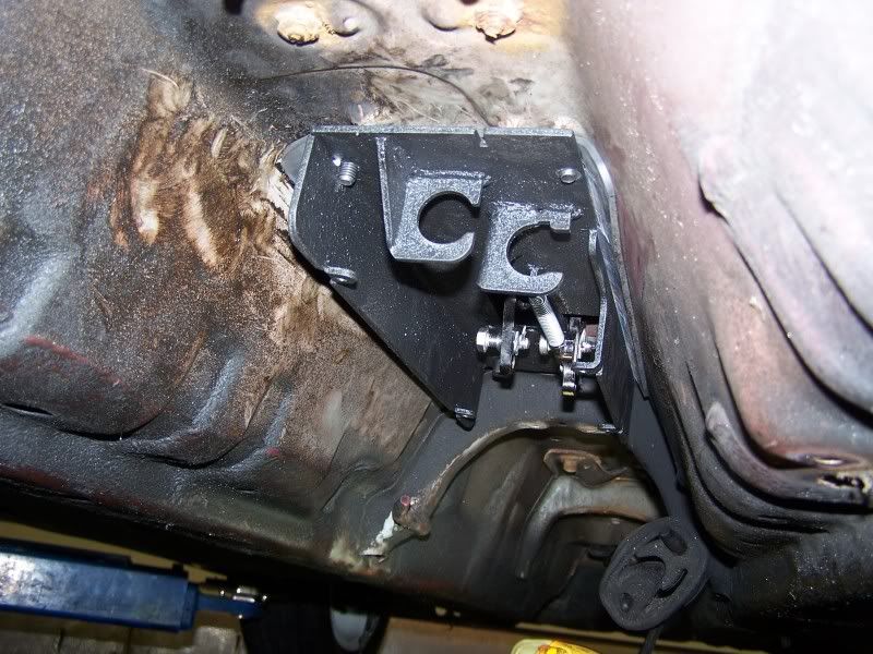

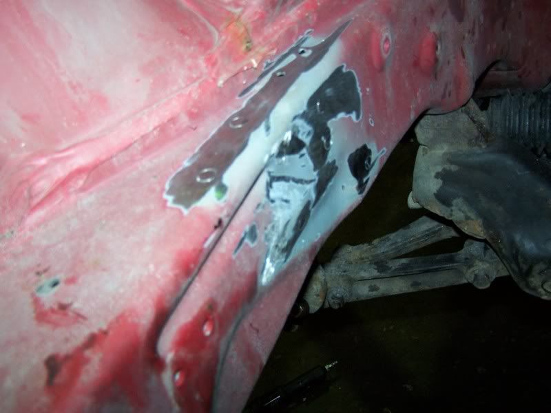

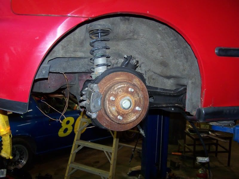

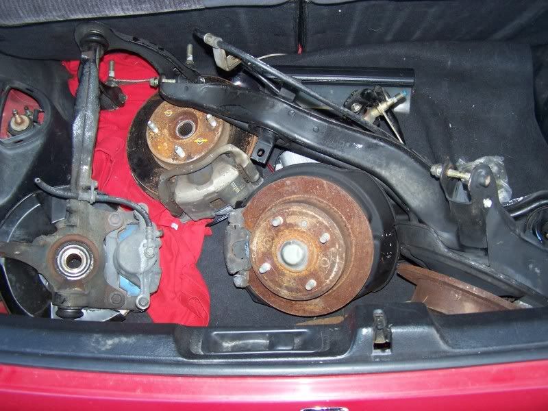

so onward with doing the rear disc conversion, thank god for the torch again

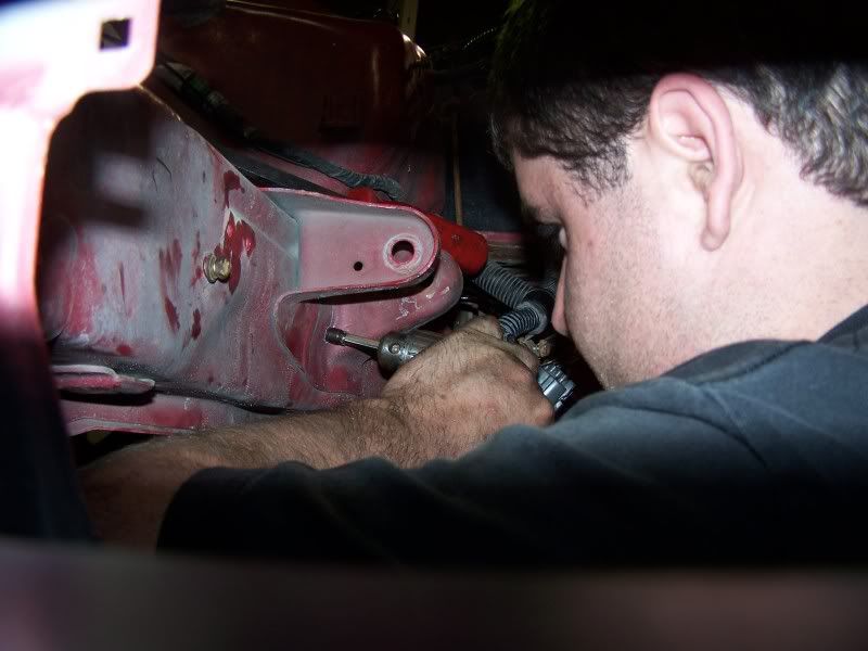

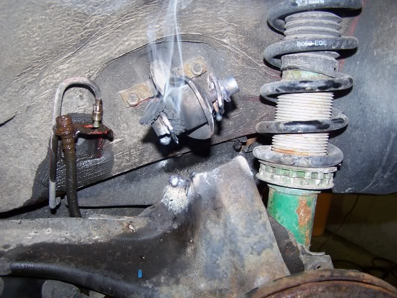

unfortunatly the bushings were seized too so we actually ended up cutting the top ear off the rear trailing arms, again with the torch, and then cut the bushing out, again with the torch.
I have to get a rear camber kit now, just didnt have one at the time cuz i wasnt planning on goin that far, so for now and it to roll i needed the camber arm there.

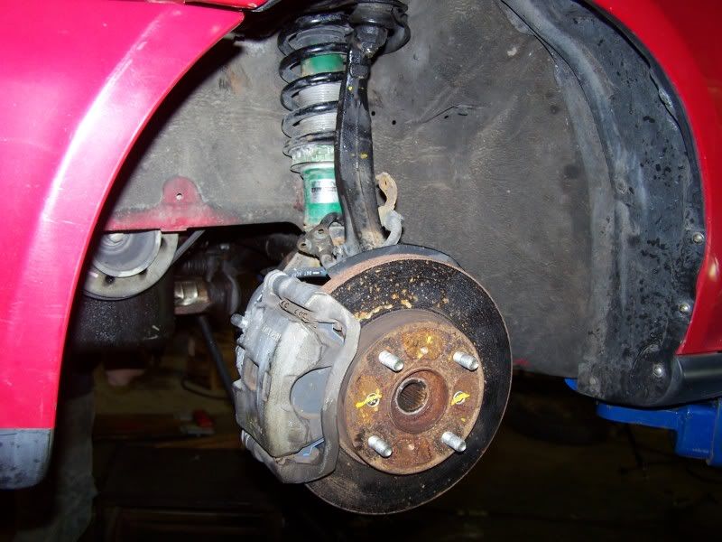

not much excitement up front, just unbolted the stock shit, pulled the axle with it and put the front conversion on

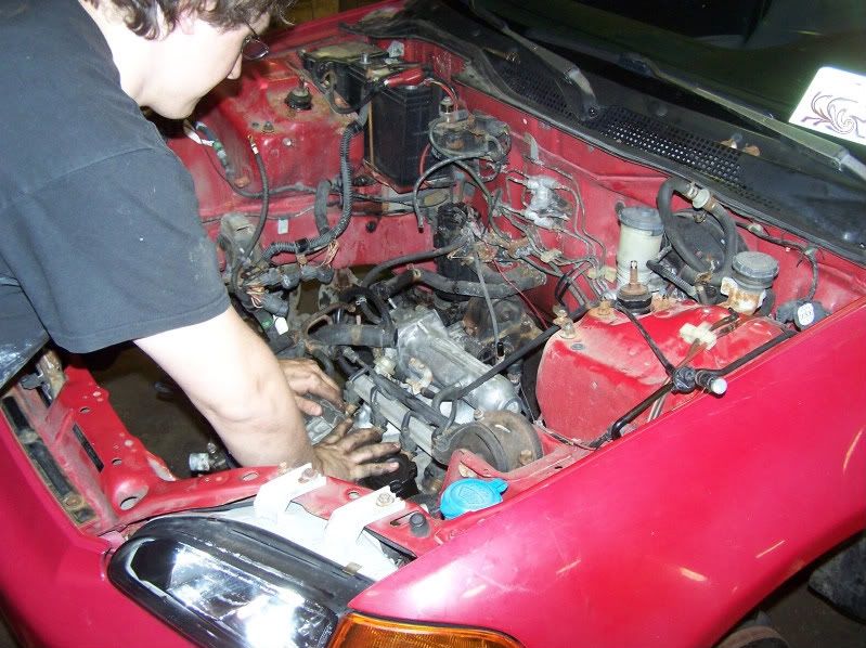

back to pulling the single cam

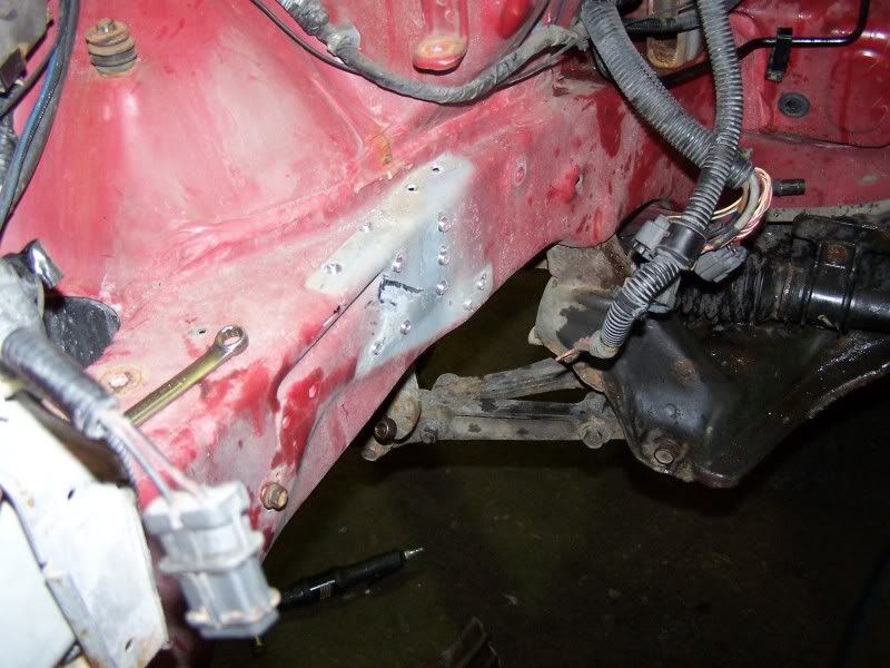

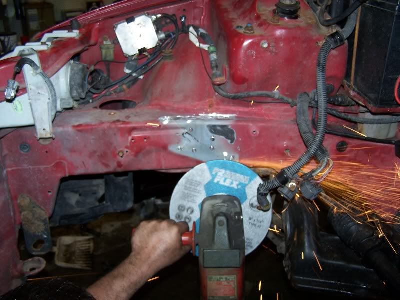

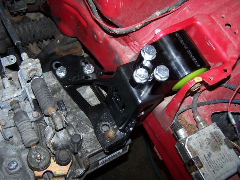

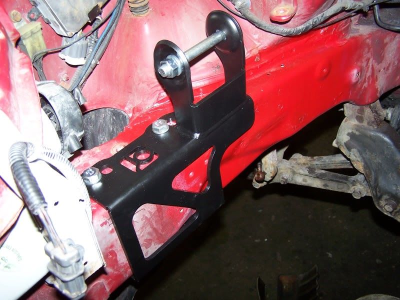

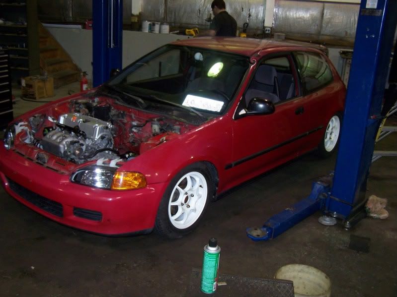

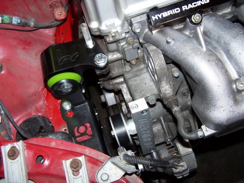

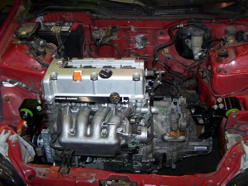

my buddy mike went to town cuttin and griding the passenger mount

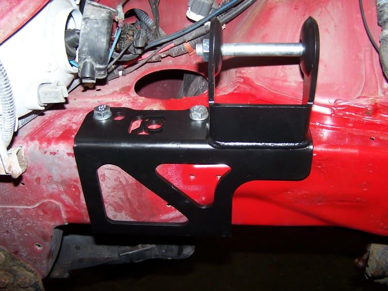

Installing the Passenger side Hybrid mount

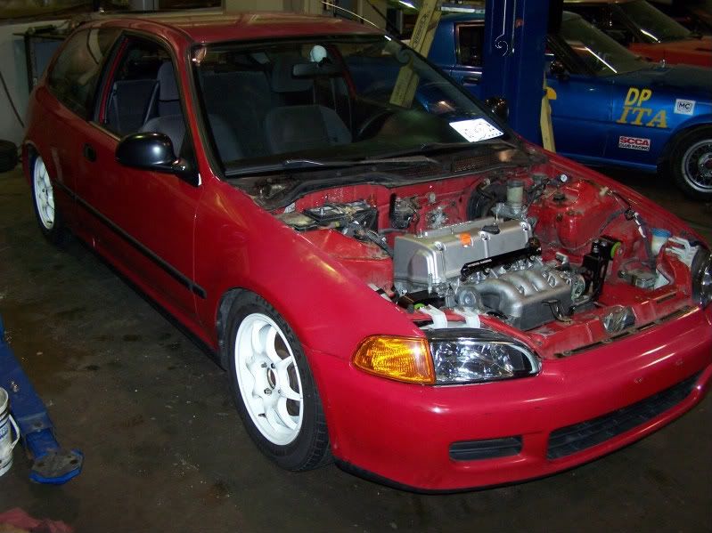

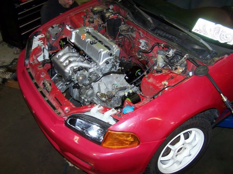

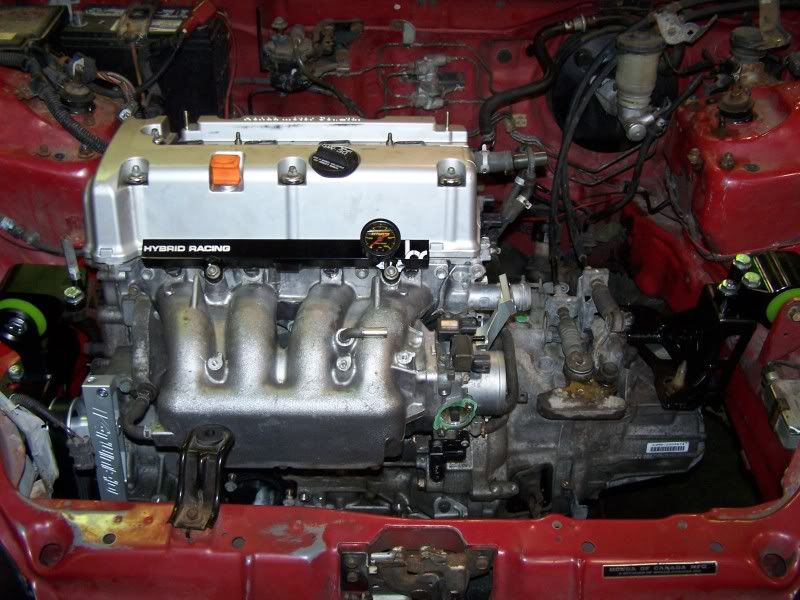

FINALLY! bolting the motor in
put the wheels on and put it on the ground
All loaded back on the trailer and ready to go home at 6am sunday night/monday morning

Man, this is like a speed build! I feel like a turtle at the pace I'm moving at. I've got a few questions. If you're swapping out the old 4 lug, why not go 5? (Yeah, I know you've got a nice collection of 4 lug wheels but besides that).
Also, noticed you placed the engine more forward. Why is that? I thought putting more of the weight behind the axle would have been better.

Holy crap I hadn't even noticed I was using the forward mounting holes. I kept thinking it looked like it was sitting more forward than it should. Dammit gotta change that now. I went big 4lug because I traded my old built B16 from my EF for the Sprint Harts and the big 4lug. Otherwise I would have kept my Koseis and used my front/rear wilwood big brake kits.

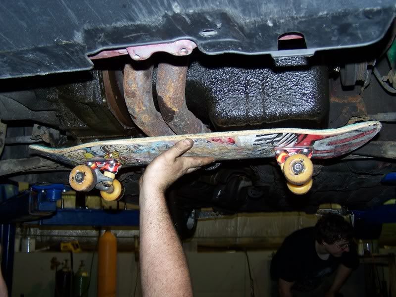

Glad I could help. I noticed you had your passenger side mount on the rear location. And based on the tranny mount, looked like it was originally on the rear spacing as well.
I like how you used the skateboard. Just realized how handy one could come in.
I also feel your pain on the seized trailing arm bolt/bushing. Had the same problem. I ended up drilling into the end of the bolt and then used a tap to clean up the threads on the welded nut. I had actually popped that nut out before on another trailing arm with seized bushing as it somehow pushed the nut out.
#21 ·
Hell yea dude the skateboard makes moving engines very easy, only gotta lift it up a minimal amount.
Yea those bushings suck, thank god I didnt care and just hacked everything with a torch :p that shit was fun.

I used a grinder. That was fun. I don't have a torch. :( Should have tried to save the trailing arm though!

I took Weds off work and again drove down to winners circle and bought all my fuel line and fittings, now I just need to assemble it all and route the line. went and got two new radiator cushions from Honda since my original ones were hard as rocks. Picked up a pair of axles from Advance Auto Parts and swapped the inner joints. I also corrected the positioning of my motor (doh!)

So what holes did you end up using for the engine position? I am using basically the same mounts. I will also be using modded stock axles as well. I think the placement of the engine in regards to those bolt holes on the driver and passenger side mount has something to do with what type of axles you use.
#30 ·
thanks. In regards to mount position and modified stock axles, you want to use the rearward mounting points of the Hybrid mounts. That would translate to the Forward trans mount, and rearward passenger and rear mount.
You would want to use the Forward mounting position if you're using DSS 2.9's and higher, due to the overall longer length of the axle so as to prevent driveshaft bind up on turning. the forward mounting point give them a bit more room to rotate

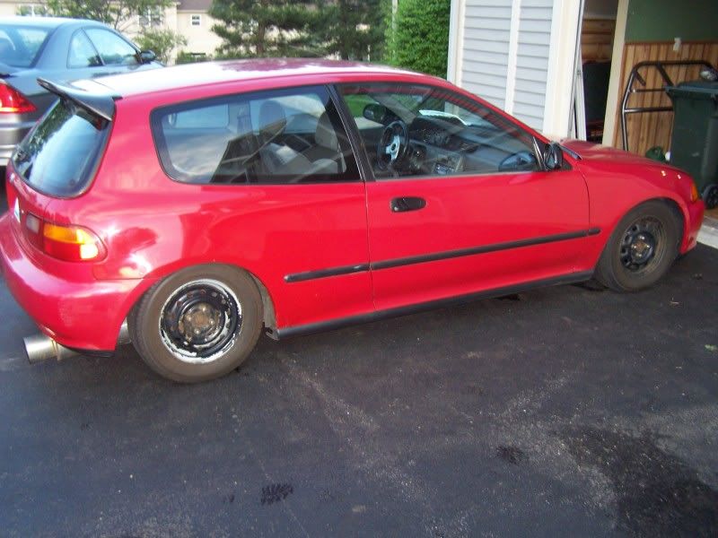

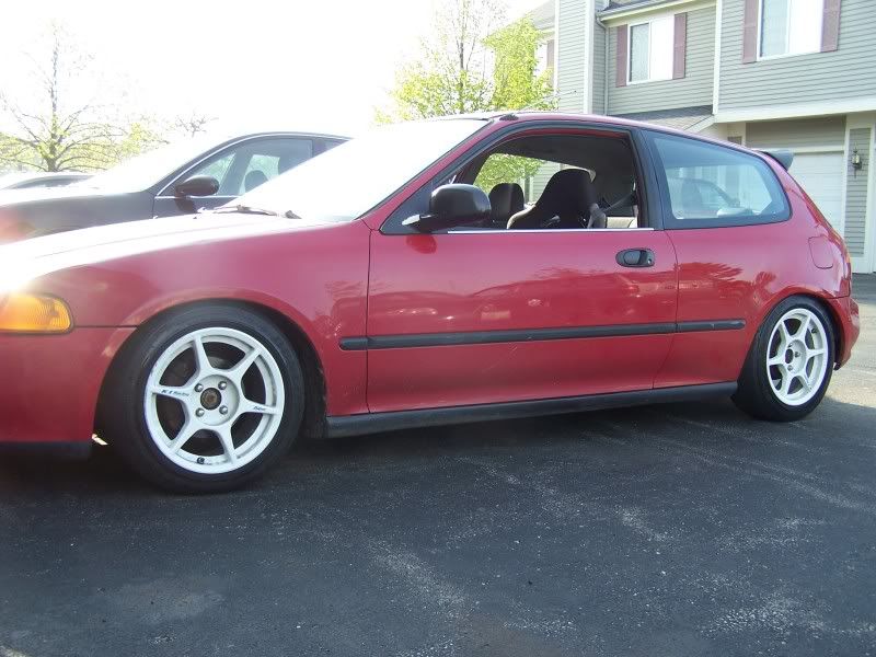

ok so i completely failed at keeping this thread updated... my life got pretty crazy for a while here and the car was put on the backburner for a bit until i couldnt stand it and pretty much finished everything in a couple day. my camera broke so i finally was able to snap a few pics of the car now
-3deg of camber for the rear to fit flush
MONEY SHOT!!
Yea the Engine bay is dirty as hell but i'm not worried about it for now, i'm just enjoying driving the car. when i have the car repainted (hopefully over winter) i'll worry about makin it look great then
