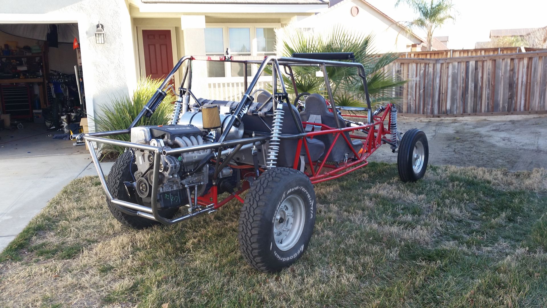

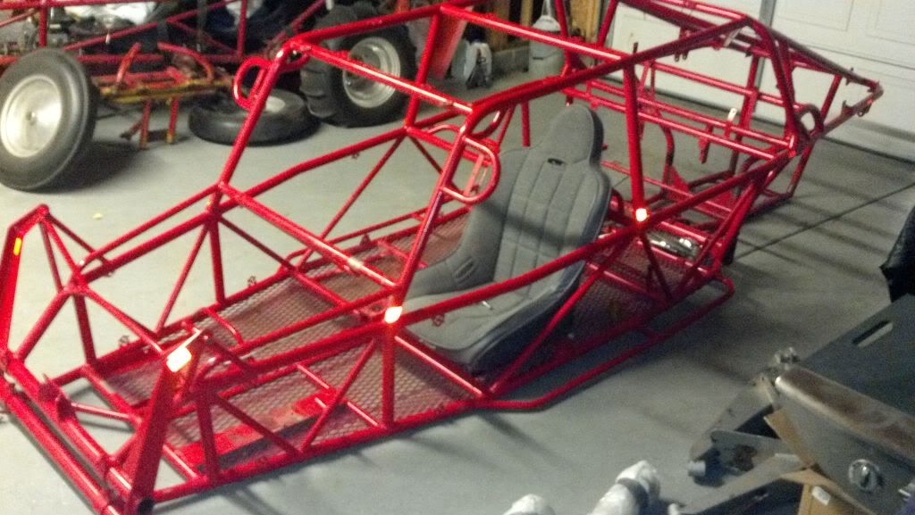

The engine will be paired with a old school vw bus trans (absolutely no sensors or electronics).here is a pick of the Buggy and trans, the motor should be here in about a week.

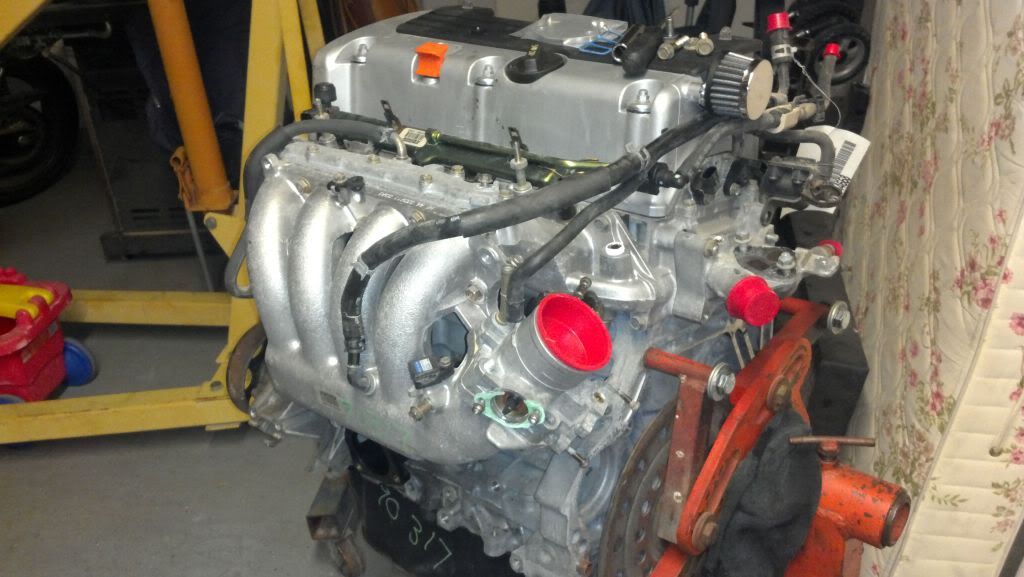

Here is my motor,I am in th process of removing all that is unnecessary for my application. It will be completely visible once in the Buggy so I would like it to look simple and clean.

I know you can get rid of the IACV and Evap Purge System. But I know you need that TPS (the one removed on the TB in the picture). There may be a few other sensors that can be deleted but I think you need them all.

I have a new tps coming, the original broke before I got the motor.I'm got rid of the iacv then pulled the hard lines and plugged them on the tb,I bought the egr plate but them decided to build my own water neck/egr piece with outlet coolant line only.similar to the k tuned one.I will eventual pull all hard lines/nipples and put an fittings in there place.lots to do on the list just a matter of getting time. I will be using the vw bus trans still, and am in contact with a somewhat local guy who runs k series motors in his buggies and built the adapter kit for this motor to trans combo.he also told me he has an Offroad tune they use, but I will trailer it to a dyno/tuner for the best results.

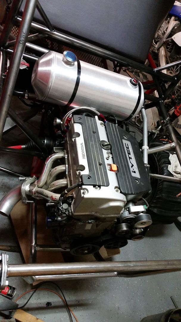

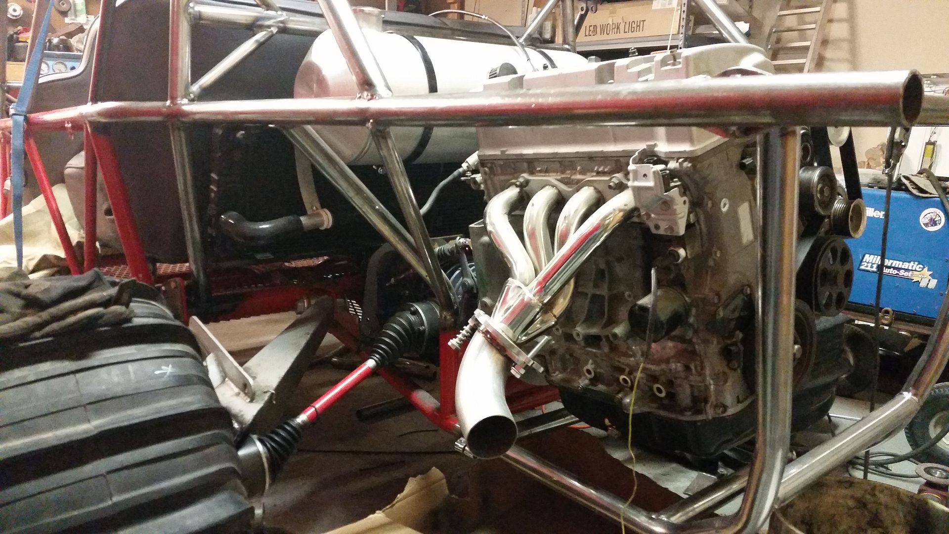

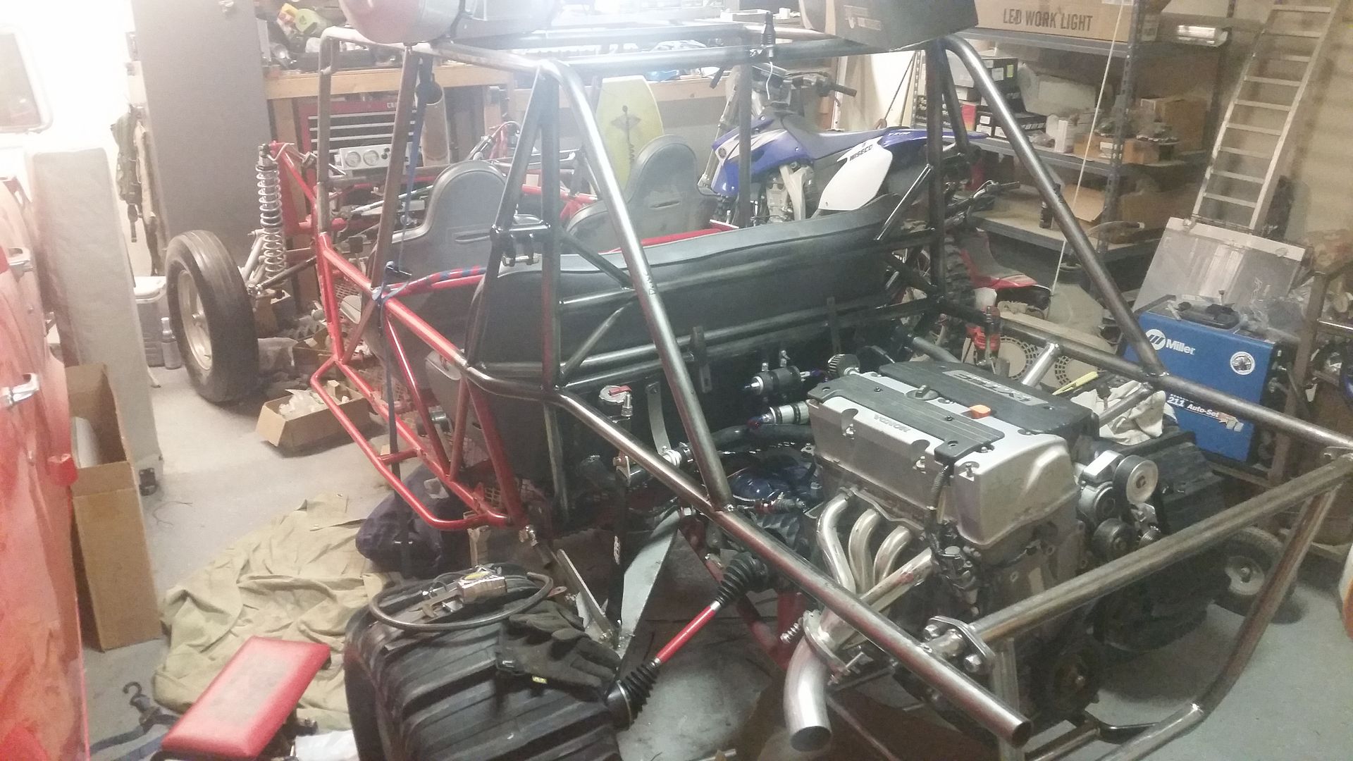

I followed hondata's wiring and eliminated the o2 sensor/heater relays and moved altL(blue/white) from connector b (iirc) to a indicator bulb directly. I kept the 03 rsx-s harness intact with the exception of the ckp connector,freeing up the ect connector to reach the ect sensor, and ridding all the plastic extras. Fuel system is in place and will hopefully finish up my switches/dash tomorrow and start it for the first time.
