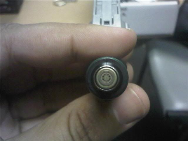

Wassup Folks...
Once again... i have found something New !!
This is a EVO X (10 ) Stock injectors ( BOSCH ) that are 600cc:silly: / High Impidience..
I already found clips from a toyota.... but going to make sure what yr it is before i Post...... some nissan have clips that will fit also!!
ENJOY............:wow::wow::cool:
Ev14 INJECTORS THAT COME FACTORY IN THE EVO'S
I just Finished putting them in... works perfect:up:
All i did..was change the Lower O-rings from the evo X to Type s.. cause the Type S was Bigger !!
The Clips i used was from a Lexus SC300....1993-1998 !!!
#12 ·
putting them in next weeek.... but already Test fitted them!!
Not sure how much they sell for... but i got them for a steal > Lets just say that !!
#32 ·
