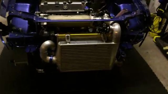

Add this into the mix and things get interesting ;)
Add these things get more interesting :)

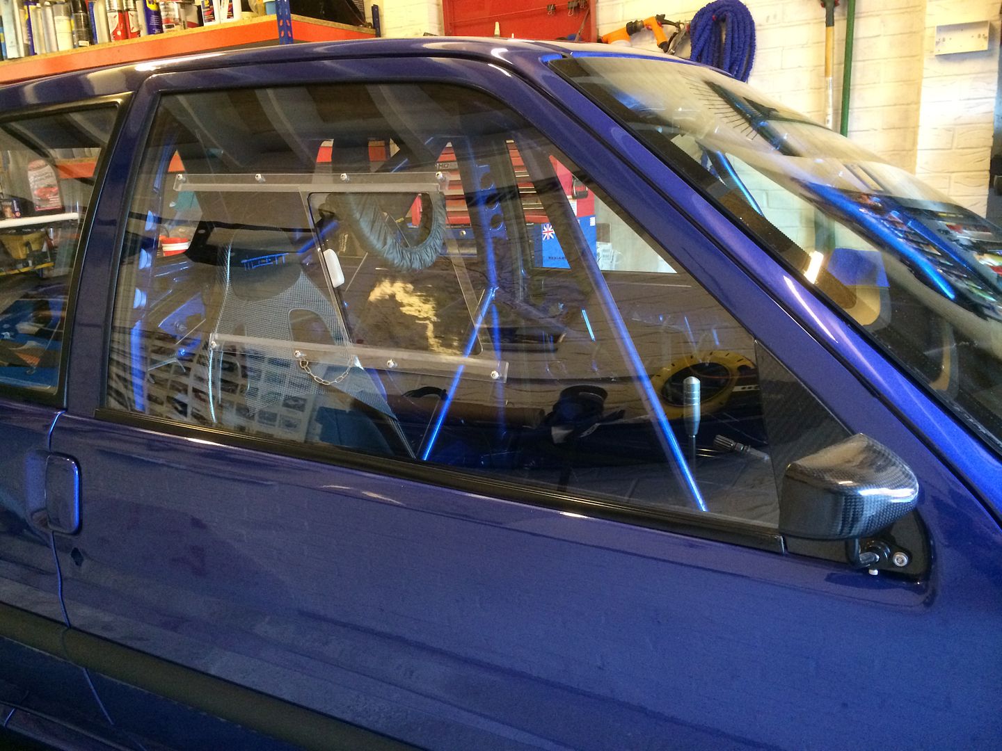

Managed to get one window in before I went to work.

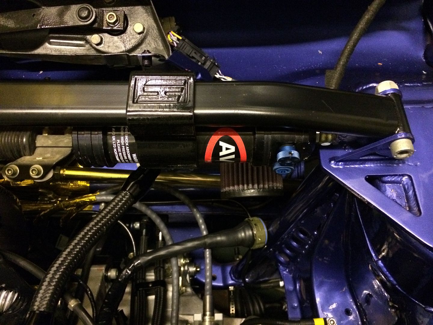

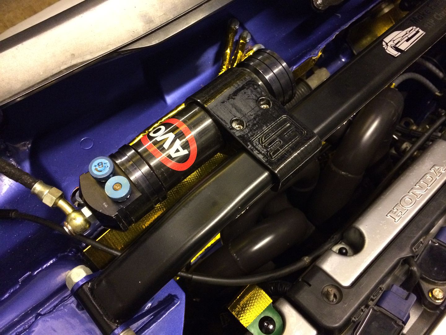

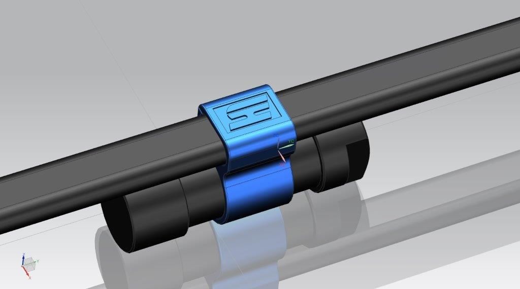

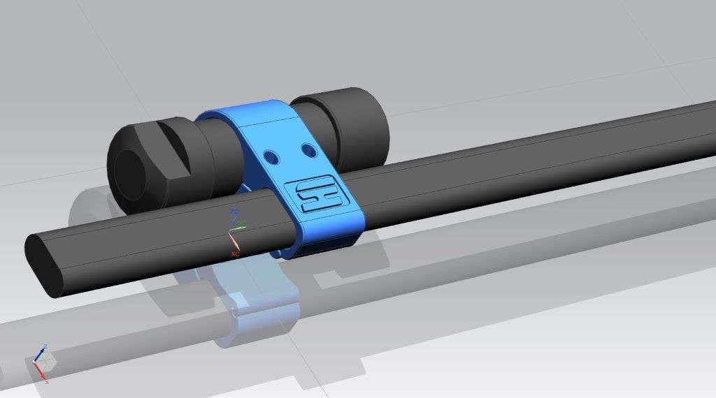

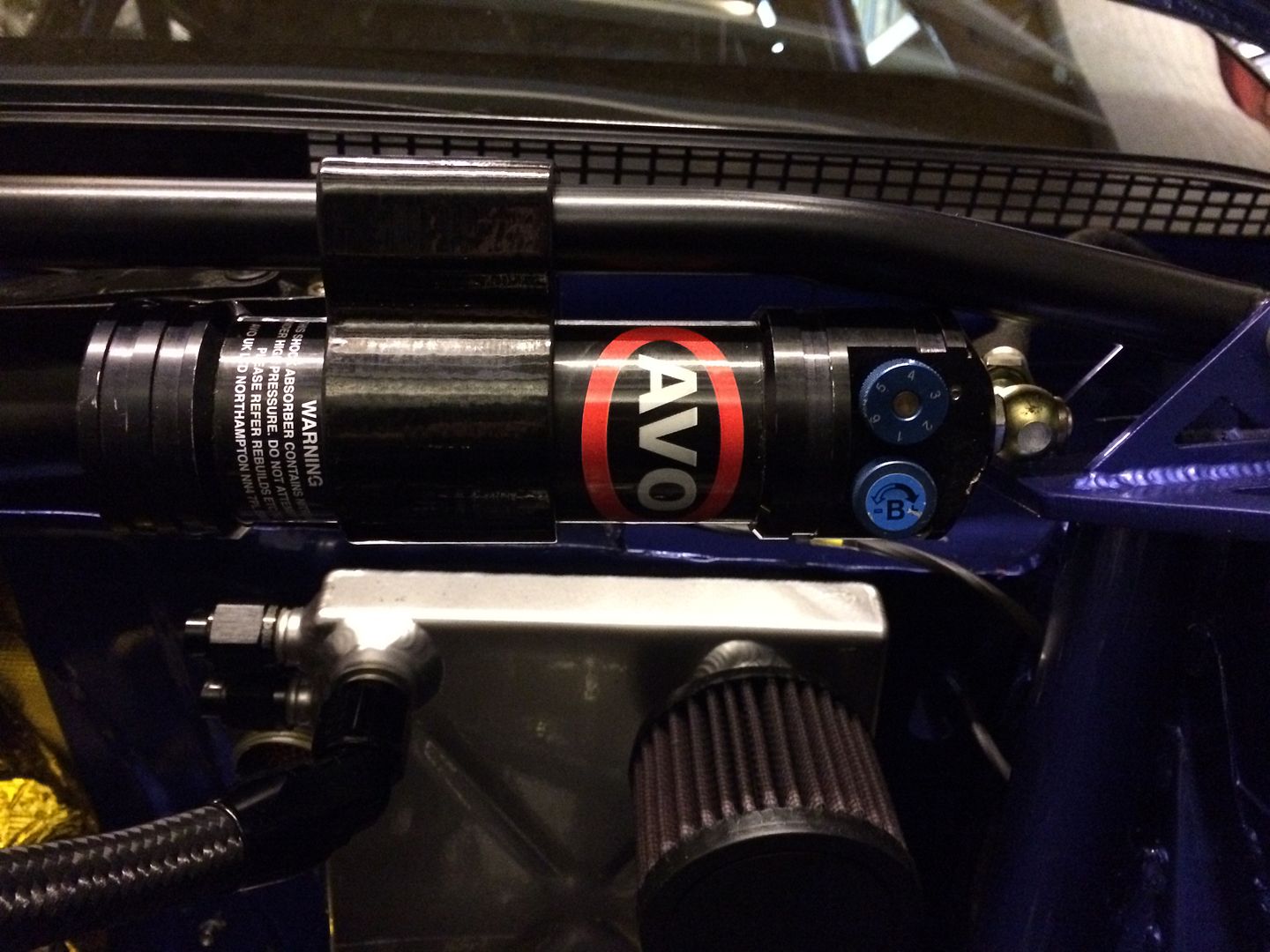

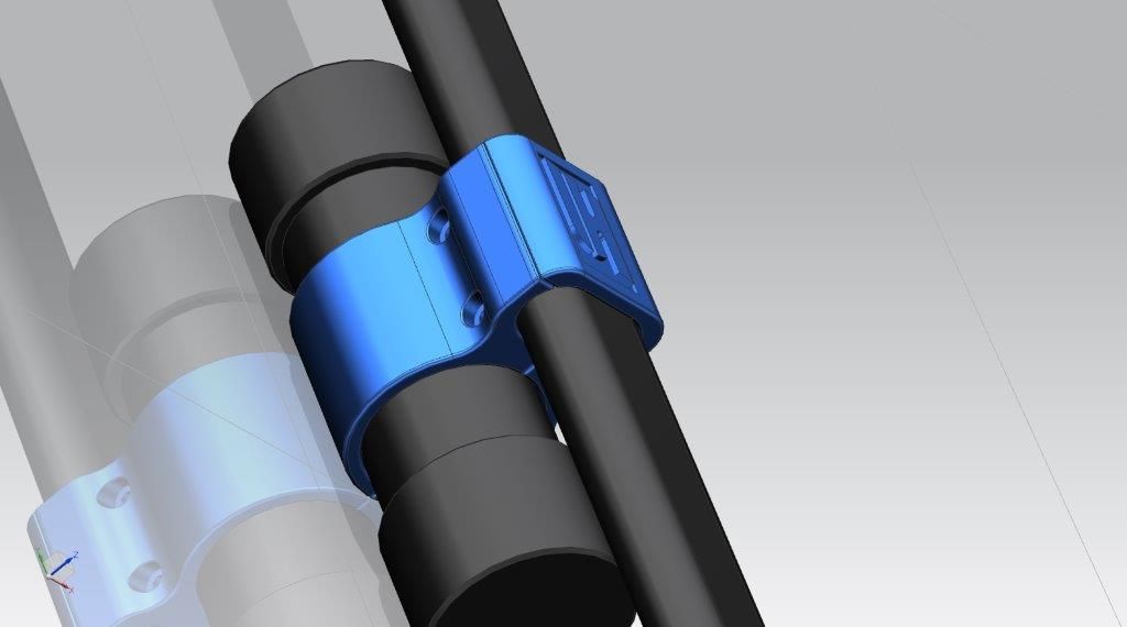

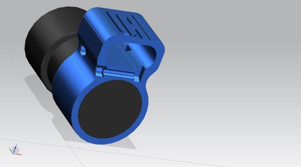

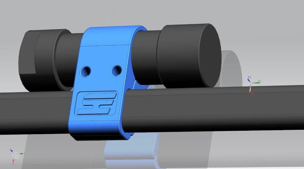

My friends at Satchell engineering have helped me design some fancy reservoir brackets.. These will be 3D printed.

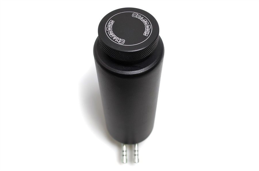

Also bought a chase bays overflow tank

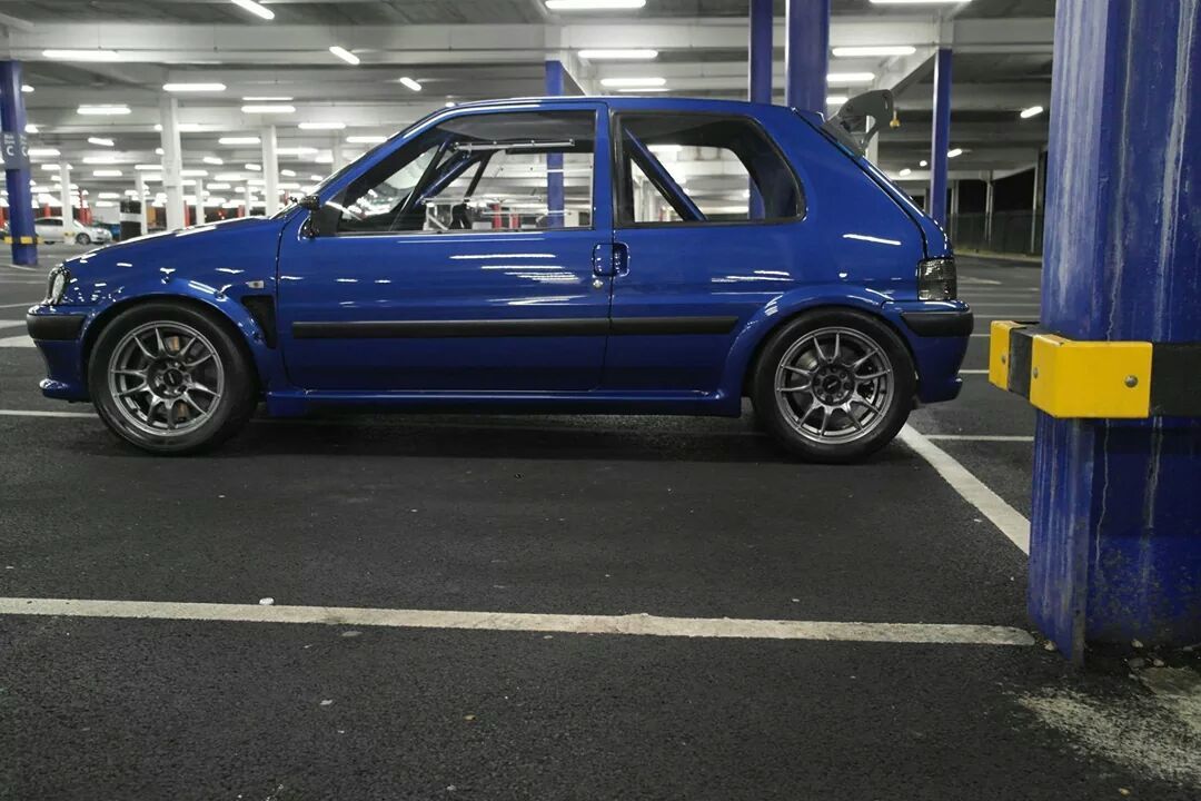

We'll the car is Running! And it's fully road legal now.
Yesterday I got the car tuned by Romain Levesque and he did a great job.
I ran into a few small problems but nothing major..
It seems that plumbing my external wastegate in the way it's suggested in the Jaydee thread doesn't work too well for me. It seems to fluctuate boost as it's opening and closing.. So my new plan is to turn the wastegate around and plumb it in the 'conventional' way, might lose a couple of psi in my lowest setting but at least it will work. Maybe if I had closed loop boost control it would work.
Also had a fuel issue, it seems my aeromotive a1000 isn't flowing what it should and fuel pressure doesn't rise anymore after a certain pressure (not sure what pressure)
This issue sort of limiter what we could make in terms of power.
Positives are that at full tilt it's making 1.35bar which means my intercooler setup is working well and the potential to make power is there.
In the end it made 280lb ft and 380bhp but with quite a lot of wheelspin on the rollers.
As can be expected it feels ballistic on the road! Very very quick car.

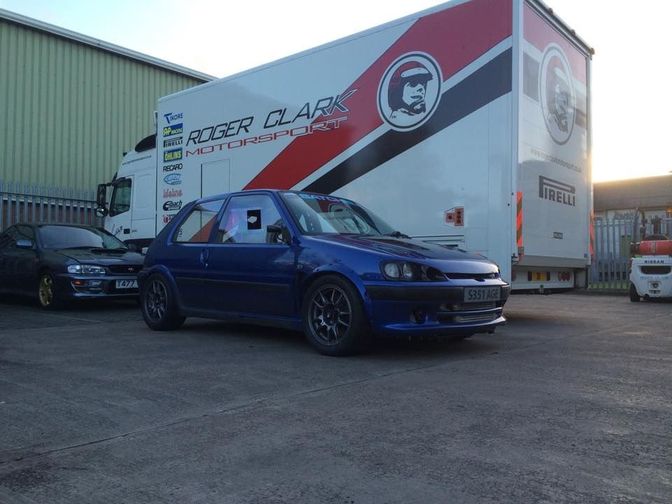

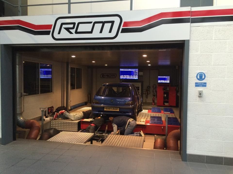

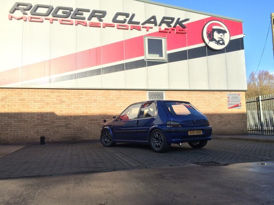

When it was mapped this week it was done by Romain Levesque and he did a great job and really is a nice guy.. A pleasure to work with.
I was fortunate enough to have it mapped at the infamous Roger Clark Motorsport! This place is phenomenal and the workshop is cleaner than my kitchen not to mention the championship winning UK time attack cars so it was a very cool day.. Here's a couple of pics
