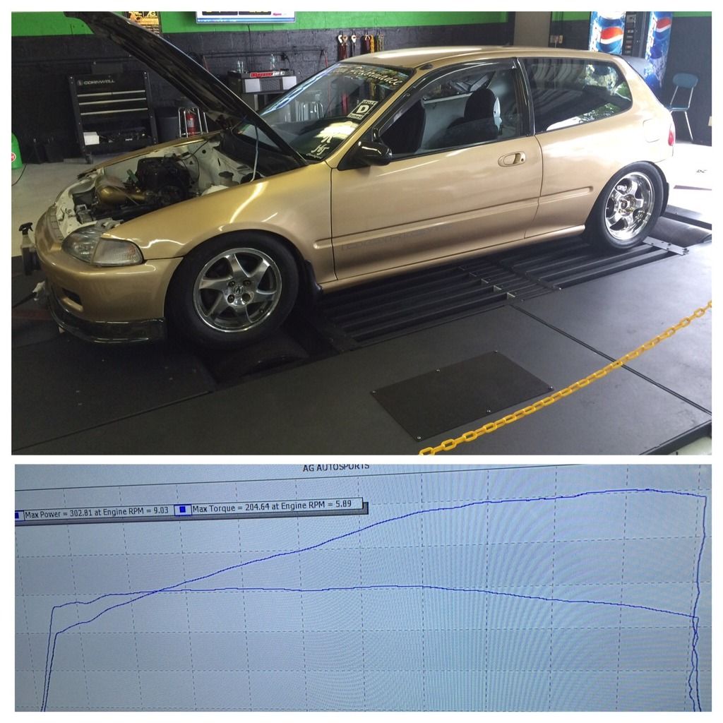

they say 48mm but i'm assuming they used 1.875" piping in 16 gauge or so. That turns out to about .0625 wall thickness, which makes it 1.75" inner. Aka, they're not doing anything ground breaking here, that's a proper size for a big motor. So it should work well. with 1.75 ID and the near 3" exit as long as it's stepped in the right spots :D
and judging from that built motor picking up 8 whp with it i'd say it works well.

#30 ·
Its an 06 k24a2 with 12.5:1 supertech pistons, stock tsx rods, rrc port matched to skunk2 70mm tb, hr swap intake, type s oil pump, 50 degree vtc, 06 stock tsx cams, ktuned big tube header, 3" mandrel bent exhaust, 3" vibrant ultra quiet resonator, 3" magnaflow straight through muffler, modified oem injectors flowing 500cc. All on pump 93
