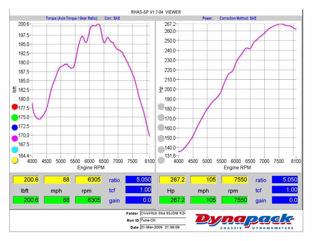

wassup folks..
As u all know... i had a setup a while back.. in k24a2/k20head in a ek hatch (Sold now) >> made 250hp to the wheel.
i been out of the game for a while..and i want to know if anyone is making more on a Stock k24a2 block with a k20 head these days..(has to be stock Block) > List other mods...cam's,intake,porting....etc..
Post Dyno sheets...
Here is mine
-k20 head > Ips kme's cams
-Rcrew headers..1st gen
-Rdx injectors(410)
-Stock Rbc mani
-Stock Tb
