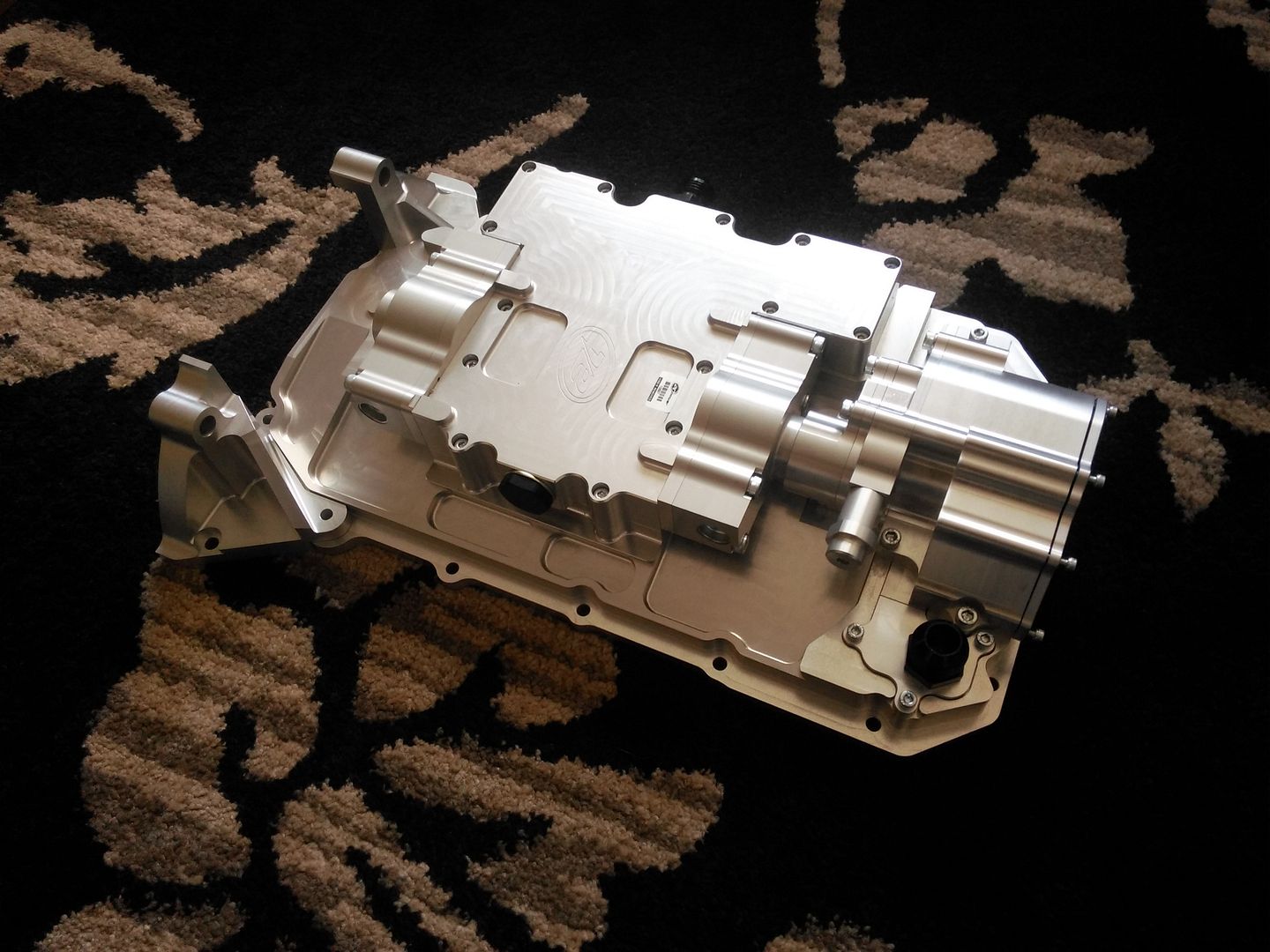

Dry sump arrived, dry sump tank made, dry break couplings bought.. ill be fitting it in a couple of weeks..
I've also purchased a quaife sequential gearbox so looking forward to seeing how that works out.. ill be investing in some proper engine management and closed loop flat shift.. ill put some pictures up over the next few days.

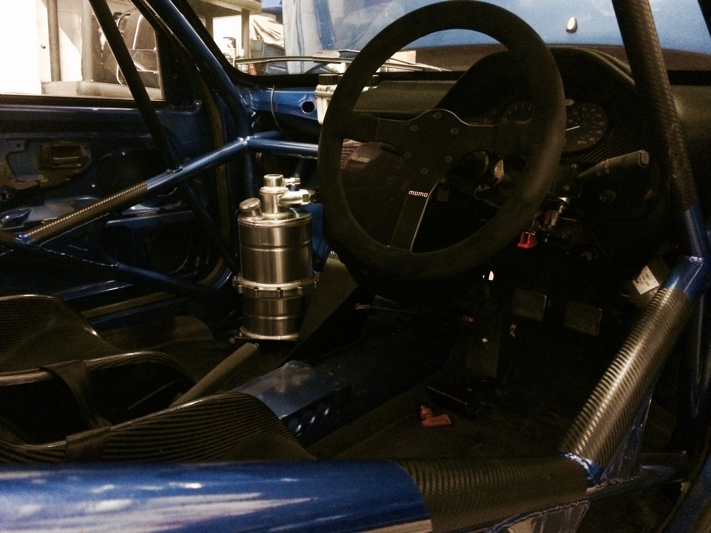

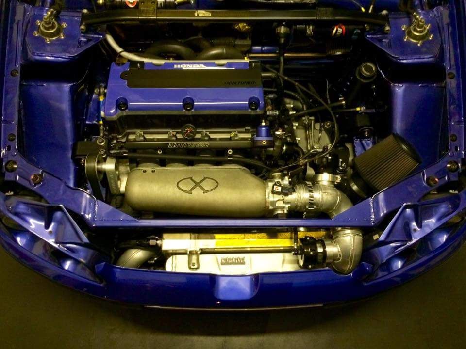

Few picture updates...

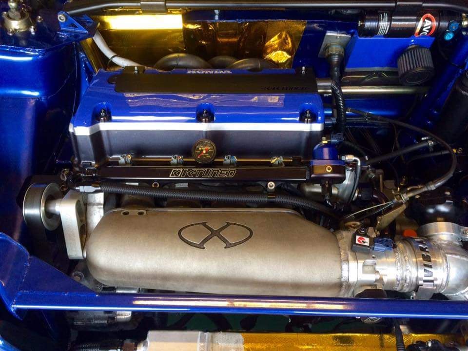

Dry sump installed,gearbox installed, New rocker cover ?
Did a track day :) went pretty well.. honing the car in a little now.

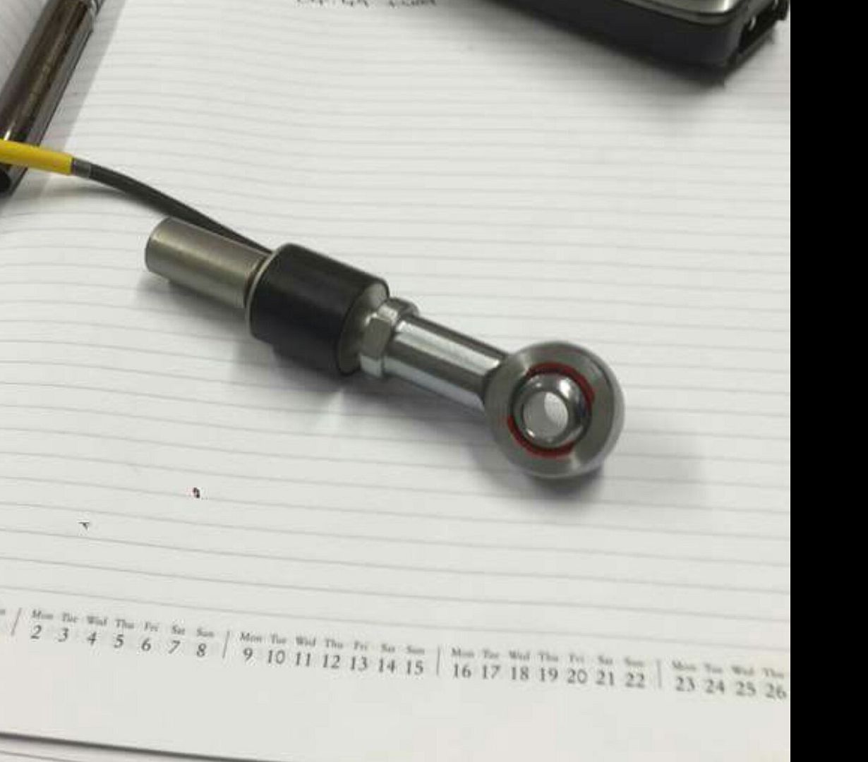

Bought a trick load cell

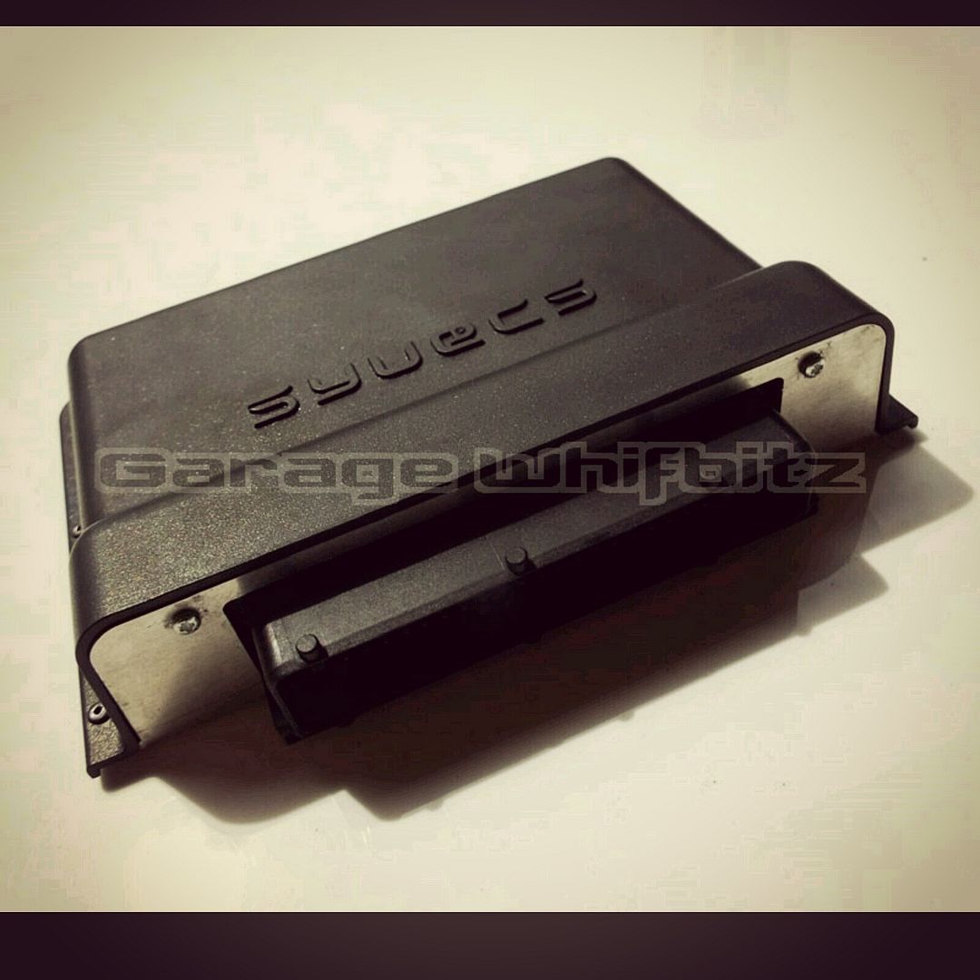

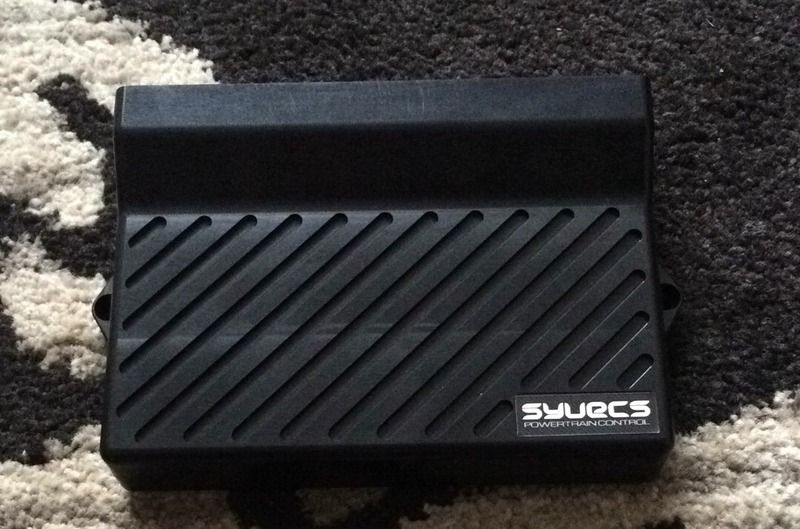

Bought a trick ECU.. syvecs S6gp
Will be mapped and flat shift setup very soon.

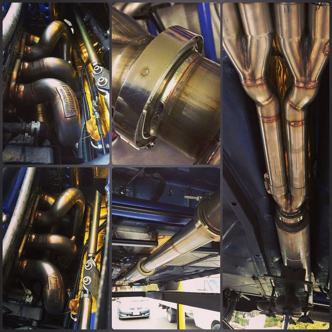

Also, next week the car is going to have a brand new proper exhaust manifold made.. large runners and long primaries/secondarys so looking forward to that.

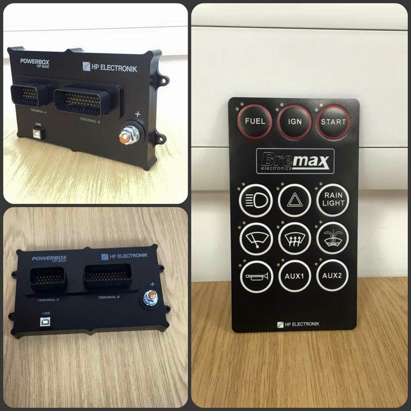

HP electronik PDM and membrane switch panel

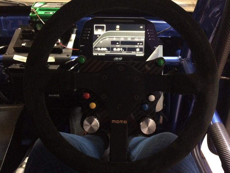

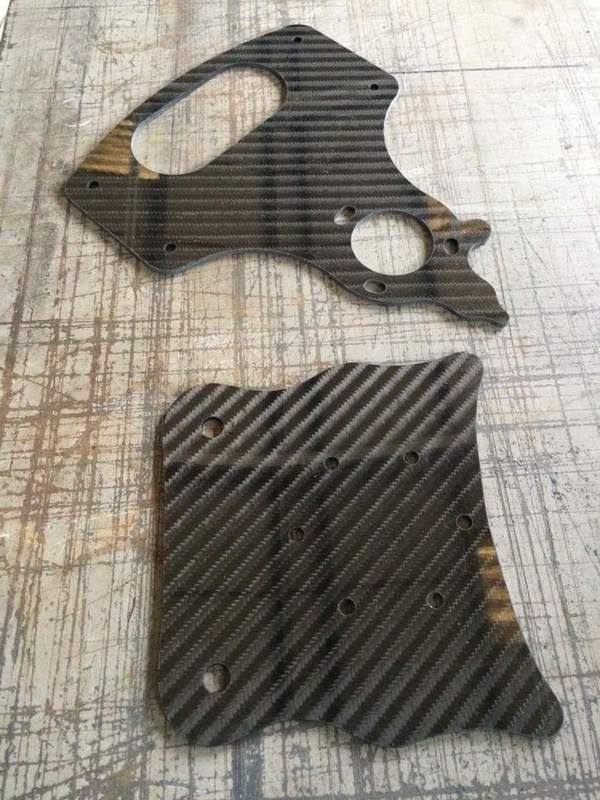

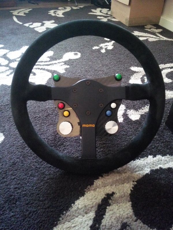

I started to learn CAD so designed some brackets and had the water jet cut out of carbon fibre.
Here's one of the panels with all the buttons mounted.
Silver ones are engine/boost maps whilst the other is traction control.
And now for this beaut! Been really looking forward to getting my hands on this!

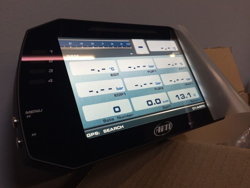

Aim MXG dash logger. It will be used in conjunction with the syvecs Ecu via Can bus.
And some Inconel 718 exhaust bolts.

What CAD software are you using and do you outsource the water jet work?
Also, how easy would it be to get a steering wheel mounted sheet of carbon off you like that (minus the two silver switches at bottom) for my setup?
There is someone on a Caterham forum building wireless controls for steering wheels at less than half the cost of those on the market. I was planning on using it and wanted to mount switches on the steering wheel.
http://forum.wscc.co.uk/forum/index.php/topic/117082-wireless-steering-wheel-buttons/page-7
#348 ·
I'm new into cad so practicing on a few of the more available programs.
I outsourced the carbon profiling to H20 profiling who done a fantastic job and turned the parts around very quickly for me.
Ermm well the fact you have to use high quality auto claved pre prev carbon otherwise the water jetting would just blast the carbon to pieces and Dr laminate things.. the steering wheel backing plate cost me around ÂŁ140
I could get some made I suppose, a few people have asked about them.
