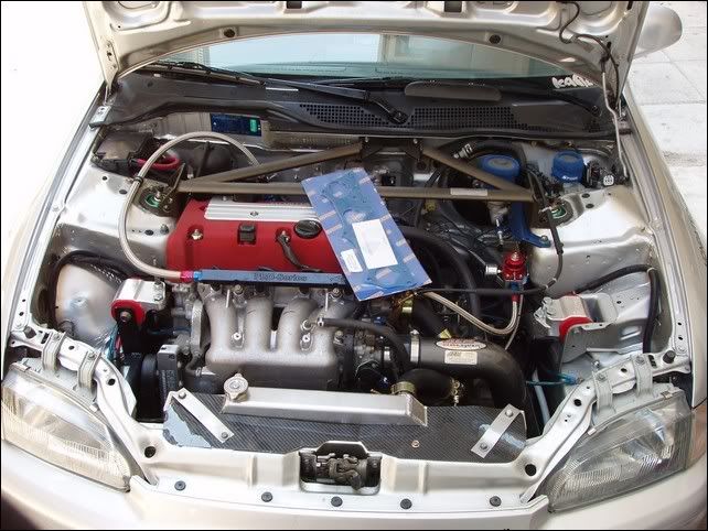

I recently installed a hondata IM gasket...!
Here is a little write up i made for you!

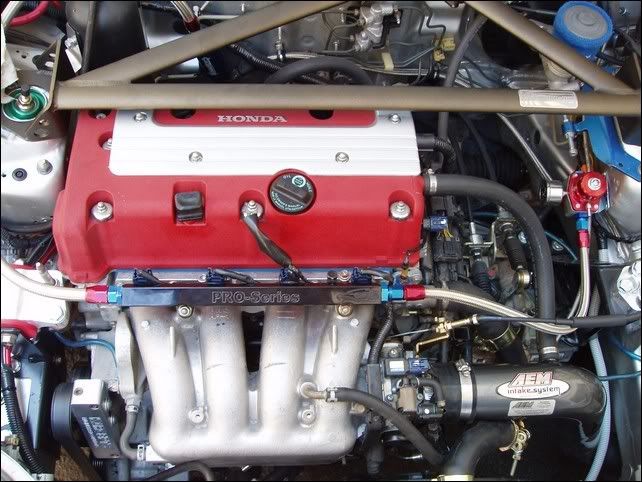

Start by loosening the intake's hose.

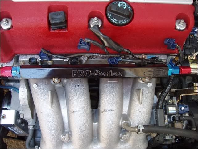

Unclip the injector's plugs, remove the bolts holding the fuelrail and remove the fuelrail as well:

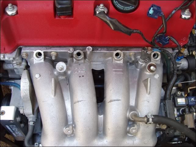

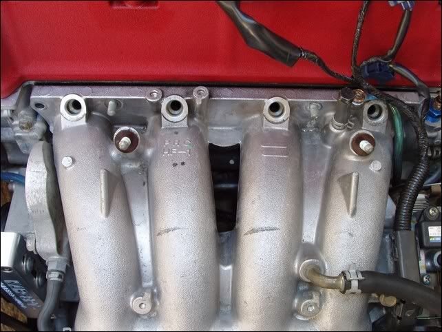

Now unbolt the manifold's bolts and nuts.
You will find two nuts + two bolts on the top of the manifold, and three bolts on the bottom.

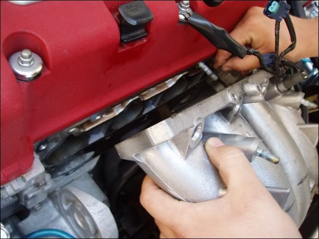

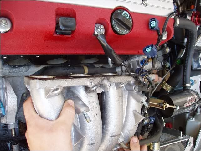

Manifold is slowly coming out.....
..But not for good as it interfere with a bracket located on the left..

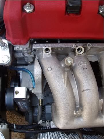

Here is a better look:

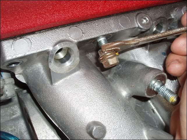

Now, if you unbolt the left manifold's stud, it will make your job a lot easier. To do so, use the clasic "two nut" technique!:silly:

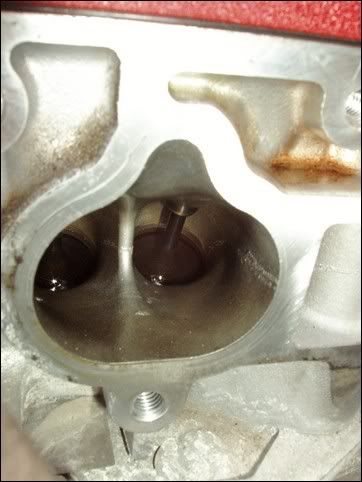

Now take a pic of your valves(!)..:silly::silly::silly:

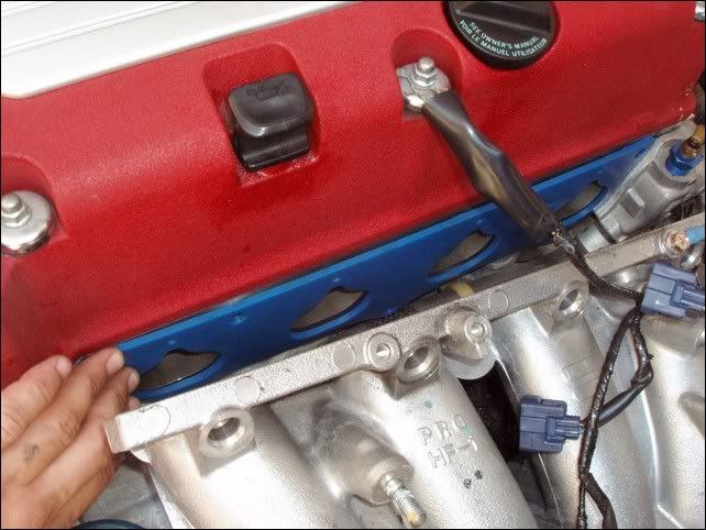

Place the Hondata gasket in place...
