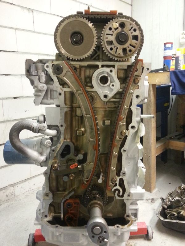

Pic of the engine:

-Carbon synchros

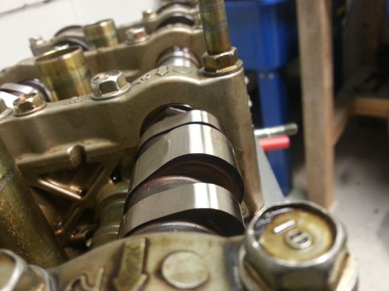

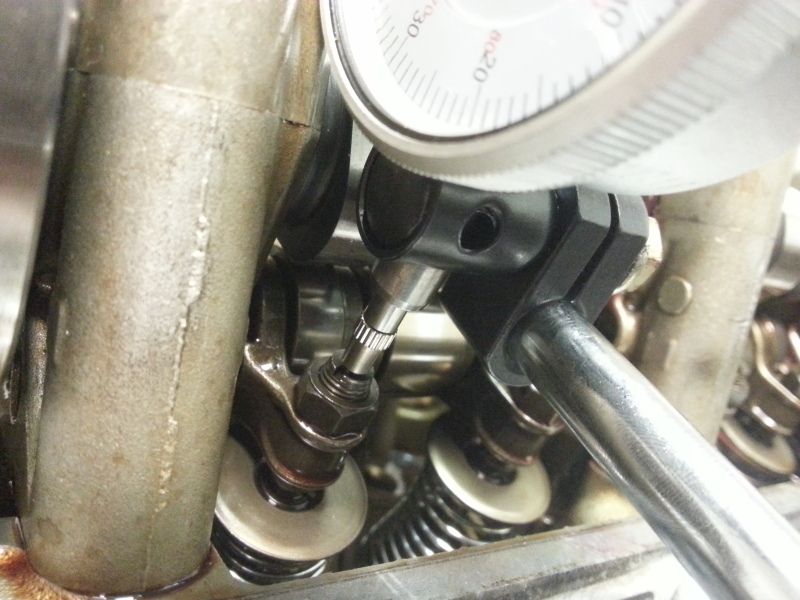

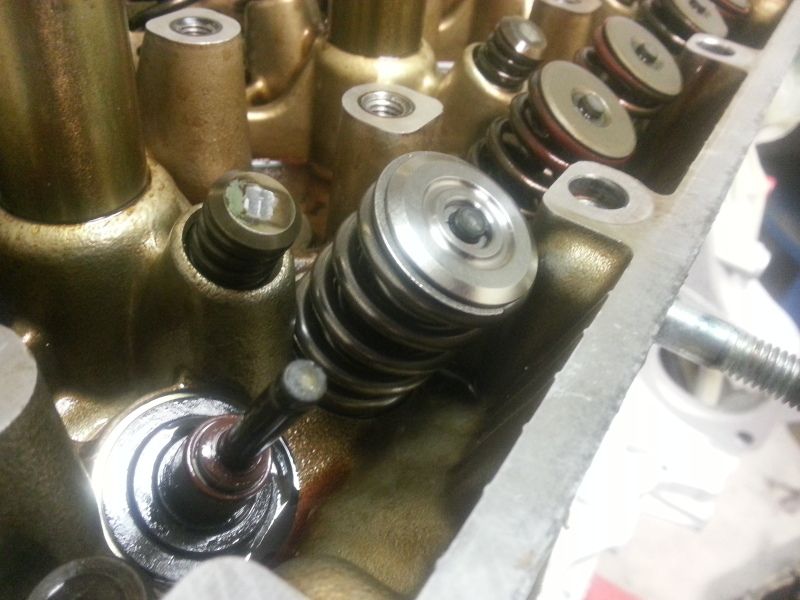

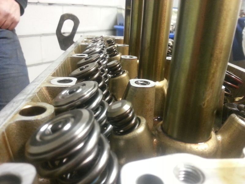

Checking springs:

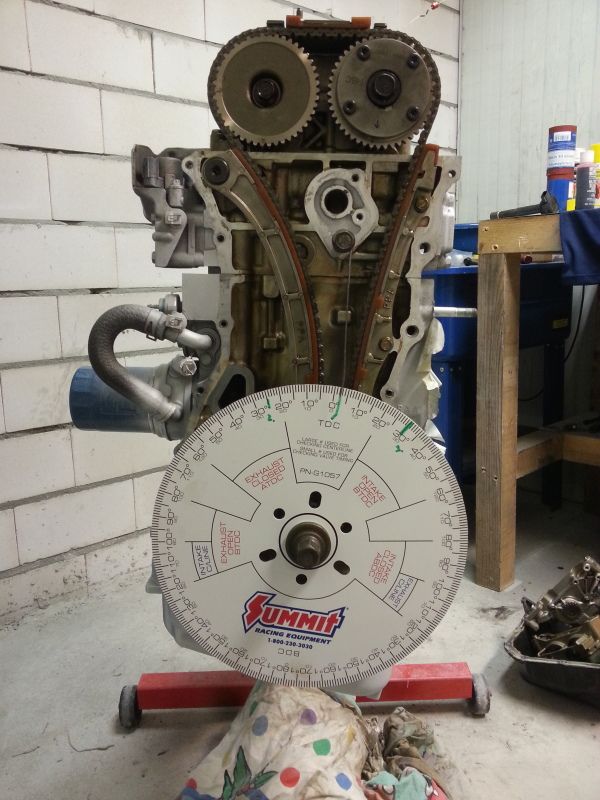

Degree wheel:

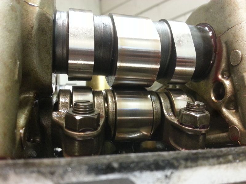

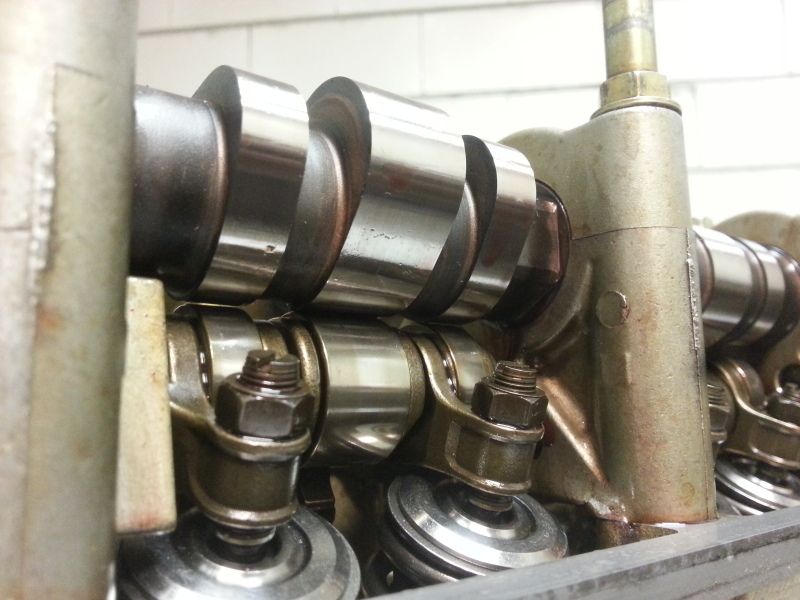

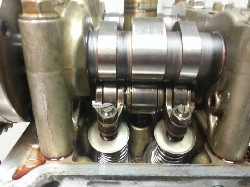

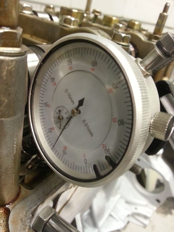

I will use the checking springs and install the cams and measure the clearance at each degree before TDC on the intake side. The weak spring allows me to push the valve to the piston and with a dial indicator I can measure the clearance.
Still got some tools and parts waiting to get delivered (piston stop) and supertech seals and keepers to make it all fresh again.

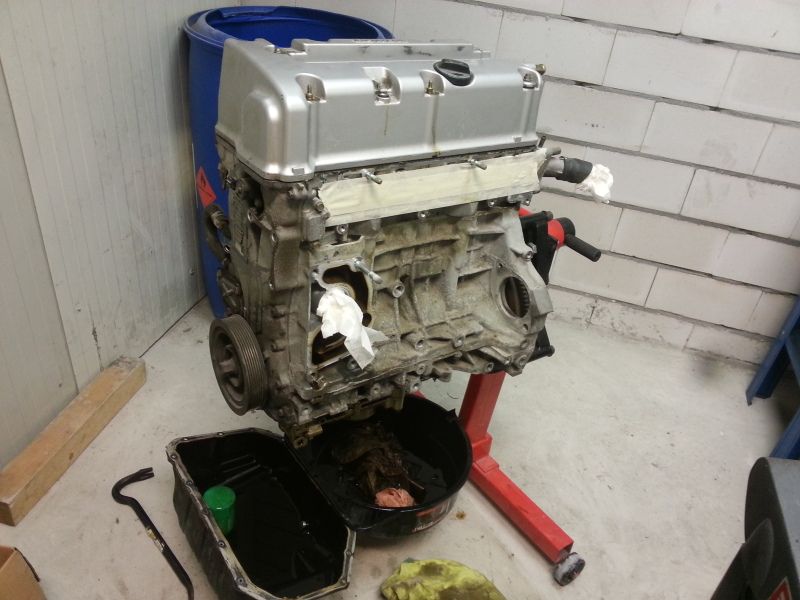

Well I have been working a few days on the car trying to put a higher pace into it to finish the car for time attack.
How the car stands right now:
Stripped the engine:

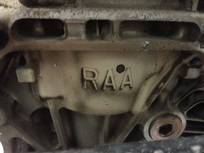

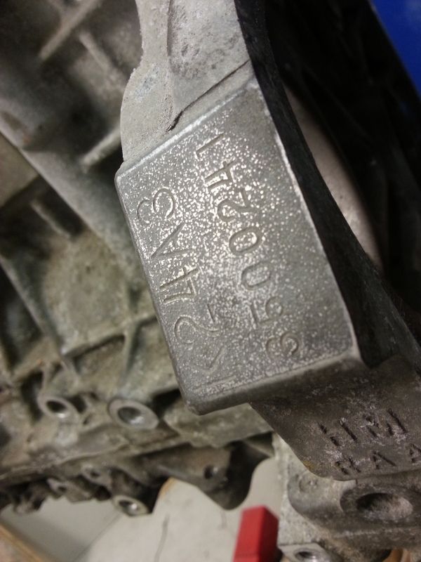

Engine code :>>:

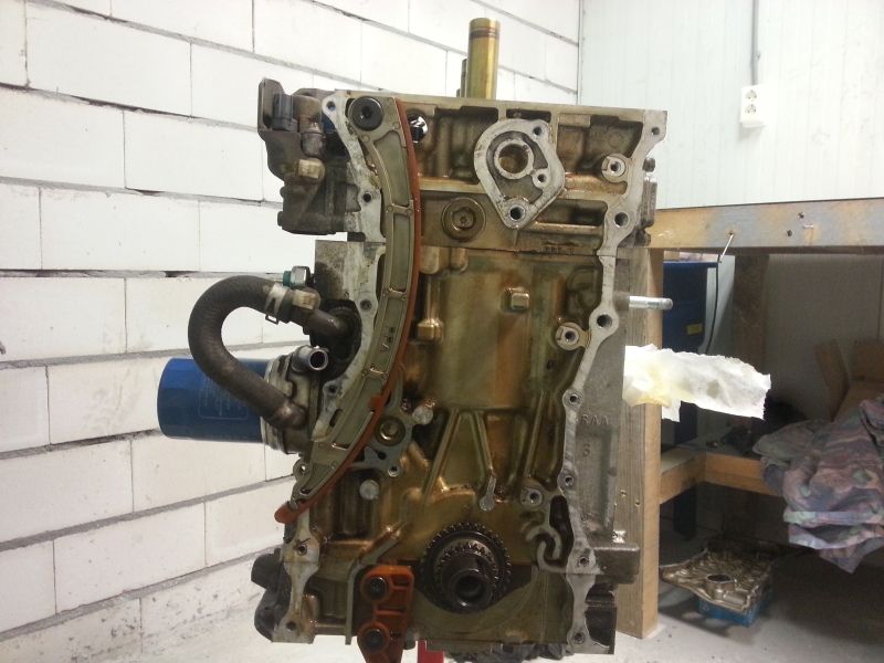

Naked!

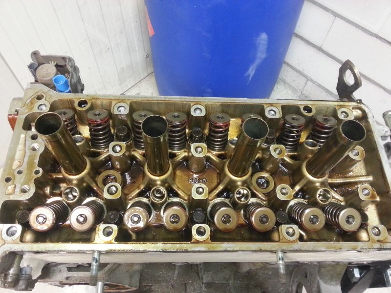

Bald head!

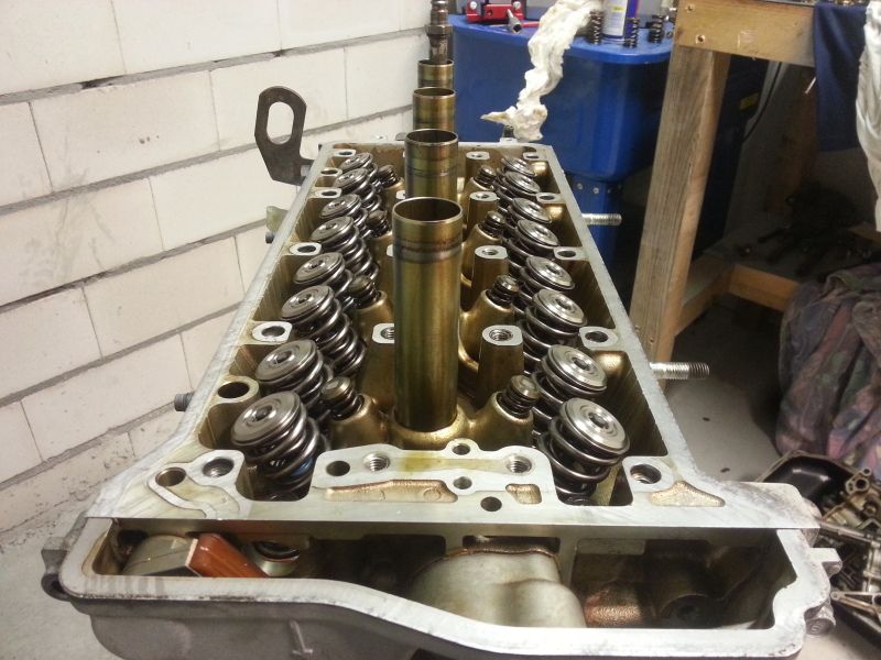

RBB-3 head:

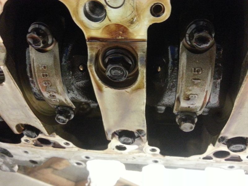

RAA bottom end:
Beefy Crank bridge and RBB rods:

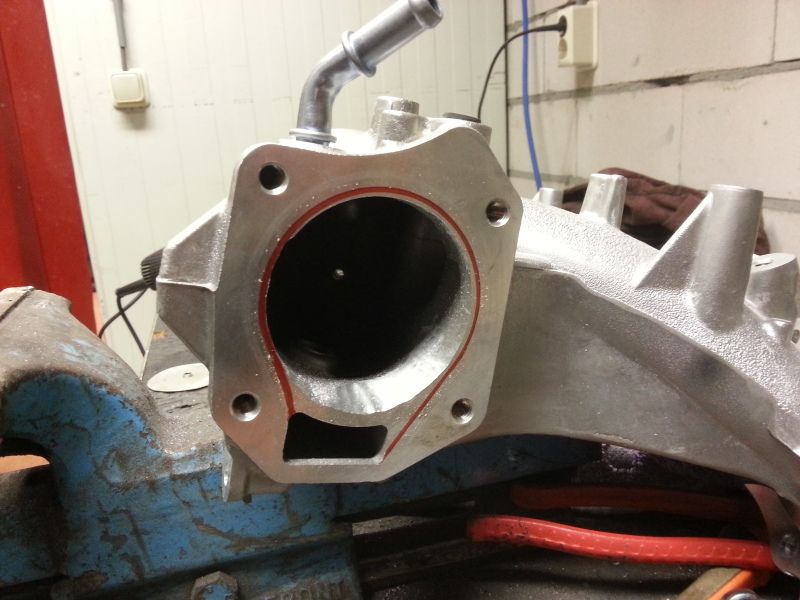

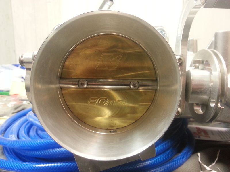

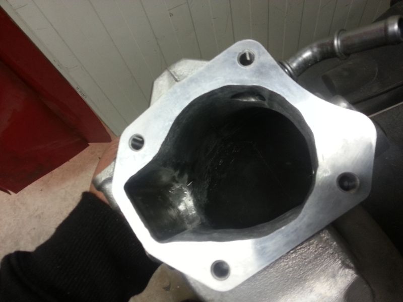

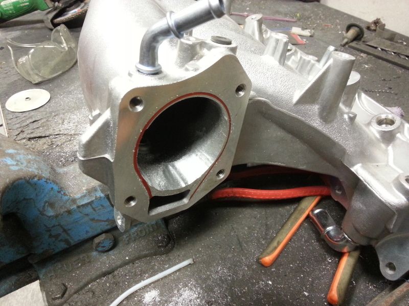

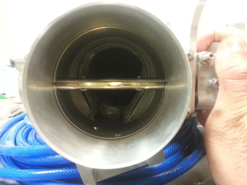

Porting out the RBC intake for the K-tuned 80mm throttle body
bye bye IACV!
Upcoming days I will measure the clearances to see how much VTC I can run. And I will put the supertech goodies in the head and the drag cartel cams :D

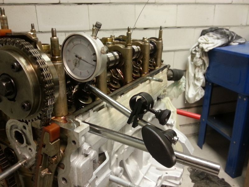

@BrakaT: I am going to install checking springs (weak springs) and then put a degree wheel on and measure on each degree before TDC the clearance by mounting a dial indicator towards the retainers. When the crank is positioned I press the valve in by hand (possible due to weak springs) and look at the dial for clearance.
Since that everything in the combustion chamber is stock I know that the only clearance issue might be P2V due to aftermarket cams.
I will take some pics when I will start doing the measurements

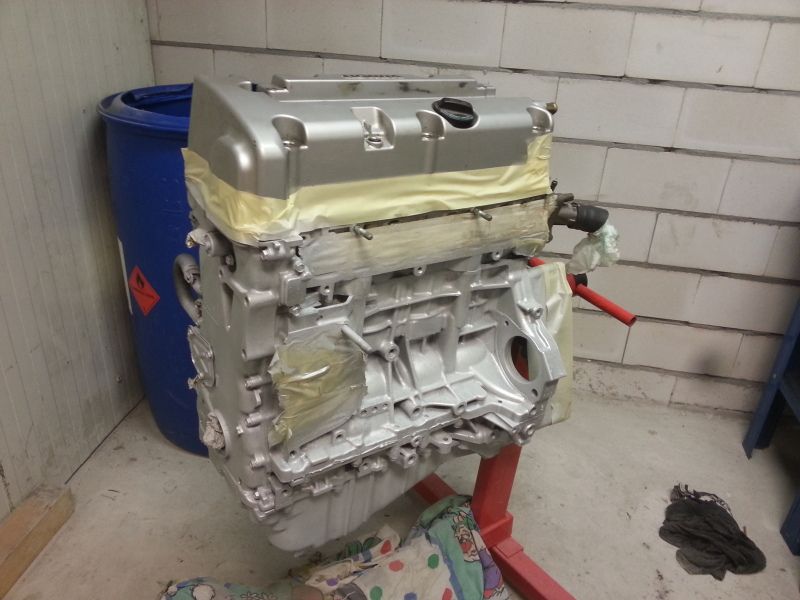

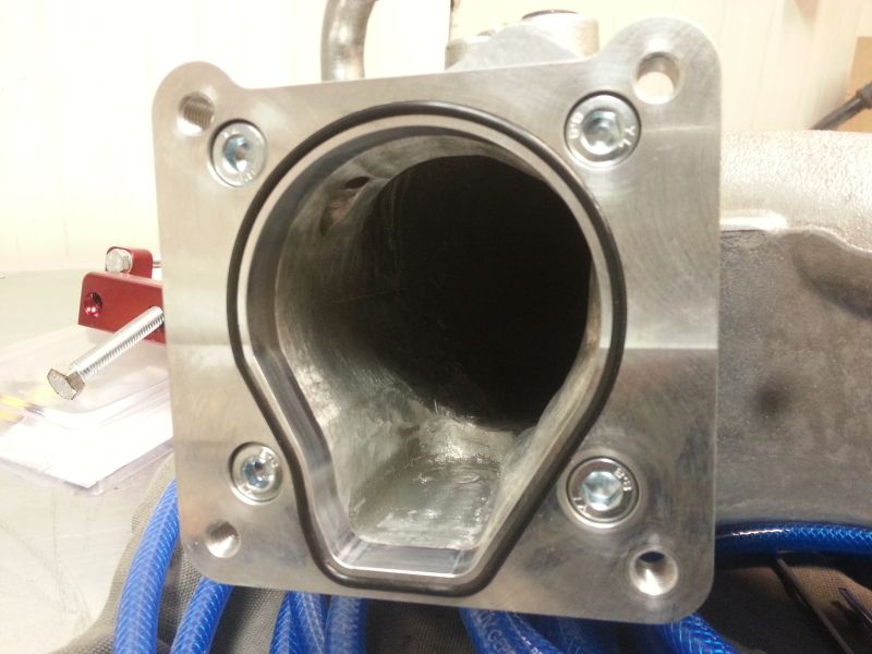

Yesterday I worked a bit on the car again. Still porting out the RBC intake for the K-tuned 80mm TB which is a lot of work because I have to remove soooo much material :p I will take some pictures when it's done.

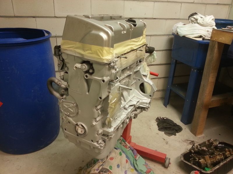

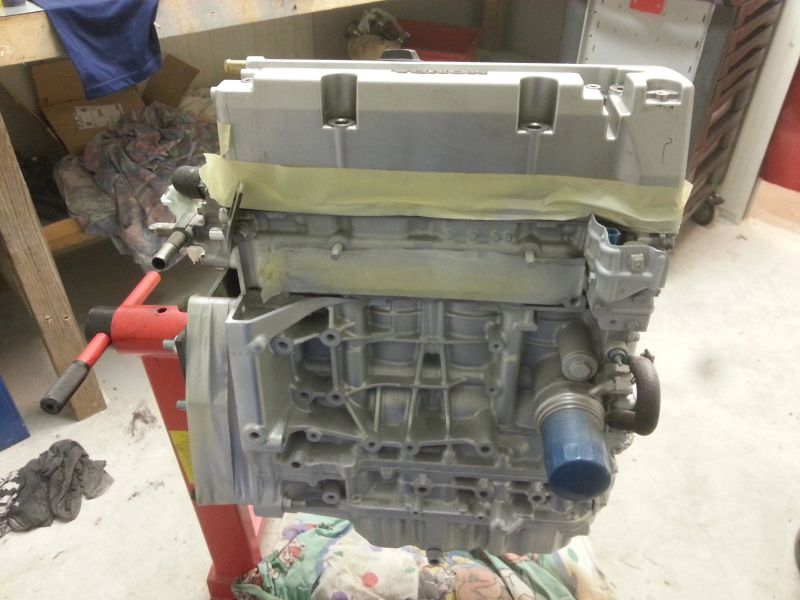

And I also cleaned the engine and painted it
Hopefully I can start with the head today :)
#21 · (Edited)
Here are the results of porting out the RBC intake:
Was a tough job porting that all out but it looks good now. The IACV port looks like a rough transition but the IACV port goes behind the 1st runner so most of the air there will be sucked up.
Some pics during measurements:
Used a piston stop to determine the TDC
#24 ·
Ok guys I measured it again after doing a correct valve lash adjustments... With 30 degree VTC pin locked into the VTC gear my clearance on the intake side with DC 3.2 cams was 1.75mm which is 0.06889 inches.
What clearance should be sufficient for piston 2 valves? I've read 0.07 inches and 0.08 inches...
Wonder if it is still worth it to run the RBC gear for those extra 5 degrees....
So weird that Jeremy said it was possible to run 40 degree...
Anyone who can have any inputs in here?
My guess is that usually most of the cam angles are used in the lower rev range to gain more torque/power and in the higher rev range less angle.. like 29 or something to 6000 rpm and above like 14 or less..
I was thinking that 30 was highest you can run but I'm not sure I think if its possibly to run the 30 then keep the rbc gear IMO

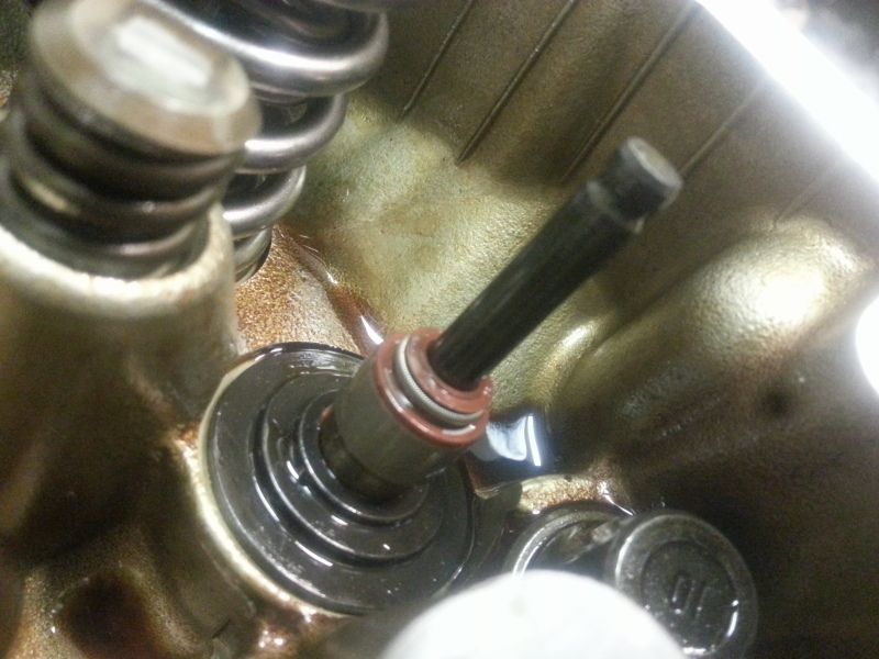

The head is finished but I am waiting for my oil pump kit to finish the bottom end.

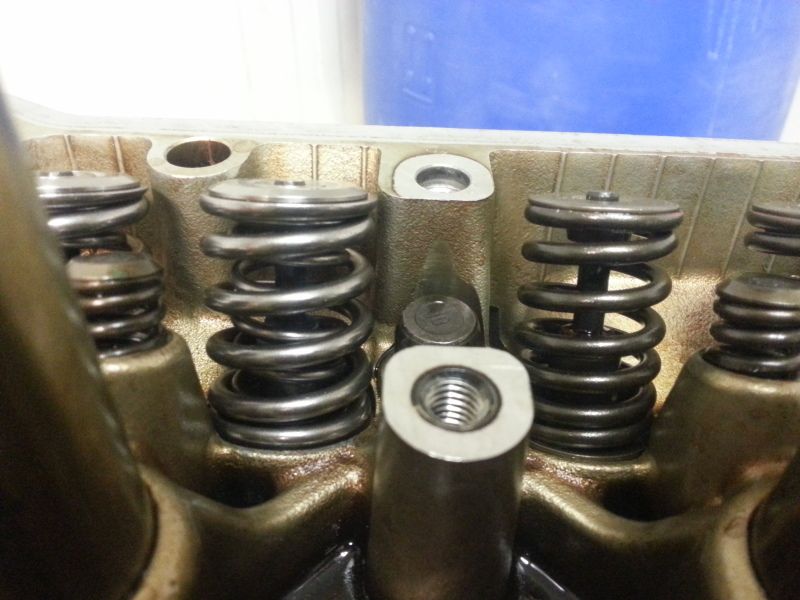

And I need to fnish my exhaust line, waiting for my header and need to fabricate a 3inch exhaust. Thinking about going with Kteller piping kit with Vibrant ultra quiet resonator and muffler. Hope that's enough to keep the noise down...
I am also going for an external oil cooler with a thermostat to keep the oil temperature down. With the k20 the oil temp went nuts...
And for extra monitoring I will also install an A/F ratio meter.
Some pic's

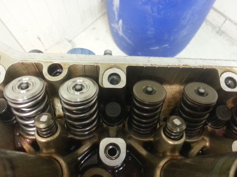

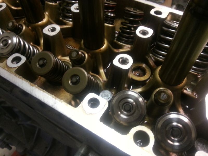

Supertech spring seats and valve seals:
Old vs new springs:
