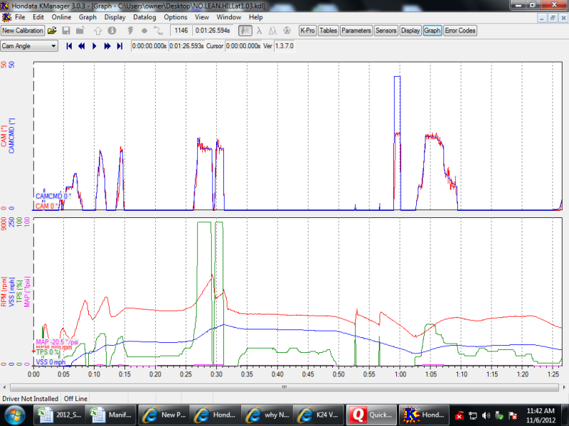

I have datalogged it many times... out of the blue VTC command spikes to 45degrees while driving. this is well after the motor is started & warms up.
in the past I heard when you start the car the ECU will test VTC... we'll its not when the car is started but it happens a couple of times during the driving cycle.
know your clearances :rolleyes:
explained by hondata http://www.hondata.com/forum/viewtopic.php?t=9701
here it is on a k24a2 (25* gear) @ 1:00 (on the calibration there is no vtc setting higher than 25vtc)
luckily for me everytime I have seen it happen it happens at partial throttle EDIT - it appears at part throttle on the low cam. So you don't really have to worry about the ecu "vtc sweep" unless you are running a vtec killer setup. But there are other concerns - mainly oil pressure

I have datalogged the event 3 or 4 times... each time TPS is very low (5-7%) partial throttle on the low cam. I do not drive around on the biglobe all that often especially for an extended period of time. I will continue to log & monitor it tho

I've never seen a CAMCMD spike happen in VTEC. It's already widely known that if your primary lobes are not 50deg VTC safe, then you cannot rely on the ECU to keep the cams from advancing beyond desired limits. This also applies for k20a3 cams that have a very large main lobe or for VTEC killer cams.
I can't think of a single major brand camshaft for the 3-lobe VTEC system that has p2v interference at 50deg advance on the primary lobes. VTEC lobes, yes. For the 2-lobe VTEC system, almost all of the stage III cams require a modified cam gear.
Too add my own experience, I drove around for 1+ yr, or about 20k miles with cams that were not 50deg safe on the big lobe (45deg max) and never had any v2p contact issues. When the motor came apart, there were no signs of contact on the pistons. If you are 45deg safe, then you shouldn't set the ECU to aim for more than 40deg as there is some hysteresis resulting in +2-3deg from the target.
