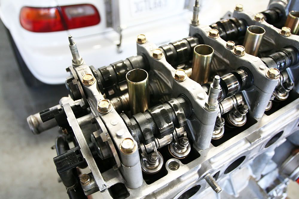

Hey guys, just thought I would post up an update of my friend Hung's eg that we’ve been working on at the shop for the last six months. We had the car tuned with the K2’s at Churchs before, but we recently put in a set of skunk2 stage 1’s with an exhaust cam gear retarded 5 marks . Pretty impressive, heres is the results,Top graph is skunk2 stage1 and bottom graph is ips k2. We will be doing the stage2 test soon :up:
Motor setup
k20a2
unport head only valve job ( soon to be change)
prc manifold with stock TB ( soon will be change)
ips valve springs and retainers
ips k2 cam
ips 12.5 87.5 mm pistons
pauter rods
jdm crv 5.02 fd with quaife lsd
Exedy stage 2 with lighweight flywheel
DSS level two axles
k pro
550cc injectors
bdl fuel rail
r crew header (soon to be change)
3" exhaust

Just out of curiosity, why Pauter rods? Pauter makes an excelent rod (one of the best for big HP FI), but unless its their titanium rod its going to be a lot on the heavy side. Plans to go FI later on maybe?

In regards to the K2's not receiving fair treatment by not having the exhaust cam retarded; well, they wont make any more power with an exhaust gear. Nikos, do you know what the exhaust centerline is on a set of K2s when installed? If you dont, go degree a set, or even better, go install an exhaust gear and dyno it.
To be clear, im not trying to bash or anything, just want to make sure you're aware of why the k2's wont make any more power with an exhaust cam gear retarded. The centerline is already at 104.
And yes, this motor defintiely needs an RBC manifold and bigger throttle body.
