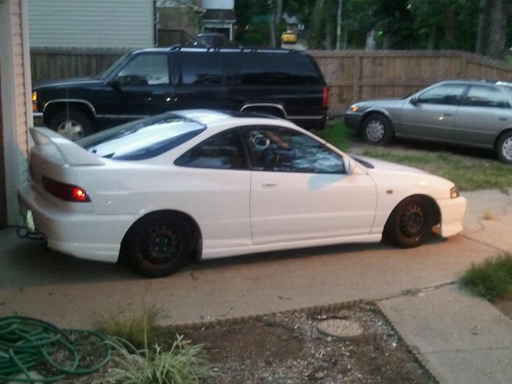

started off with this. i wasnt happy so the first thing i did was get rid of the ls and swap in a jdm gsr with lsd. i knew i was going back to k20, but i needed something with a lil more pep to get me by. But as it sits i dont drive the car at all so i dunno why i did that lol. i should be able to flip it when the time comes tho.
ofcorse it didnt stay like that for long. then this via the mother land

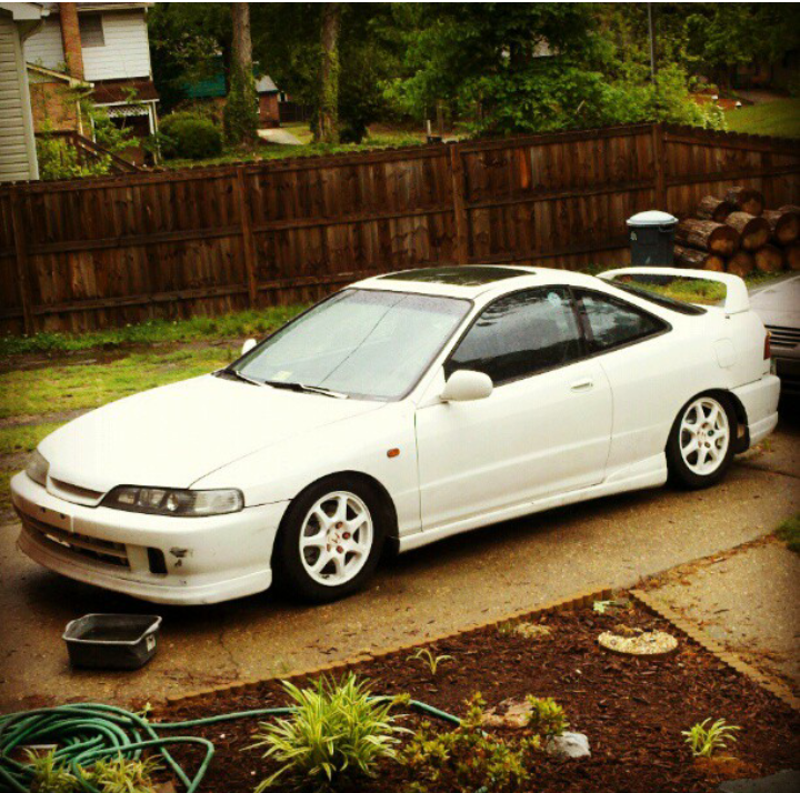

that turned into this. i ended up painting it in my driveway. turned out aight for a home made paint job lol. wish i had pics of the process. it looks good from far away lol. but you can tell i had no idea what i was doing. especially when i shaved the side moldings haha. you can still kinda see where the holes were. but i know come first of the year im getting it professionally painted so for now i aint worried. its a project car for a reason right lol. i then bought a 98 rear bumper and what i thought was oem optionals. but upon arrival they were clearly some oem replicas attached to oem sideskirts. opened up a dispute and fought with him for awhile. end result i got to keep the reps and collected all but 110$ from him. so i couldnt complain they were nice reps and fit alright and i got them for 110 shipped lol. i painted them up and installed them and this is the result:new_slayer:

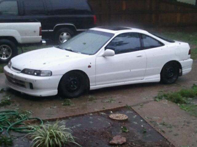

my last teg was wingless and always wanted to go with a oem itr wing. so i found a seller on itrca.com that was letting one go. so i jumped on that. painted it and installed it as soon as it came in. this her currently chillen rocking a jdm gsr sitting on tein super streets. shes rough right now. but i have plans for her.

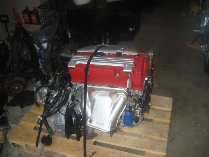

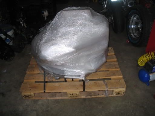

i kept everything from the stock old motor and contemplated on selling it to a guy that wanted the whole swap. with stock itr header to put in his rsx. i tossed the idea around and almost sold it. but then decided to put it in my new car. this is how the motor sat for years 09-13 until i decided i wanted to spice up the power
un wrapped it and started the tear down
i know i didnt wanna go to crazy on the build but i def didnt want a stock motor. previous motor made 231/160 with rbc 3in intake dtr/ssr long tube header and 3in exhaust and tune. i was very pleased with it. anyway so i broke down the motor again no pics of the process.

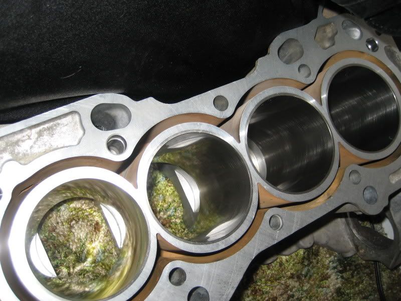

k20r block bored to 86.5mm

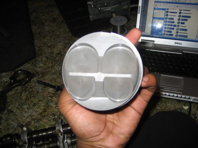

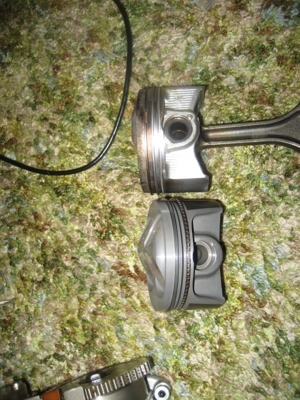

wiesco 12.5cr 8.5mm pistons

stock 11.7 piston to 12.5 weisco

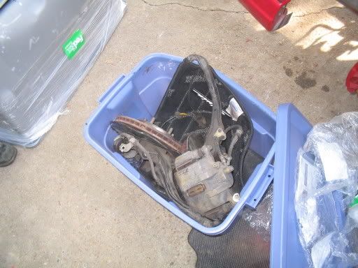

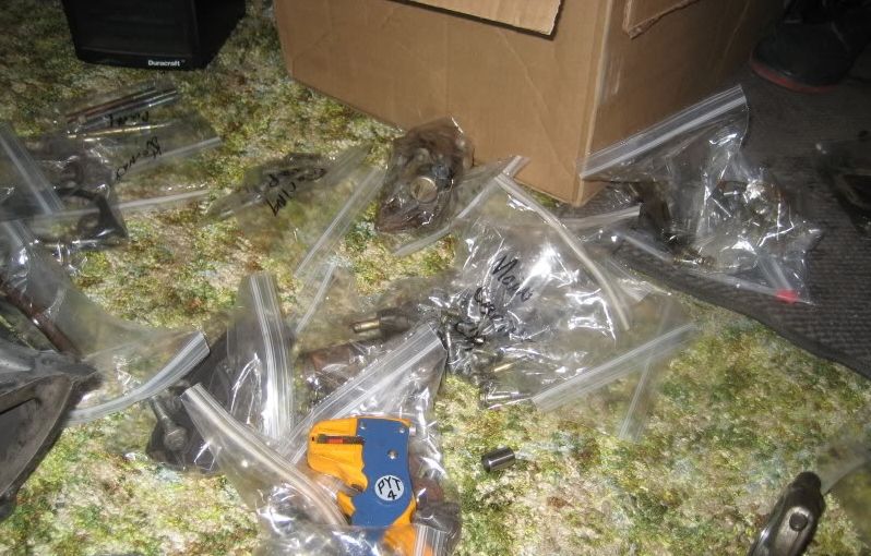

everything apart and labeled ready to send off

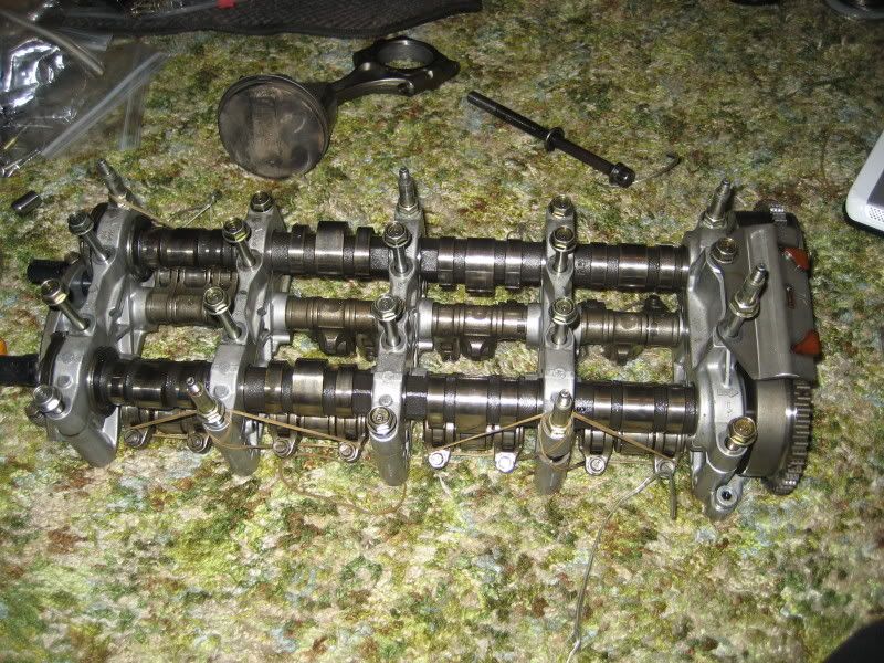

itr head guts all rubber band up

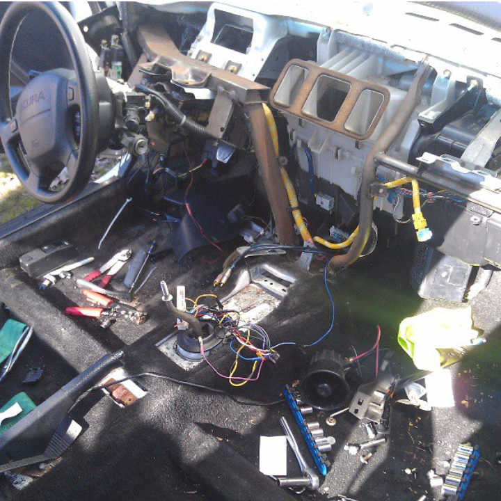

removed the dash to clean up some of the wiring and do brake tuck. also installed 2 loud ass piezo horns that i integrated into my alarm. these fuckers are loud as hell, so loud that my eyes hurt lol.

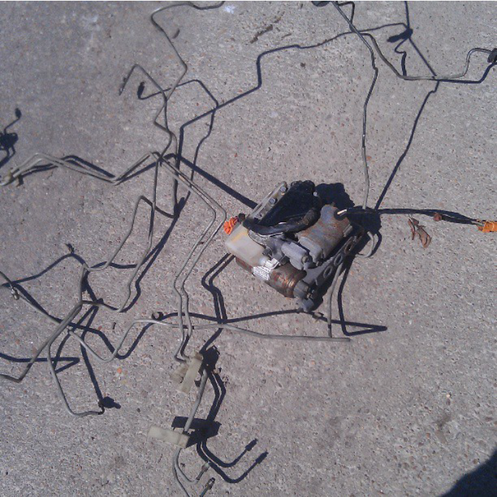

abs pump out along with all those unnecessary hardlines lol

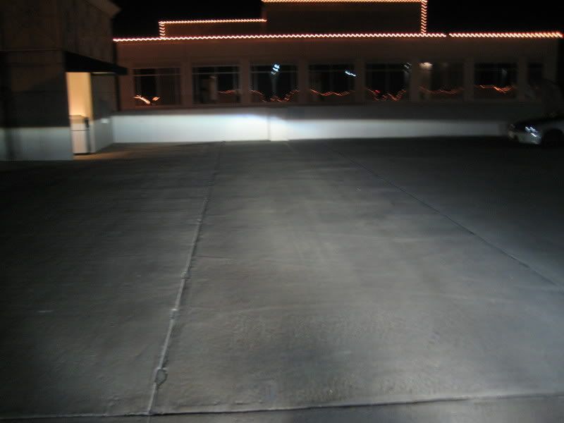

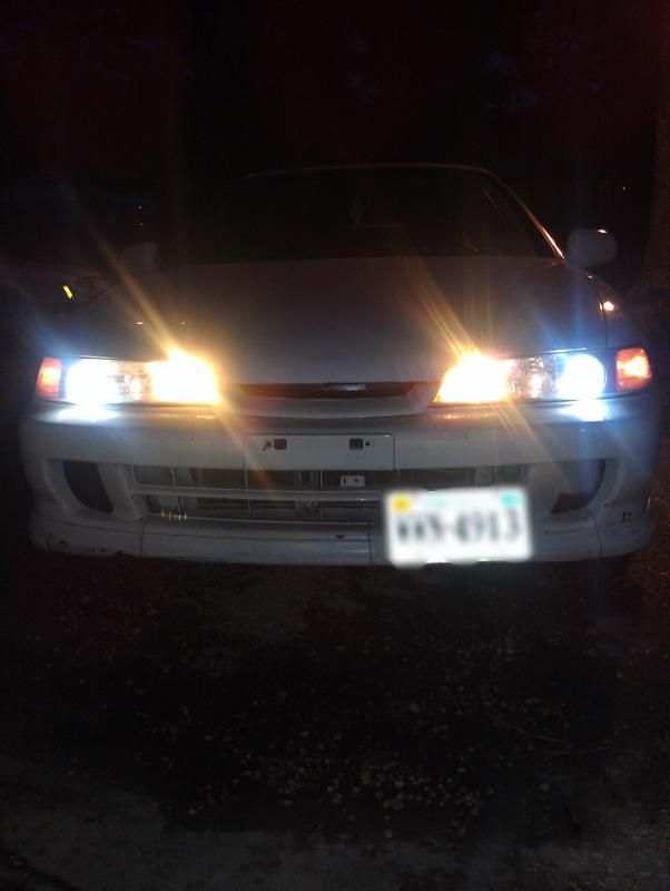

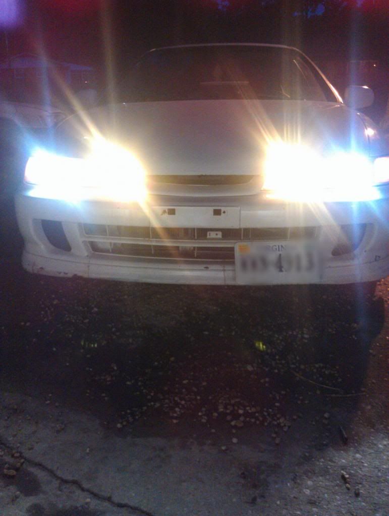

a shot with oem hids with 8k d2r bulbs and 3k hid fog lights lol. i wanted a blueish white color. i believe i nailed it. ive never liked the city lights tho. so they will be deleted. my running lights will consist of the fog light being on and my turn/sidemarker lights and my fender side markers.
i hated the fact that they werent aligned so i worked on aiming them for a bit. got them even and just low enough that it doesnt blind oncoming traffic

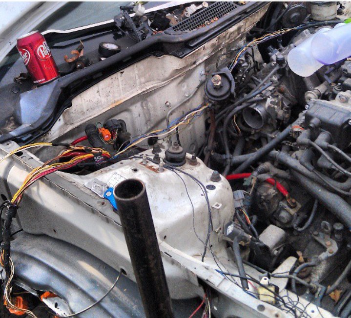

shot of the dirty engine bay. removing abs and all the wiring along with it. also tucking headlight harness. i moved my optima red top to the back and put my engine bay fuse box where my passenger air bag used to be. i have a air bag delete tray there now that i can remove to get acces to fuse box

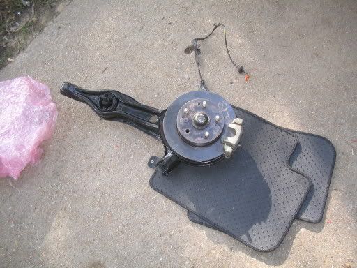

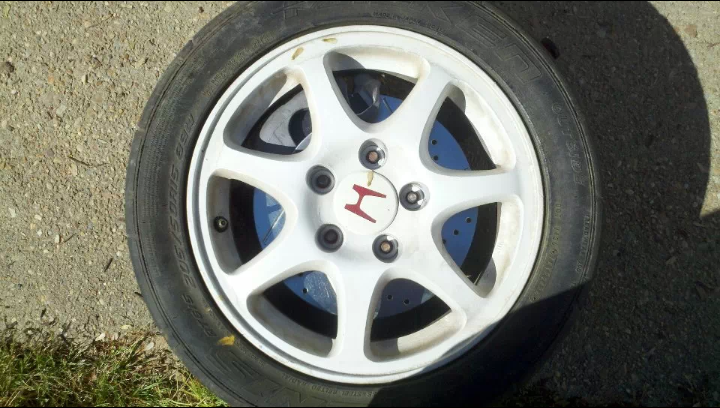

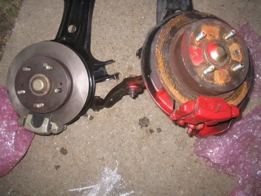

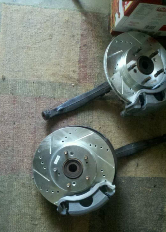

jdm 36 mm vs stock 4 lug

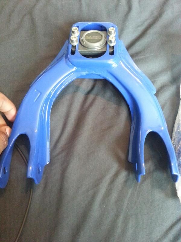

adjustable upper arms
blox camber arms
some suspension parts

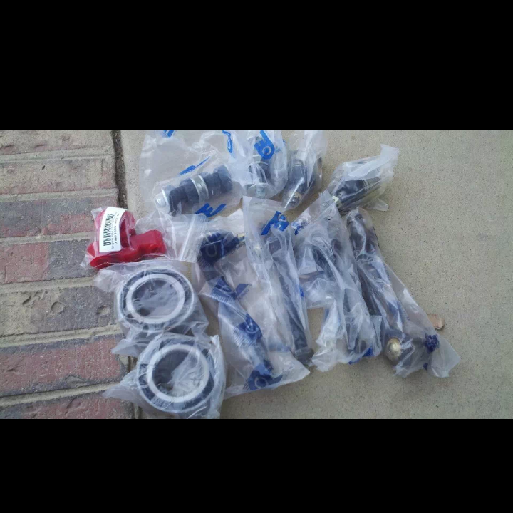

36mm crv wheel bearings, inner and outer tie rods, ball joints, and sway bar end links

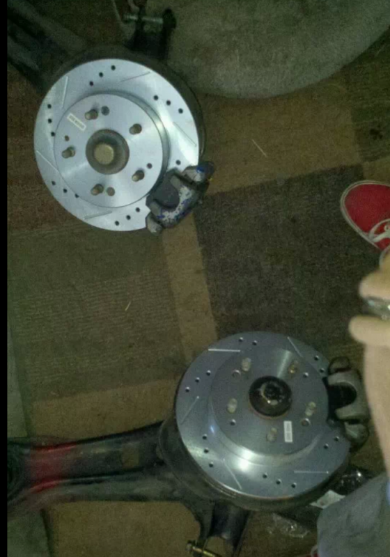

anyone looking for a hasport shifter set up. someone help me fun my radiator haha looking for a quick sale box cables mount plate and everything

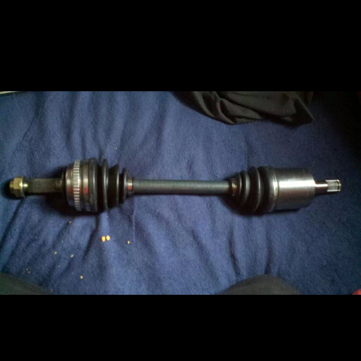

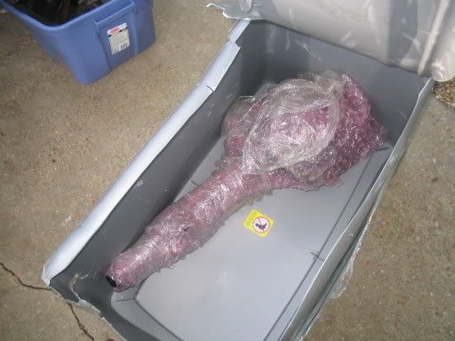

jdm itr axles 36mm pain in the ass to find

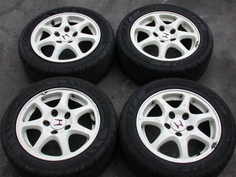

temp wheels in jdm ctr wheels cleaned them up
i think itll look nice

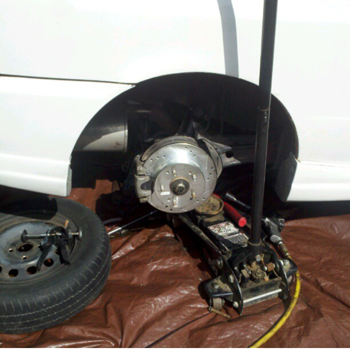

rears

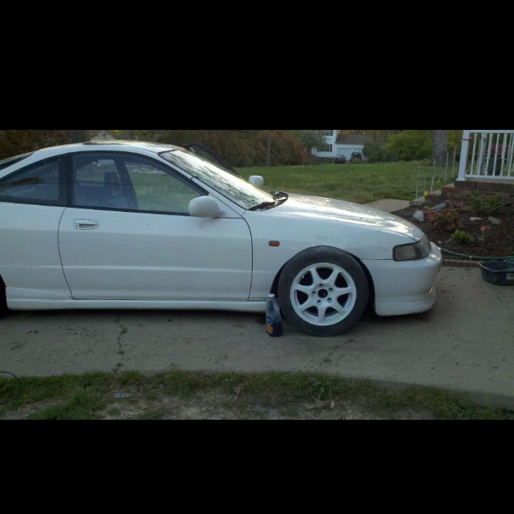

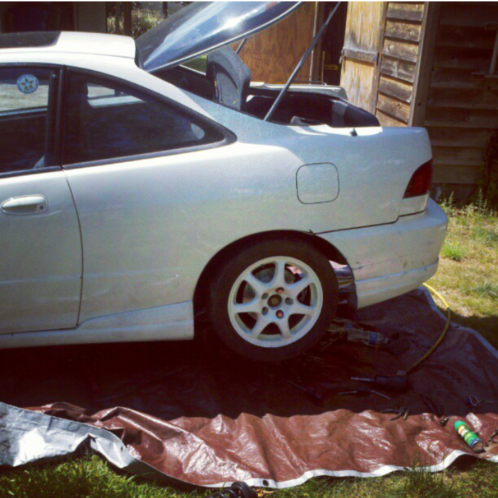

it started off nice outside sooo time to get a lil dirty
fronts
end result

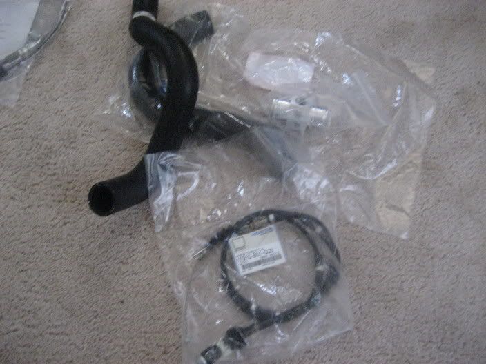

rad hoses and throttle cable

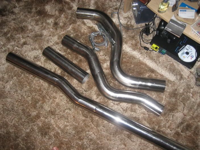

3in exhaust and yest i still play the ps2 from time to time just for grand turismo

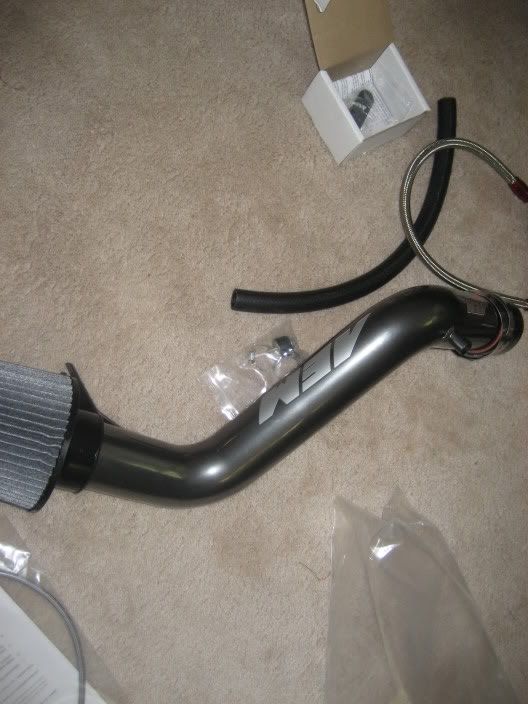

aem intake
