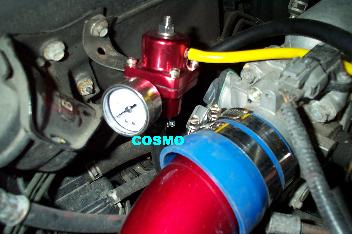

From the stock fuel filter, you will need a banjo bolt+fitting to go in the fuel line that will take you to the Fuel PRessure regulator, then to the fuel rail, out of the fuel rail returning back.
Some people put the pressure gauge on the fuel rail, other on the Fuel PRessure regulator and some add a gauge to get the correct pressure dialed in and then remove it. The aeromotove FPR that I will be using has a place for the gauge so that is where I will be mounting mine.
There are 3-4 fuel rails that can be used not to mention that with the right tools you can even modify the stock k20a fuel rail, but I didn;t want to start a fire so I didn;t. The AEM , STR , units are nice but the Golden Eagle Fuel rail was the best choice for me because it costs around $100 less that the others.
So basically you need a fuel rail, lines, fittings, FPR and a guage

Here's a pic of a nice EK k20a. Notice how his setup has the FPR
HERE' S A EG WITH THE FPR MOUNTED ON THE FUEL RAIL

i will be doing that setup like fearless, its cheapter for me and i dont need the shinny lines, i' had boght an aem FPR from Hybrid but was thinkging, i have an Cosmo FPR from my B16 just wondering if it will work.
