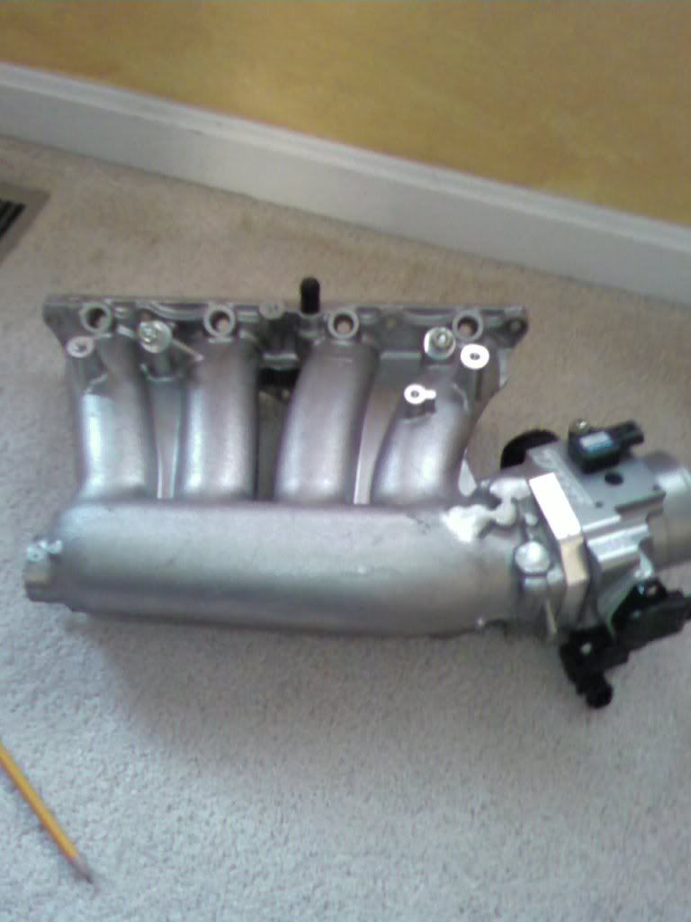

RBC intake mani
70mm BDL throttle body
(I port matched the RBC to the Throttle body)

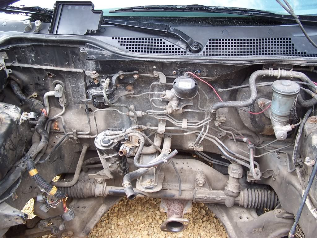

Motor work.
Radiator bracket i made and more motor stuff
