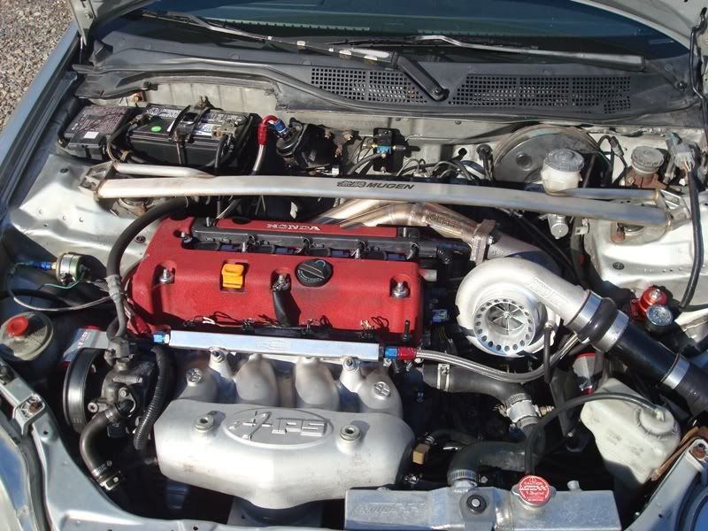

This build consists of.......
Stock K20a-r Block
Stock K20 head
Stock K20a-r cams
Supertech valvetrain
Stock K20a-r Tranny w/4.05 Club RSX FD
CC Twin Disk
ID1000 Inj
IPS K24 Manifold w/75mm Accufab TB
FR Sidewinder T3 Manifold w/44mm WG
Precision SC6262SP .82 A/R Turbo
Mishimoto Intercooler
3" DP
3" Exhaust
It was tuned with 93 octane on 11.5 psi

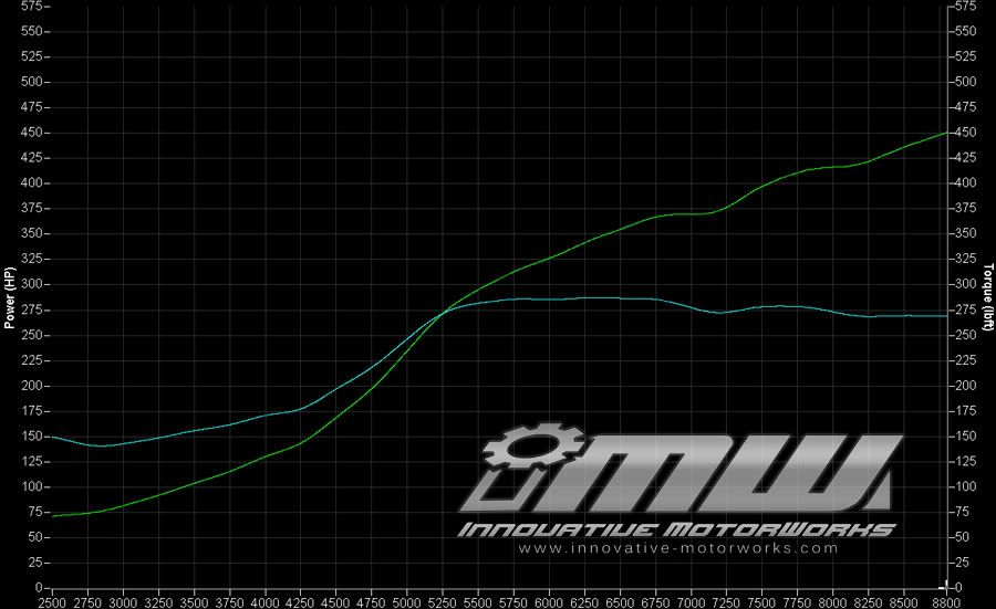

:wow: 250+ ft/lbs of tq from 5k to redline..

465 Posts
How come it only got revved out to 8800 and not like 94-9500? I see you listed you have Supertech valvetrain so I assume springs/retainers. The power seemed to still be climbing.
