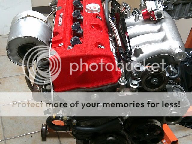

Here are the pictures!
Updates 4-21-10
Heres some pics of my intercooler and the new SSA battery mount kit.
4-21-10
Dave just finished welding my downpipe, and dumptube. Also added a flange to bolt up to a skunk2 2.75" / 3" . Look at the penetration of weld, completely amazing! Enjoy!
4-29-10
Chris aka Bugermass got a whopping 450hp 320tq @ 22psi (remember this is a mustang dyno, so im really at 500hp ;)
6-19-10
Well the bottom end is being blue printed. Here's some pictures of the head. Look how awesome the port and polish job came out..
And heres some of the Pauter Forged Rods.. They look so sweet!
6-23-10
Still waiting on bearings and then SSA will re check the clearences, assemble the block, dis assemble, clean and then finally assemble it.
6-25-10
Got some more pictures!!! :)
and heres some more ...
Finally done!
My tranny decided to blow up and 4th gear was sheared off..
So i went with some albins..
