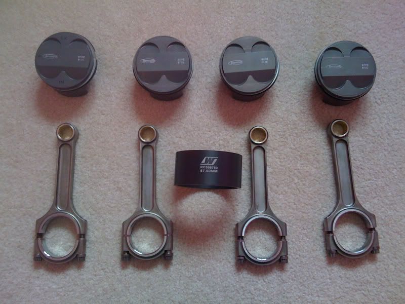

12.5:1 87.5mm pistons for K24 engine. I think I'll try the K20Z3 first though.

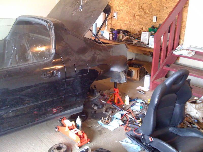

Decided to start on the back end. Removed 4 lug hubs to replace with ITR 5 lugs later on. Trailing arms already set up for disks. Shorter spindle can be used but need a Mazda Protege axle nut.

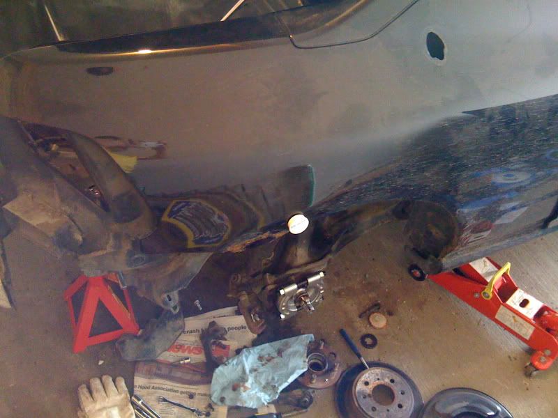

Part of the bearing was stuck on the spindle on the right side. Using a bearing separator in conjuntion with my puller to get the last piece off.
One upper arm was seized. Had to cut the bolt. Too bad part of the bolt is still stuck in the threaded part. :( Camber kit will need to wait until I get the bolt out or get a new trailing arm.

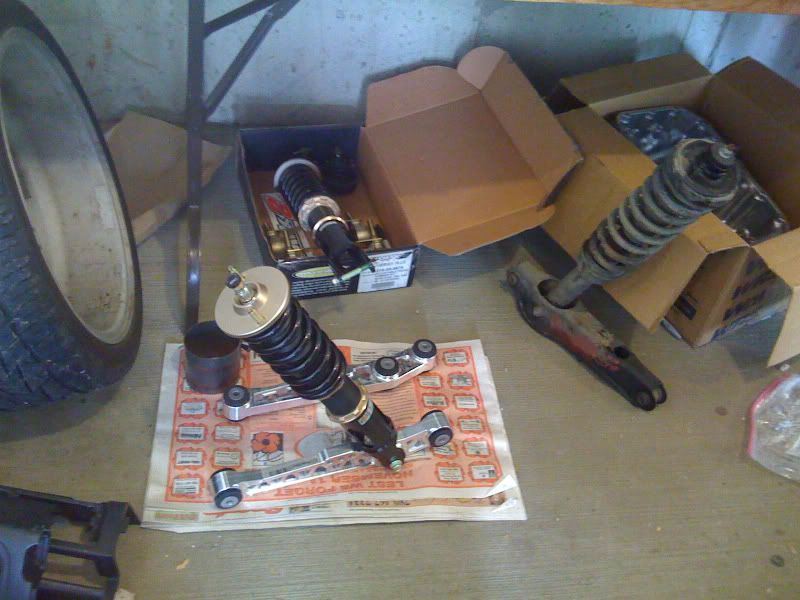

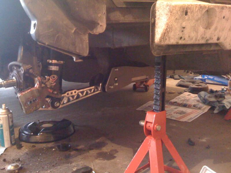

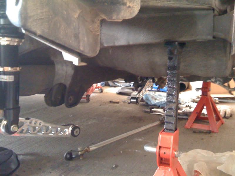

Since the rear is jacked up, replacing the ITR suspension on my car with new BC Racing (BC Racing is not Buddy Club) coilovers. Also installing ASR subframe brace and Function7 control arms.
No more need for the previous owner's tie bar!

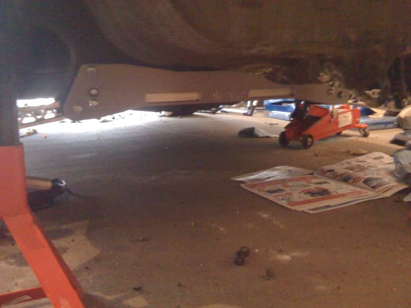

ASR subframe brace installed for now without the sway bar and brackets.
