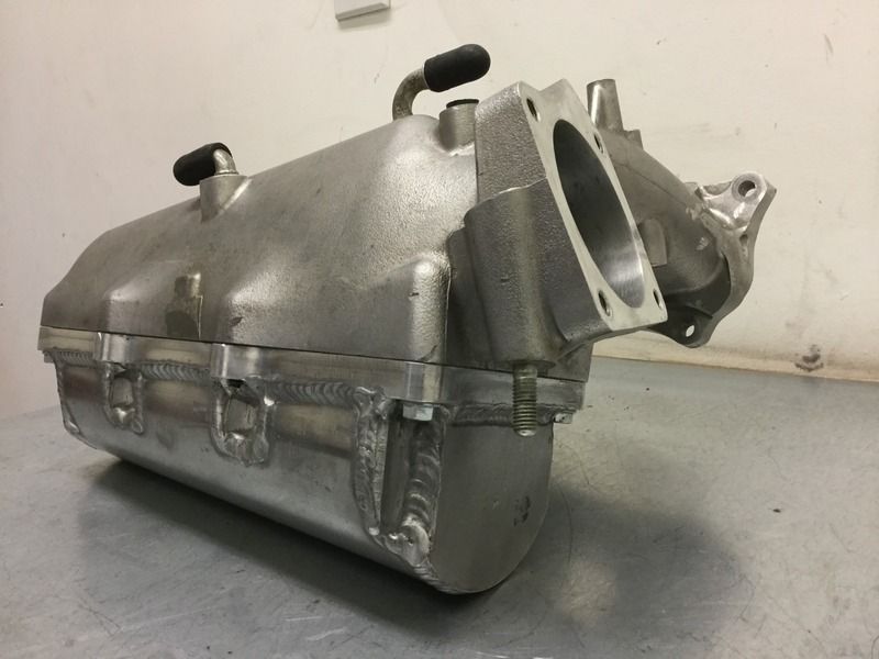

finally i've almost finished to build my rsp intake manifold + 1cm extra aluminium gasket for increasing capacity, skunk2 70mm b series throttle body ;)
i hope i'll have some great numbers :)

Couple of updated pics. I can't wait to test... In the spring :thud: time to get going on the centerfeed

Hi 6spd_EK, thanks for updating your plenum investigation (hopefully testing) here.
...time to get going on the centerfeed...
Long time awaited :)! Maybe my NaFI'd IM with it's unique runner balancing technique is ready for tuning before yours...as it seems to be the Winter's at your place are longer that those we have here :D

have u tried to put it on engine, i had some problems with mine because of alternator, i had to shave some of it :D
butnow its inside ;)

have u tried to put it on engine, i had some problems with mine because of alternator,...
Hi Muzzle, which alternator part no. is installed in your enginebay? And is it installed like stock?
Markus
Its in its original place, but ive used a 10mm aluminium gasket to increase plenum, thats why the back of intake manifold was touching alternator ;)
Thanks for clarification Muzzle, I didn't see it...just thought something looks different, can't be as every alternator used in Europe fit's to the RSP IM...was confused :D.
So you did color the gasket? Is it a PTFE (Teflon) or...?
its from aluminum , i do not know, why it has a little bit different color, maybe it was painted before cutting ;)
finally i've almost finished to build my rsp intake manifold + 1cm extra aluminum gasket for increasing capacity, skunk2 70mm b series throttle body ;)
Thanks for the heads up! But I cheat - I already have ktuned idler kit that relocates the alternator lower :silly:
