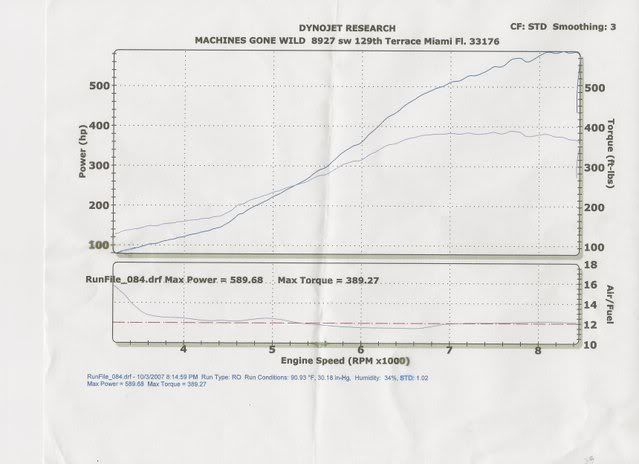

Motor:k20a2
Power:589hp (c16)
Turbo:gt4094r twin scroll
Manifold:td autowerkes twin scroll
Wastegate Size:tial 44 x2
BOV:tial
Injector Manufacturer and Size:1200cc pte
Piping(including dowpipe and exhaust):3"
for more info on my car go to my build thread.....
http://www.k20a.org/forum/showthread.php?t=46602
1,685 Posts
how can a stock motor handle up to 25 psi? Thats nuts...
it can be done if tuned properly.the setup lasted about 4-5 months at mid 500s and i turned up to almost 600 and it let go soon after.motor had about 40k on it and i drove it like a i stole it.
1,685 Posts
trannies will last a but usually in the 400hp range when you get 500+ range then throw in some tires that hook decently it becomes a problem.ppg gears are the way to go,i am going to get a set as soon i get some extra cash.for now i just keep feeding my car 4th gears every month and a 1/2.
