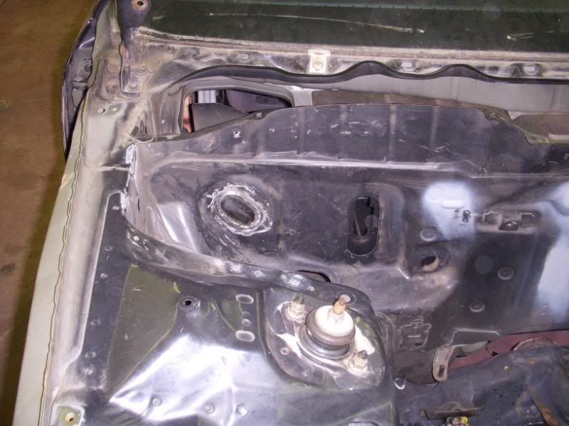

Well Ladies and Gents... I figure we Throw up A build thread on one of the Main cars In Performance Technique... For we do Have have a couple of cars .. But this one of the two cars we are focusing on getting together for the 09 season.. It just started off as ur simple Ls ek aka (The Flamer). The Name Speaks for it Self... haha.. So what we started off doing is yanking out the ls... Painting and tucking the Bay.... Cause we Like our cars pretty!!!hehe . From There U will see her transform into what she is today..

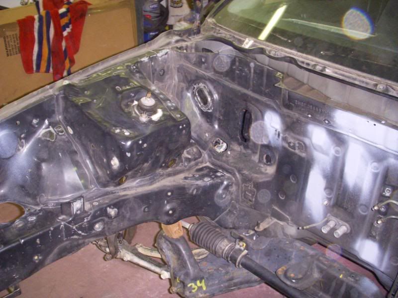

Stripping the Bay done..Getting it ready for paint...
Prime Almost Ready For Paint!!!

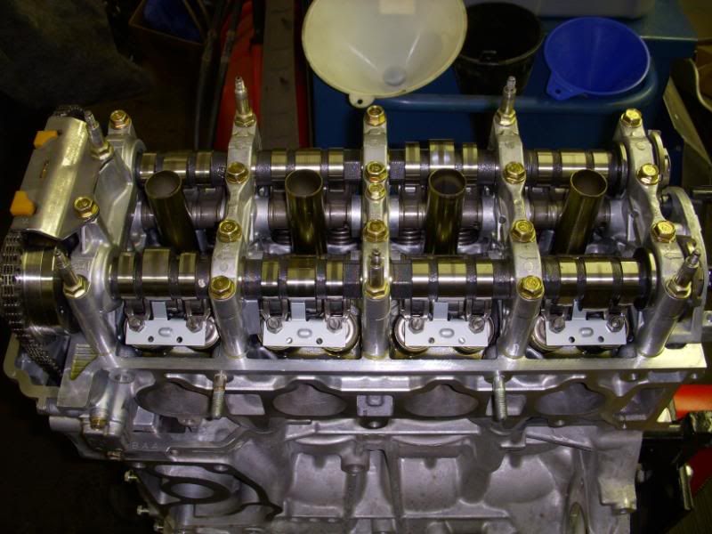

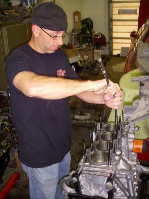

Here we have chris throwing together his k24/k20 setup for the flamer...
K24/k20 all stock..other then bolt on ..rbc,bdl 70mm throttle bodie ,ssr header,750cc injectors .255lph walbro pump.. custom intake..everything else stock... tuned by evans..here the link

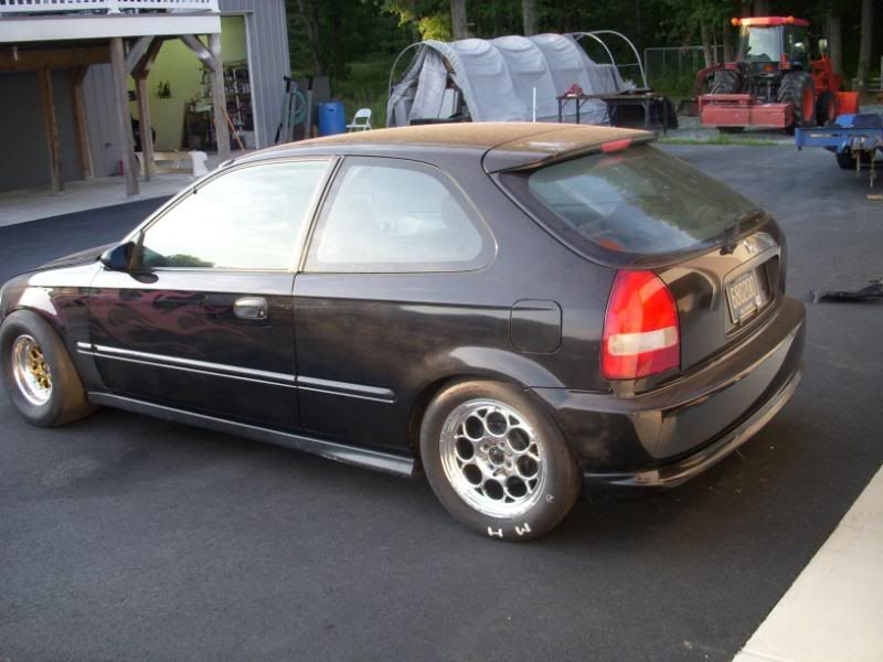

Some Pics with the slicks!!!WE know WE know She slammed.. WE raised it up the next day !!
