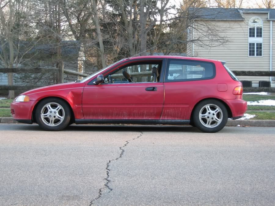

1,680 Posts
i have koni/GC with rates of 400f 450r thanks to kris.
Also, ES bushings on the rears, OEM on the front
ITR front sway bar.
SRR LCA's, skunk 2 lower tie bar.
15x6.5 slips wrapped in 205-50 RT615's
heres a pic:
