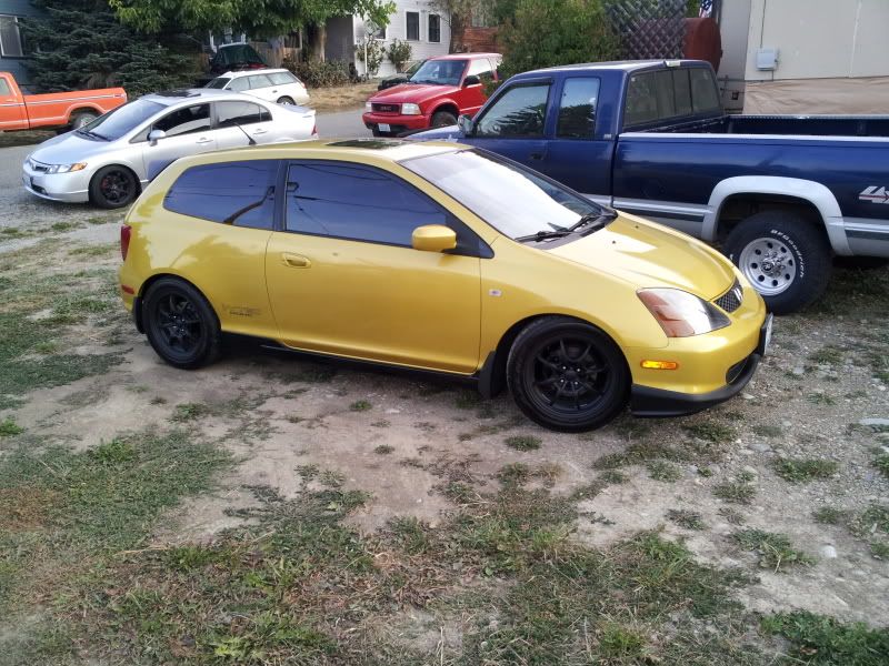

got any pics of the car it's going in? or any other details on the build?
sorry it so vague. heres the car
some of the specs are....
CP 12.5:1 pistons
kelford 179b cams
ported RBC
74mm hr TB
precision 650cc injectors
obx race header
should be a fun car plan to auto x and hopefully road race her if i find the time this summer. kinda just like the idea of rolling up next to my buddies sti and walking away from him without the use of a turbo.
thats my chicks si in the back thats our kid hauler
