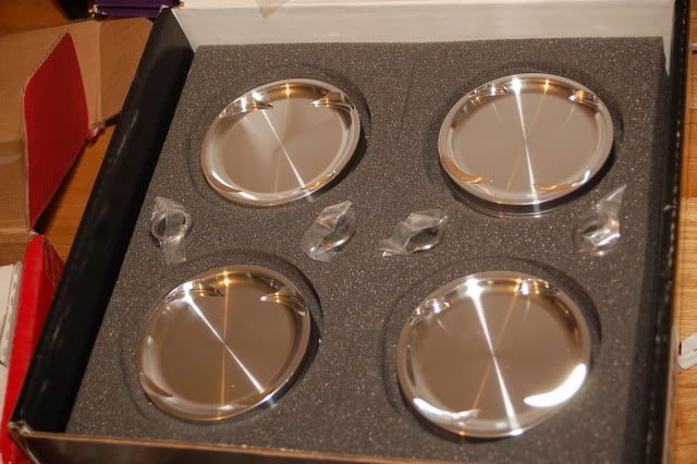

Just wanted to give you all a little update on whats been going on.. Been buying a few parts here and there.......
87.5mm 9:1 Cp pistons
IB H Beam rods
K20z1 Cams
Arp Headstuds
So now all im really waiting on is to get my Cometic Headgasket so I can get the ball rolling on this thing...... Winter season is coming up so I would really like to get it ready for it......
And now here is me bored as sh*t @1:30 in the morning...... lol...
