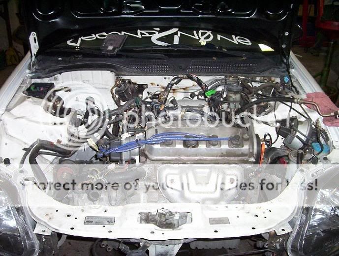

these are the only pics i have. the car doesnt run but should be runnin in a week or two. ill post more pics when the car is running
Nice car!!! Let us know the details.. About the parts you are using and who is doing it :)

Nice pics. Let us know more of everything you've done, because i'll be doing it in my 97 coupe soon, and i stilll need to piece together a few things, so the more help the better! Thanks.

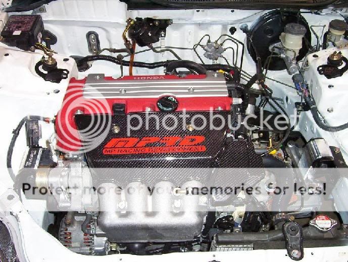

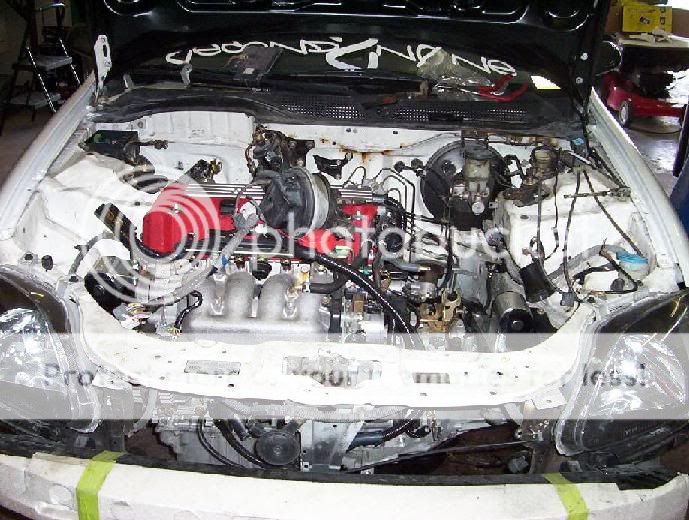

was what hard? the swap was pretty straight forward. figureing little things out is time consuming and so is the wiring. MPRD aka Mp motorsports in lovely las vegas nevada is doing the swap for me.
7,171 Posts
JDM K20 Coupe said:
all the labor is sponsored. no mods right now but it is a type-r
I see you don't have an intake on there yet.
Any plans as to what type of intake/header combination you are going to use?
Are those Hasport mounts?

yes those are hasport mounts. they are going to biuld me a custom header and intake for it
Did you just move the radiator over and drill new holes for the brackets? and what hoses are you using.
no we put the fan were the ac fan went. used rsx top radiator hose and a custom bottom radiator hose
