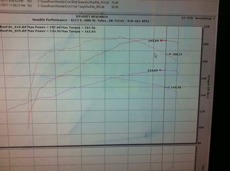

final numbers from last night after only 10 pulls
Alex wants me to drive the motor to loosen it up and then try some new things like a 4 inch intake. maybe the motor has a few more hp left in it while still utilizing an rbc.

Definitely has more in it especially that peek power.
