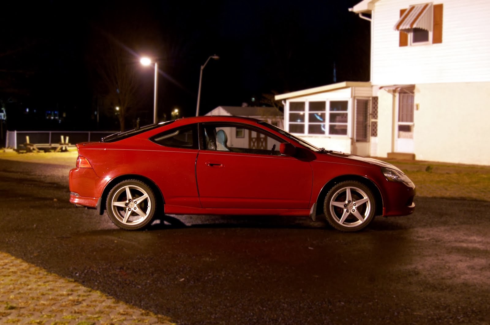

My car is a Milano Red 2006 Acura RSX Type-S.

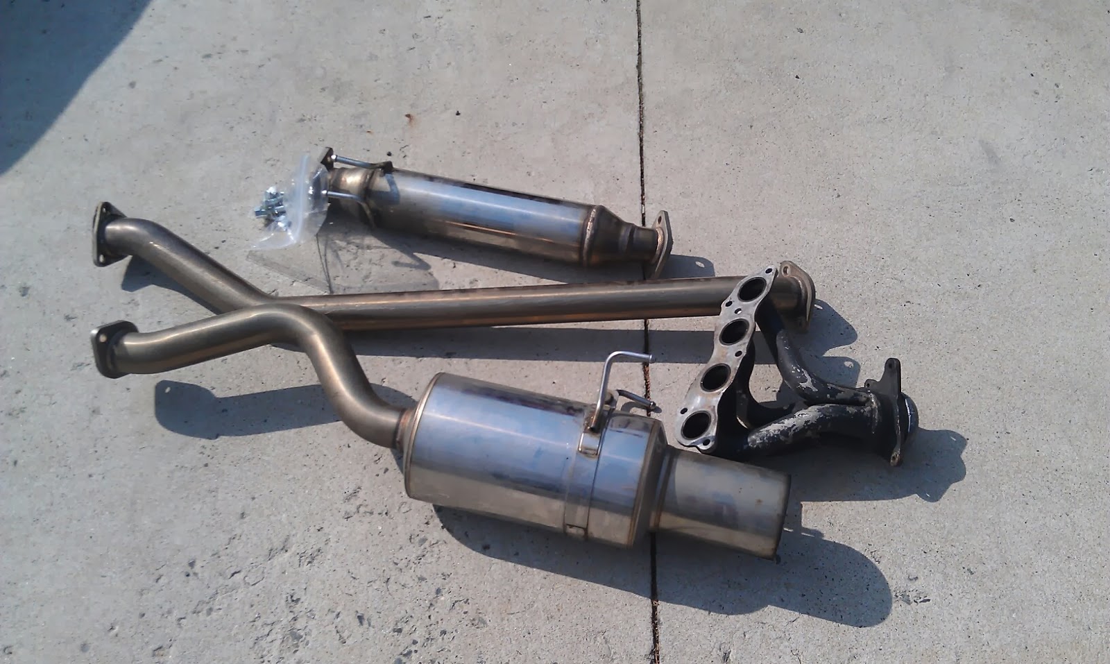

Shortly after buying the car I came across a really good deal on some bolt-ons.
I paid $300 for a full APEX'i GT Spec Cat-back and a DC Sports Shorty Header.
Then I got an AEM Short ram and painted it a Honda Silver :) :

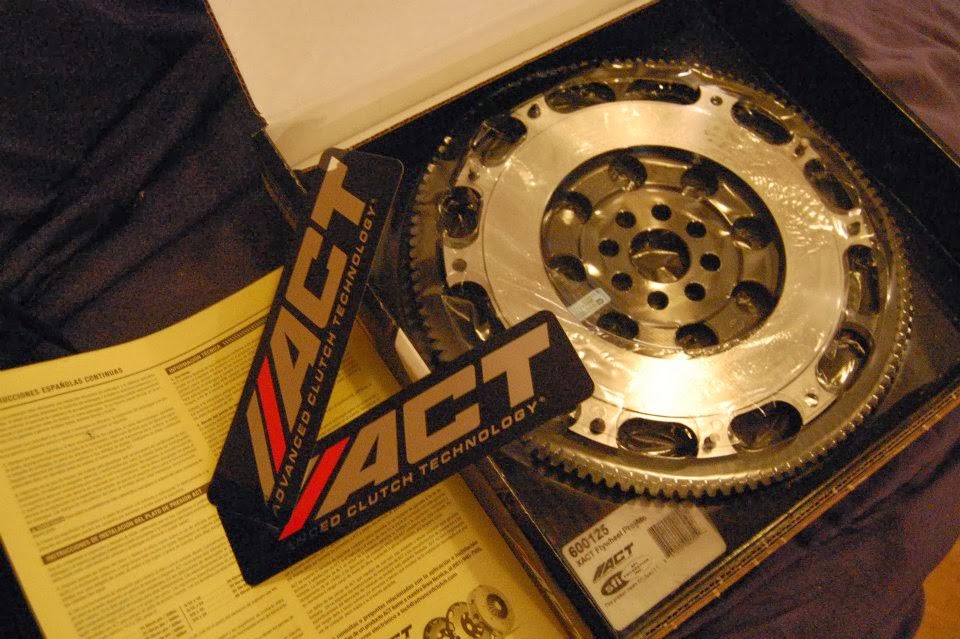

The feel of the new flywheel and clutch combo was sweet...the revs were so much quicker and responsive and the clutch was a lot more bitey.
:new_slayer:

And for a long time she stayed like that...until one day. Going to #ShrinkAllTheCars in Philly, I rolled up and some d-bag was making fun of my car because "VTEC kicked in too hard yo" apparently. And then more people started pointing at my car and saying crap.
Little to my knowledge, my rear tire popped on the way to the meet and I rode down the highway with a flat tire the WHOLE WAY. :thud:

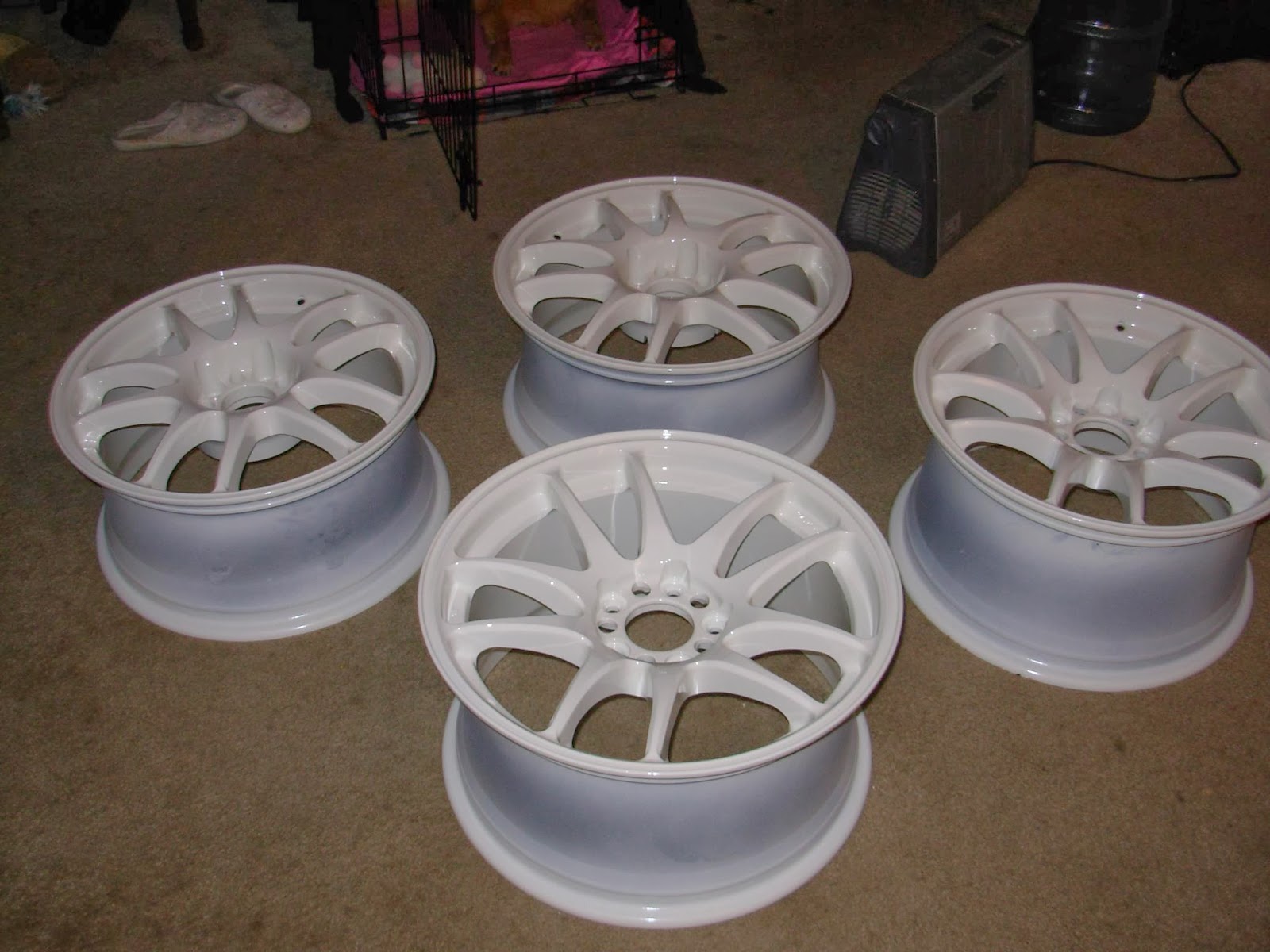

Luckily though, I was totally prepared. Earlier that month I picked up a set of staggered CR Kai's in some pretty rough shape for 600 bucks. I had them rotated on a tire balancer and the rims were not out-of-round.
Here're some pics:
And since they were all chipped up, I started looking for people to paint them. A couple of friends in the Philly area made some recommendations, and one of the recommendations was to go to Vibrant Finish out of Penndel PA.
So I did. And I got my wheels coated in championship white :)

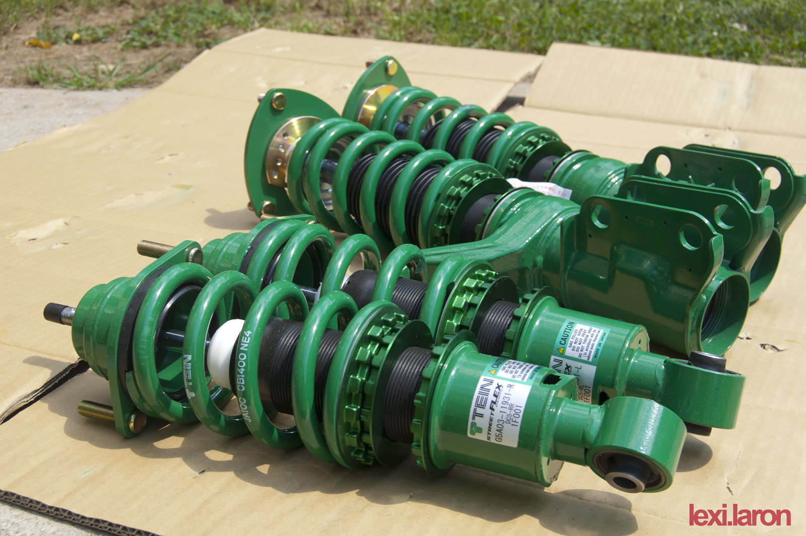

If you have a car that's not lowered, you know the struggle. Everyone is always telling you to "LOWER YOUR CAR" and you're always like I WILL BRO. Hahah. I was studying for a thermodynamics exam, and I had been thinking of how hard I always work in school and on my co-ops as well. For God's sake, I moved to another state for an internship! I looked at my bank account...thought about it real quick...and hit up Josh from N-Spire Performance for a set of Super Streets by Tein.
However, I waited for weeks and weeks to receive these coilovers and never did. I was super frustrated and I hit up Josh who was very helpful and patient with me throughout the whole ordeal. It turned out that Tein had discontinued the Super Streets and replaced them with the Street Flex's RIGHT WHEN I BOUGHT THEM. So, being the great guy that he is, Josh fronted the extra cost for the new coilovers because I did not agree to pay that much for the coilovers I wanted, and I got my coilovers in a couple of weeks.
Here's the link to me unboxing them and reviewing them:
http://forums.clubrsx.com/showthread.php?t=874466
And here are some pics of them after I got them in the mail! :D :D :D :dance:
And after I installed them :megusta:

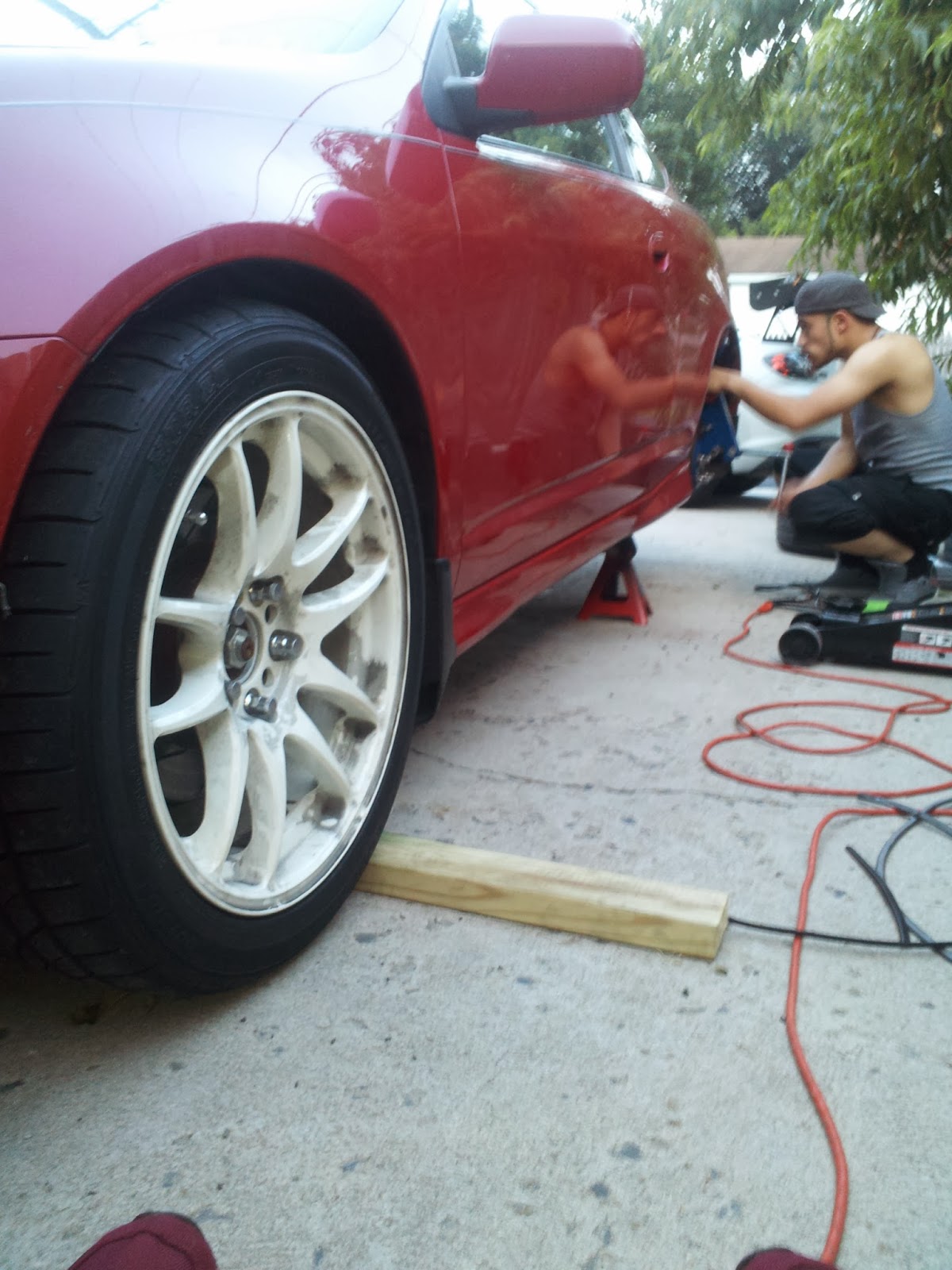

Then I had Ryan from N-Spire Performance come over and help me roll the rear fenders on this bad girl!

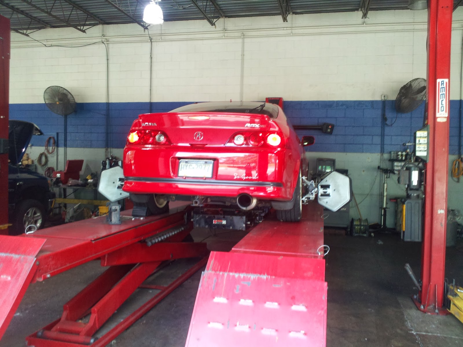

Got her aligned (hugest mistake of my life going to NTB with custom alignment specs):

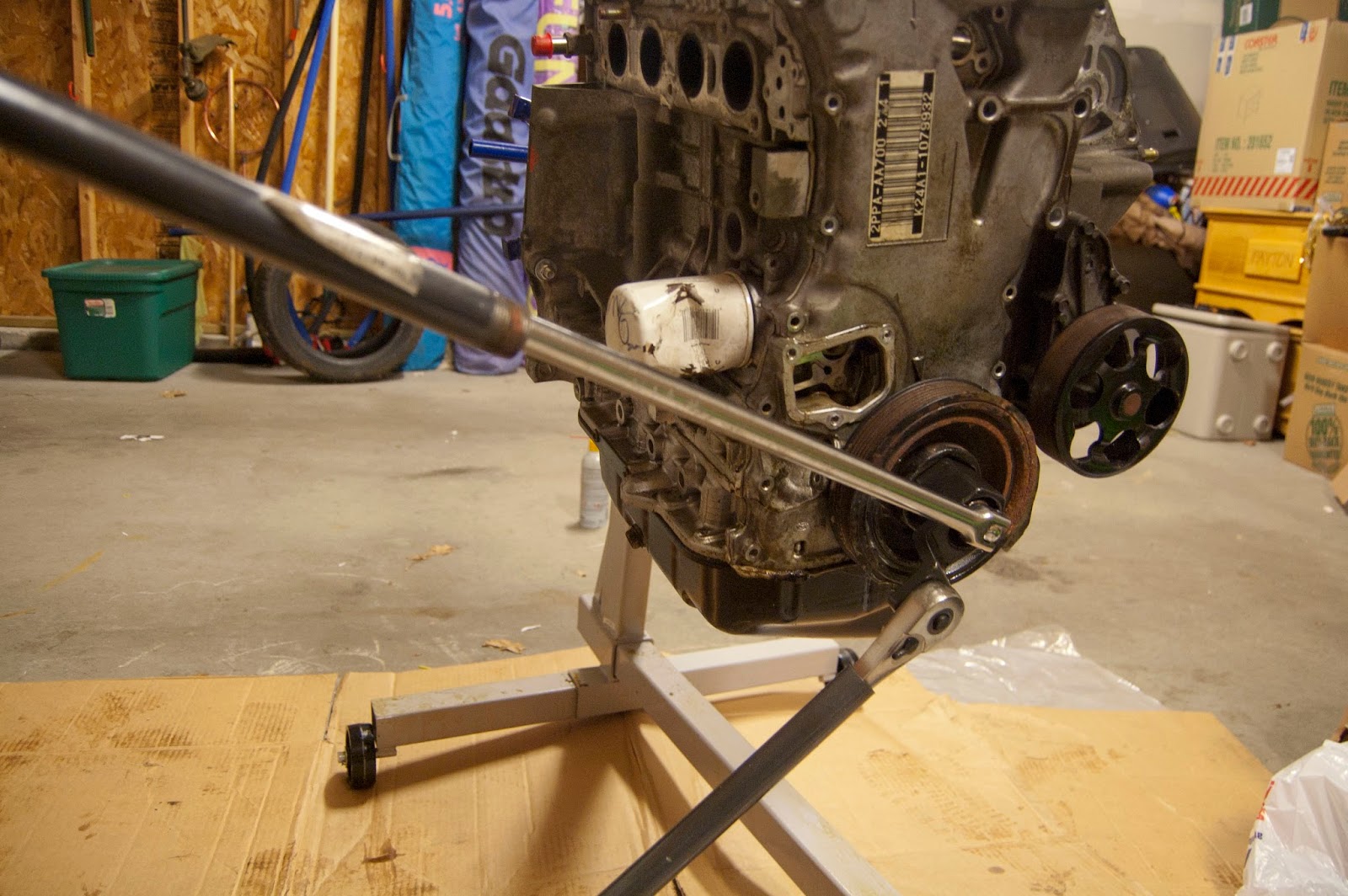

So I started by mounting the engine onto the engine stand using a workout bench, some weights, a roommate, one metric trans bolt from ACE Hardware, and two random-ass bolts from Menards :lolface:
Rusty-ass flex plate:
Then I took a 36" long cheater bar and a 26" long breaker bar, a second pipe, a ratchet, and a Honda crank pulley tool and made that crank pulley my b*tch!

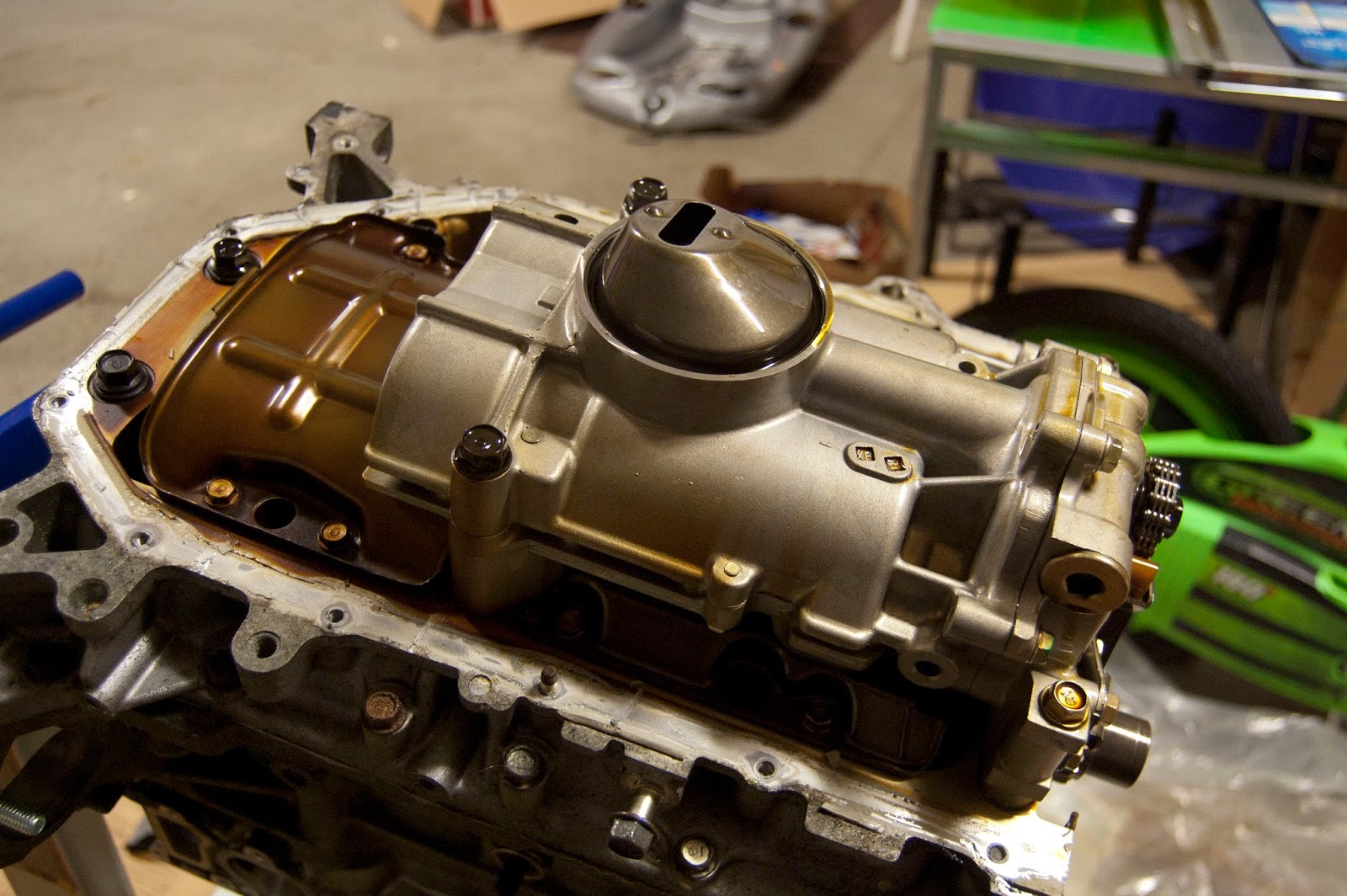

Here's the K24A1 oil pump. It's pretty bulky compared to the K20A2 unit.

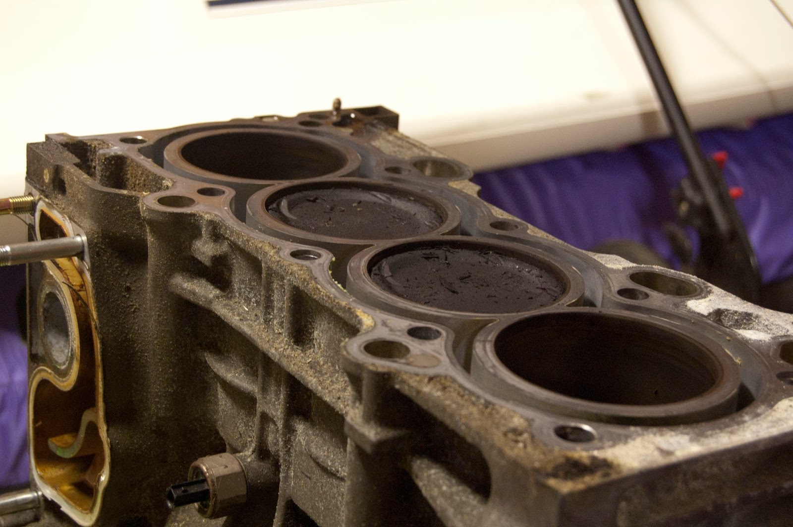

This is me taking the cylinder head off:
Then when you take the cylinder head off you generally get to what's under it. PISTONS ahhhh! Hahah
All of the pistons looked okay. None of them showed signs of being exposed to detonation.

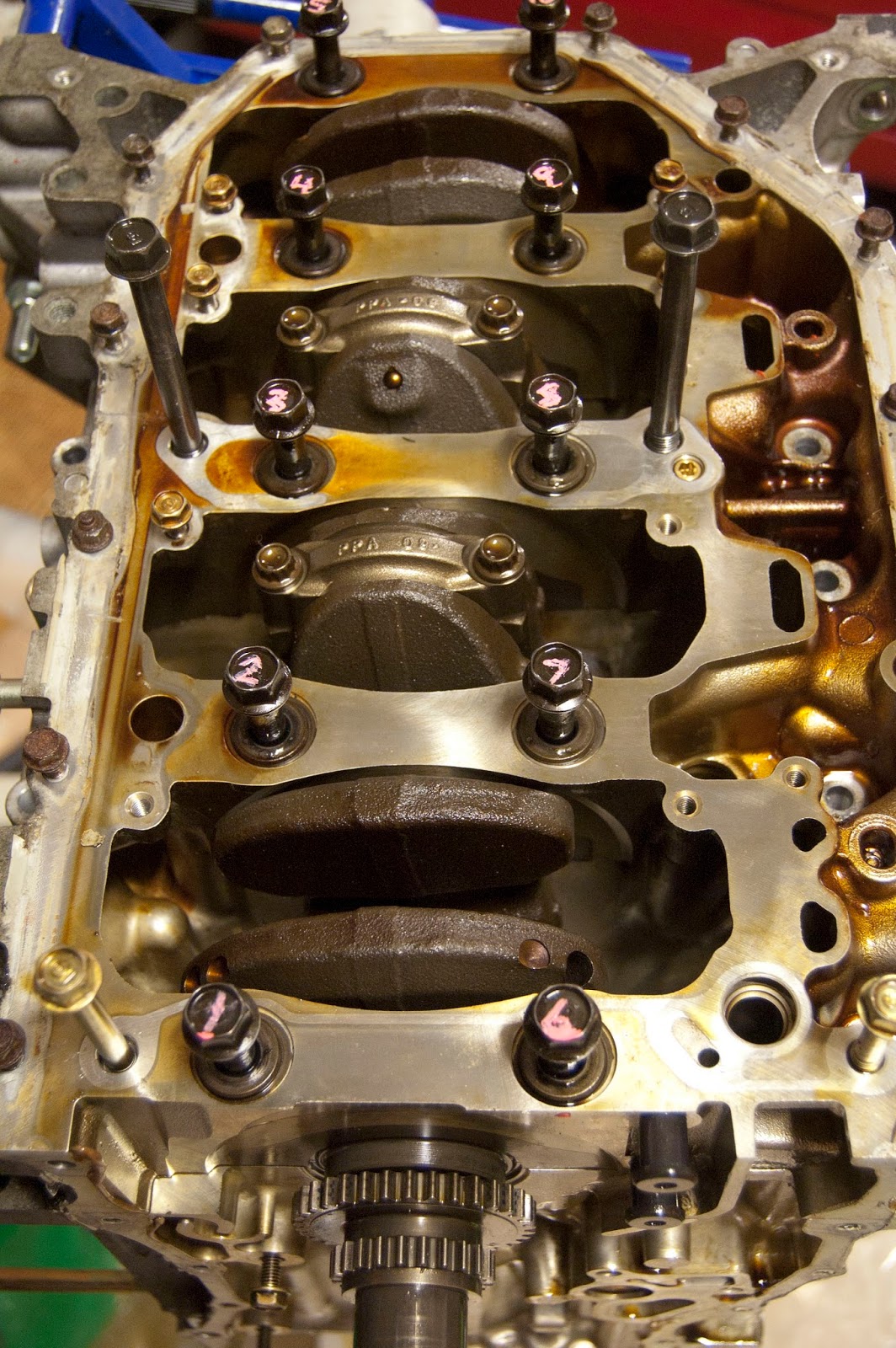

Then I got to taking off the girdle to inspect the crank.
The bearings were clean. Which is good...not that I'm going to re-use them when I reassemble but it's nice to see oil was making its way to the journals.
Then I looked at the main crank journals. All of these looked clean and this is even better since the block and crank will be the only components I am re-using here.
Voila
