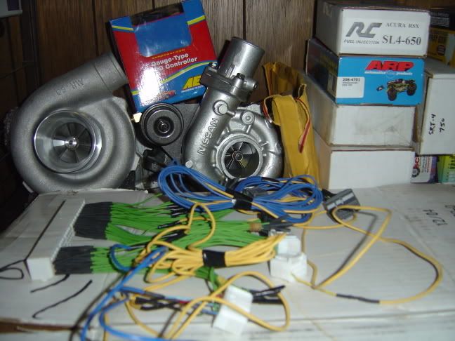

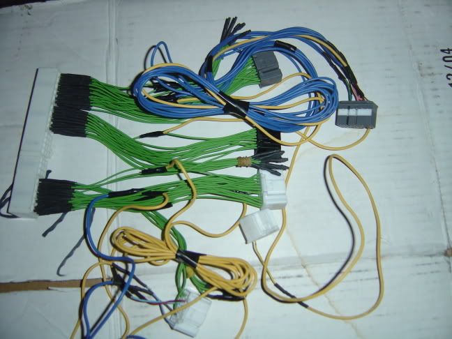

sup peeps..well just want to share this with you all. the testing began 2 weels ago..and i started it out with just basic wiring, connecting to the necessary sensors and pin out..at that point the car fired up with the k24 calibration and drove perfectly..as hondata stated before no gauges would work nor the a/c..finished the harness in 2 days with all the testing..so now everything is working including the a/c which is important to me.
here are some pictures of the harness . its a lil messy bc of the long wires..had to make it long since its going to be mount somewhere else in the car.

yes this harness allows you to use both kpro and stock ecu at the same time...and yes i'm trying to build more harness and sell them to the public..i made an order thread where people can sign up to buy the harness on gen7accord.net but no one is taking a bite yet..i need atleast 5 people to sign up before i can order parts as they are expensive if i dont buy bulk...so in the future you can always hit me up and i can build you one..if i don't order those parts..i'll probably buy broken harness or what not and salvage what i could and make another harness...

the car drive perfectly just like stock..kpro is driving the car..stock ecu is only doing all the reading and put it out to the gauges and contolling the a/c...i upload the k24 calibration that was tuned with race header and intake..from the datalog it showed that i'm running a lil rich..but nothing i can't fix..just tuning.
