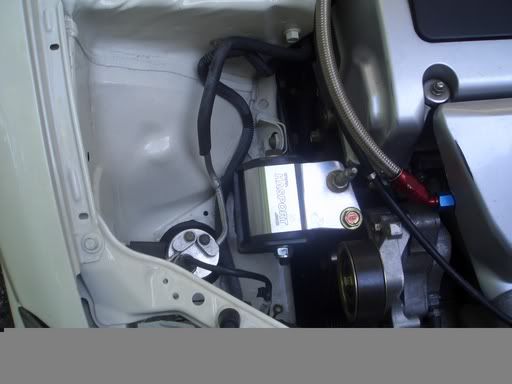

PS and AC were kept without too much fuss:

Pics of my AC:
(old pic) I have now put a bigger fan...
The AC clutch and Pressure switch are jumped... (wires)
4

For the EG, we found out that the PS pulley sits too high. You will need to mod the hood to clear. Basically u resue the EG's PS steering fluid resivour and plumb into the stock hoses. same for the AC, use a slim fan and plumb into the stock hrd lines.
