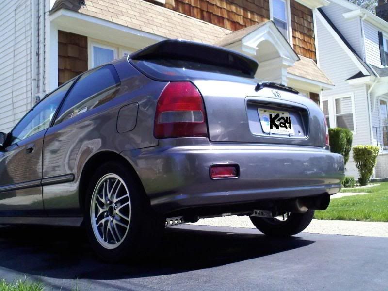

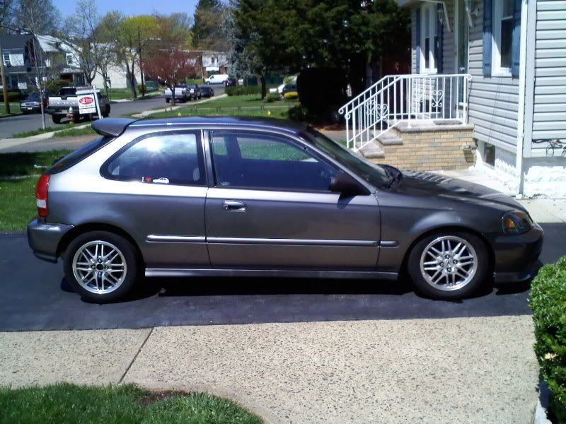

wats up Korg i just got a tsx long block k24a2. its goin in my ek hatchy. any info on parts for the swap will help . i will post pics as parts come in. here is a pics of my ek .. its a slow build but im gona do it the right way am not a low baller!
