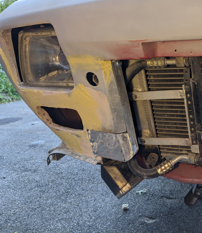

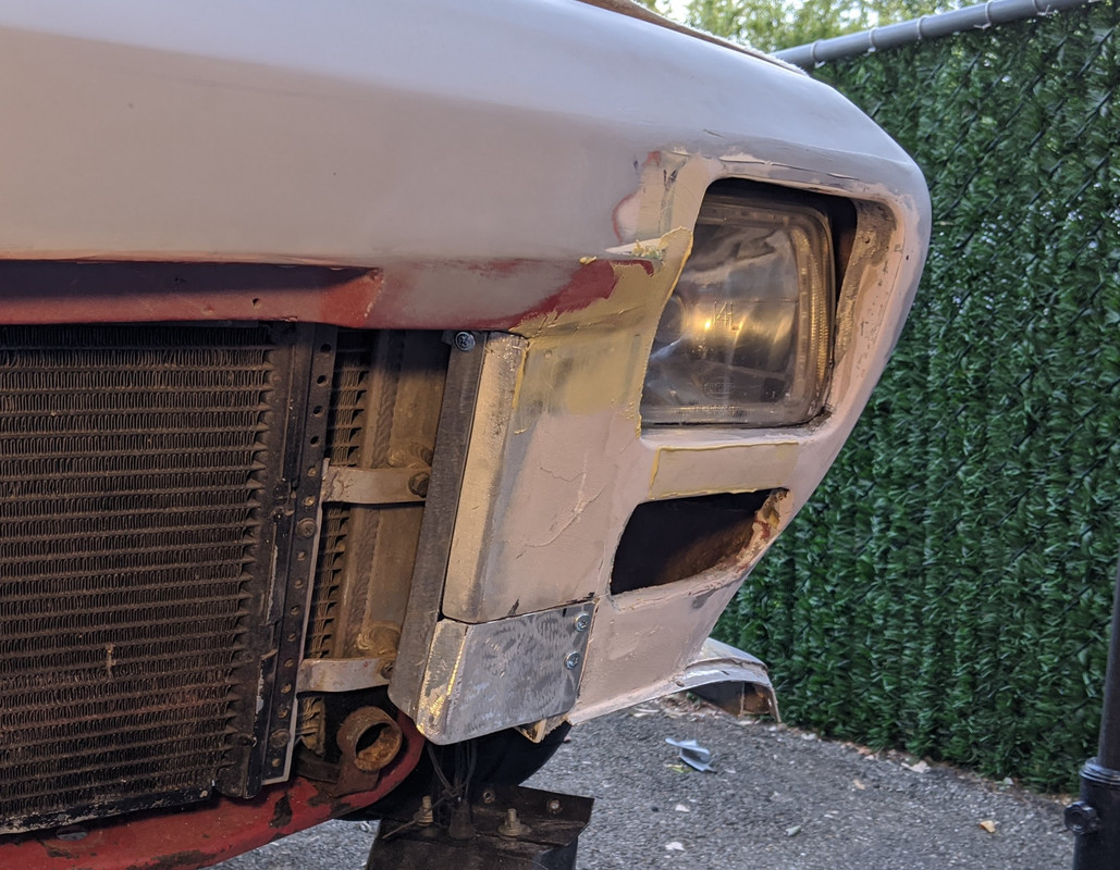

I fabricated filler sections to streamline the nose/spoiler connection. The details around the spoiler/vertical overlap had to change. Cut back the existing panel to provide about an inch overlap for bonding the new piece flush with existing.
difficult to tuck the spoiler into place as is - the inner corners interfere with pivoting the uprights under whilst overlapping the outer ridges
sections bonded so I can move on to filler work tomorrow
spoiler uprights cut down to 2" to get it to tuck under. Still may need to angle the inner corners uphill to ease the fitment.

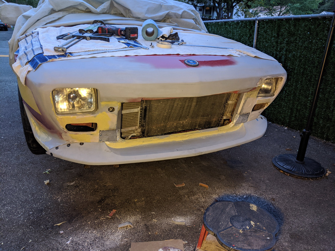

Also checking the marker/directional apertures. They needed several add/substract stages to get a better outline
then after that, some U-Pol inside the headlamp opening surfaces
then some filler primer to check overall lay of the land
found I needed to build up the left tuck under the marker - it sat back too far
Spoiler overlap - I need to build up the seams on the body side of the outlying junctions - I have to even out the gap along the rivet area
Had a couple hours after work, and the rain stopped, so I futzed with the spoiler/fender connection, and an air guide. My grille attachment has to change now, with the new inner verticals the grille won't align with the upper channel I built into the nose section
I may build up the spoiler side of the upright to taper it out to the overlap. There has to be a gap to allow for pivoting the spoiler in place.

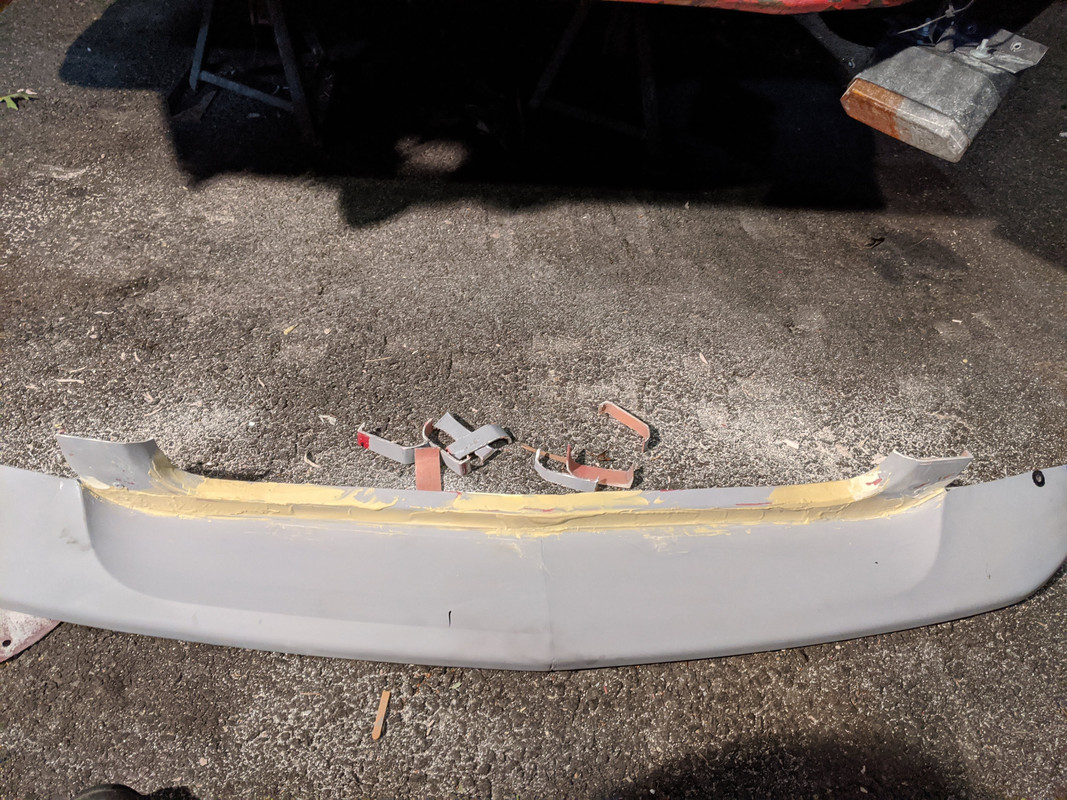

Worked on the spoiler after work today - easing the transition from it to the fixed upright. Couple layers of bondo into it, some spot putty work also
had to add more here
Then I had to even out the center strip to eliminate an extra step that occurred when I bonded the Greenwood panel to the Volvo cover
Still more detailing to do. Now that the main form is done, I need to remove the spoiler & refine cut back & refine the mating ridge, and the center line. This part of the work I dislike intensely, it never ends. Fill, sand, fill, sand, putty, sand, prime, sand, putty, over and over :(
