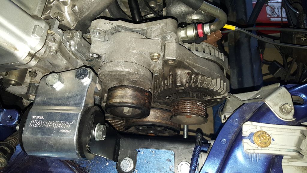

I have the K24a tsx 6 spd swap. Who has done a swap with THIS engine. K24a. I can't find much info at all. I'm stuck on my accessory belt. I was gna grab an ep3 idler pulley and use the 52" serpentine belt. That's what I'd read works. While looking for the oem pulley I noticed ktuned adjustable ep3 idler pulley kit w/ belt for ALL k24 engines (supposedly). Ordered that and
The ktuned pulley doesn't line up with the rest of the pulleys. ktuned said I have an odd engine and sounded surprised when I told them it was a jdm engine. So I need to figure out solution for the accessory pulley. Do I just get an oem ep3 pulley and if so do I get a US or JDM ? Or does anyone know of a kit that someone makes tailored to k24a? Or even know of anyone who has the K24a tsx 6 spd?

It looks like it lines up the same as the other motors.
I also have the ktuned ep3 pulley but with a/c. i took a string to measure what size belt i needed.

So I fixed the issue. And they may appear to line up but they def dont. And yea I thought about a spacer but if I did that the pulley would have hit my motor mount. So the solution was to switch my JDM water passage, water pump, auto tensioner for the USDM versions. I did that and it worked as shown in the image. Only problem after that was my JDM alternator isn't compatible with the new USDM parts. The JDM alternator bolts run sideways. The USDM alternator bolts straight, directly into the water passage. So now I'm gna need to get a USDM alternator and my accessory belt issue will be officially solved. Thank you guys for the help and suggestions!

I'm having the same issues. When you purchased the usdm water outlet did you use the tsx tensioner? This is all in hung up on and look looking to finish .
