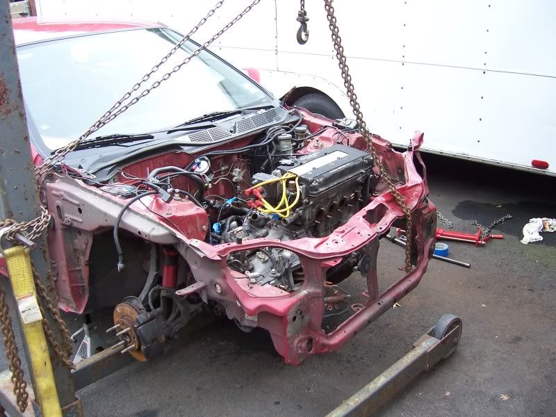

was good k20. i got an ek that im gonna put a k24/k20 in. i got an accord block with a type s head. im working on all the interior and exterior things rite now. at this point im waiting to put the cage in. the dash is out, the harness, and the heater core is all out. let me kno wat ya think :cool:

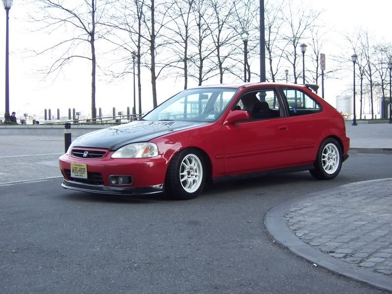

how it looked before the bullshit happened:(

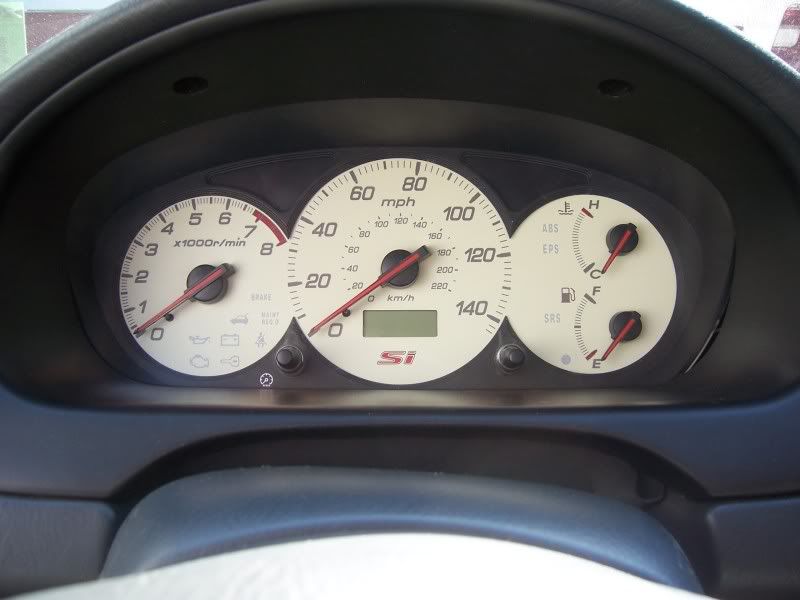

i had a working ep3 cluster in it too. only the temp guage didnt work

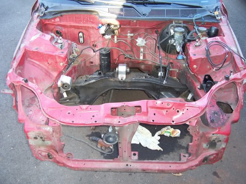

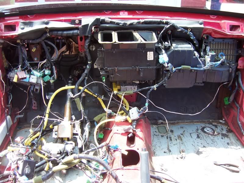

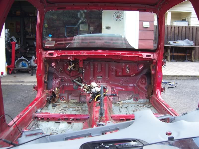

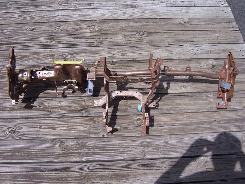

took the dash out, took everything behind it out...

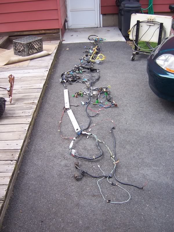

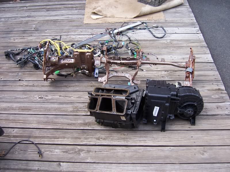

wire harness was a BITCH :down:

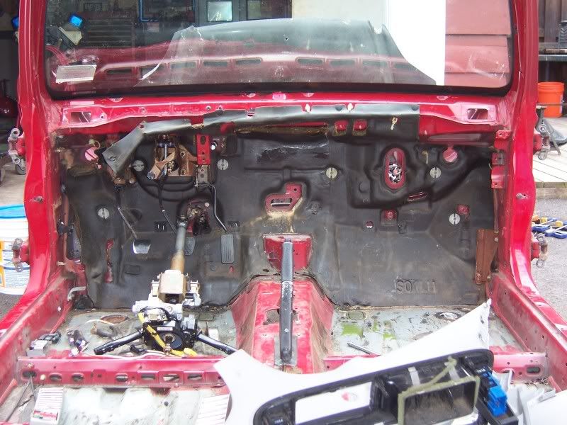

cleaning up...

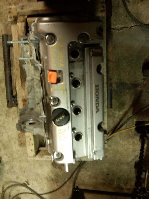

the motor..

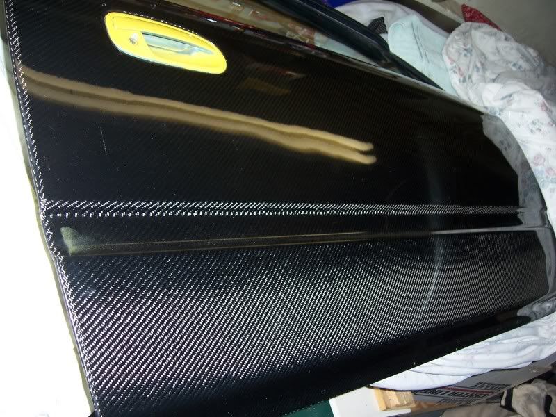

my doors :cool:

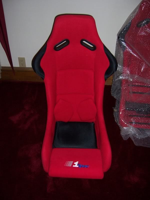

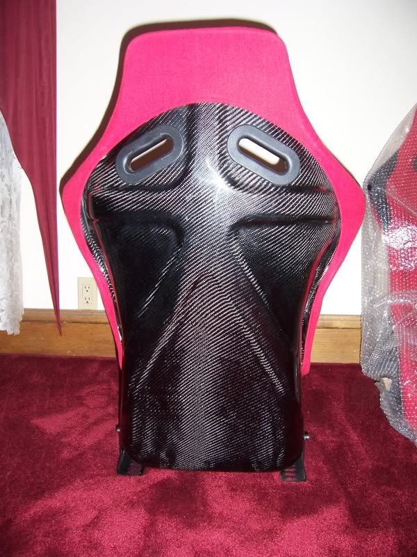

my seats :p
im waiting on my roof:rolleyes: and steering wheel. the cage is next, gotta put the eg subframe in and finish the suspension, then paint, then ill get to the motor. im gonna need help on the wire harness im not gonna need anything like the windshield wipers, srs, the heating system. only really need head and tail lights and turn signals. anyone make a custom harness like this? let me know what u guys think

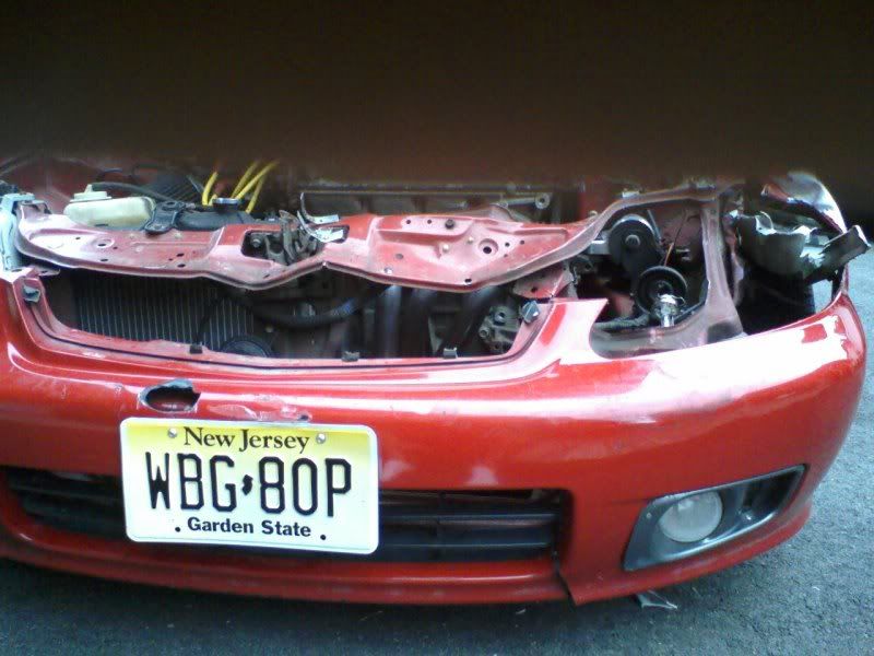

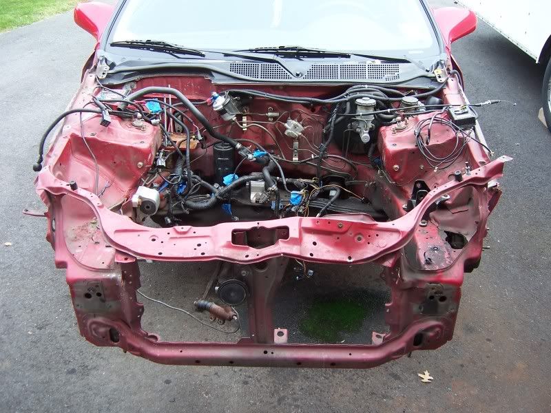

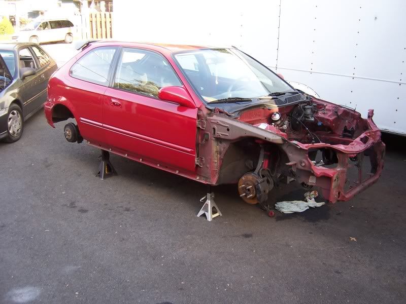

You came out lucky. All you ned to do is put ona new radiator support.
yep thats all i gotta fix really. all i gotta do is drill out the spot welds that hold it rite? i might just take it off myself to save some money at the paint shop. and the same day that happened, i spent over a G at MB racing on parts for the gizzer...guess it was a sign??:confused:
Lmaooo. So tempting to make a mockery but I think I will pass.
The rad support isn't hard at all. Clean the front so you can see all the spot welds and get a 23/64 titanium coated drill bit from any locksmith and it's a breeze. :up:

my dad chopped some of the bent radiator support out. waiting on the spot weld removers now for the rest. but we are getting close!!!!!!!!

thats a type-s head? did you switch out the oil cap? mine says 5-W30 and a bunch of tiny lettering around it. and you already had swapped valve covers for the one that says "HONDA" instead of "Honda Motor Co"?
just asking. i saw that and was like "wtf?" i was just hoping you didnt get screwed or something. but the build looks like its going to be nice and fun. :)
