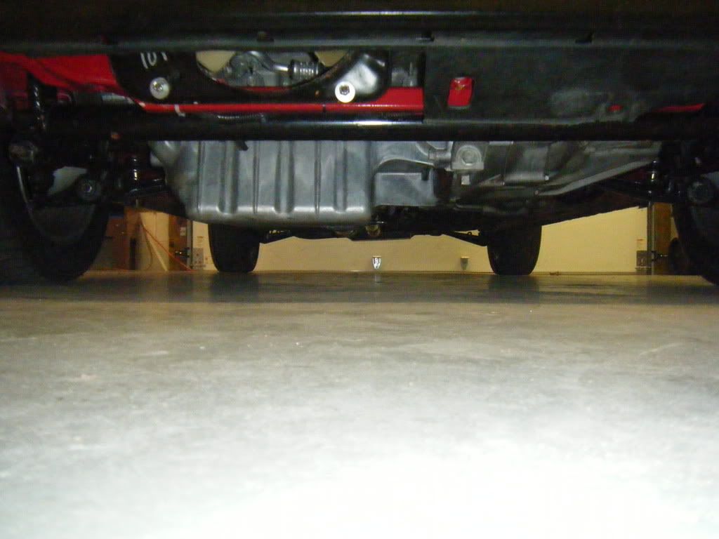

this is my father in-laws car, I've been giving him a hand with it for a while. trying to keep the stock look...
z3 swap with lsd, and a/c
1997 cbr 1100 radiator,
custom cross member, need to sand off the surface rust..
type s cluster, still trying to figure something out with the temp gauge, but everything else works.
the shifter
custom made header
rear mount
driver side mount and homemade cable to hydro conversion
passenger side mount
front mount
we bent the radius rods and made mounts to bolt up where the factory cross member bolt holes are, reason for this is for ac pump clearance.
the shifter
custom made header
rear mount
front mount
