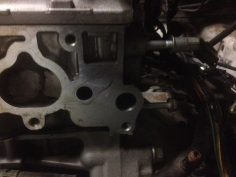

My question is Would i prevent or hurt my water pump from cooling the motor properly, if i block off the upper coolant housing where it used to be on the side of the head.
and add a swivel ktuned housing to the front. here are pics of the head
that is where i want to put the housing on the front. ^^^^
stock oem coolant housing^^^^^ Want to block it off their and use the front for my radiator hose. How would it limit the radiator and flow of cooling if any. Thanx for any help.

U need to tap the coolant port on tge front of the head to go back to the thermostat.my question is can the egr port on front be left unpluged?

That's how some the guys here in south Africa block the heads off on water side
