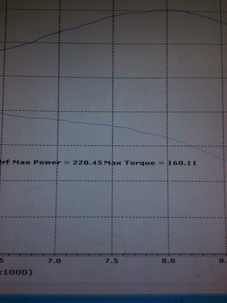

We got to 212HP and 155ft lbs once Randy of RSTech tuned the thing. Soon as he was done and letting it cool off, Figured what the heck and installed an Invidia Q300 70mm Exhaust system.
The 220 and 160 was really good. I have an RRC and Accord TB I want to install, so I think I can get to 165ft lbs and close to 230hp. My overall goal is 230-235 for April and 250 for August. So shouldn't be a problem. Thinking this setup would benefit from some OEM TSX Camshafts (autofair honda sponsorship maybe) haha.
