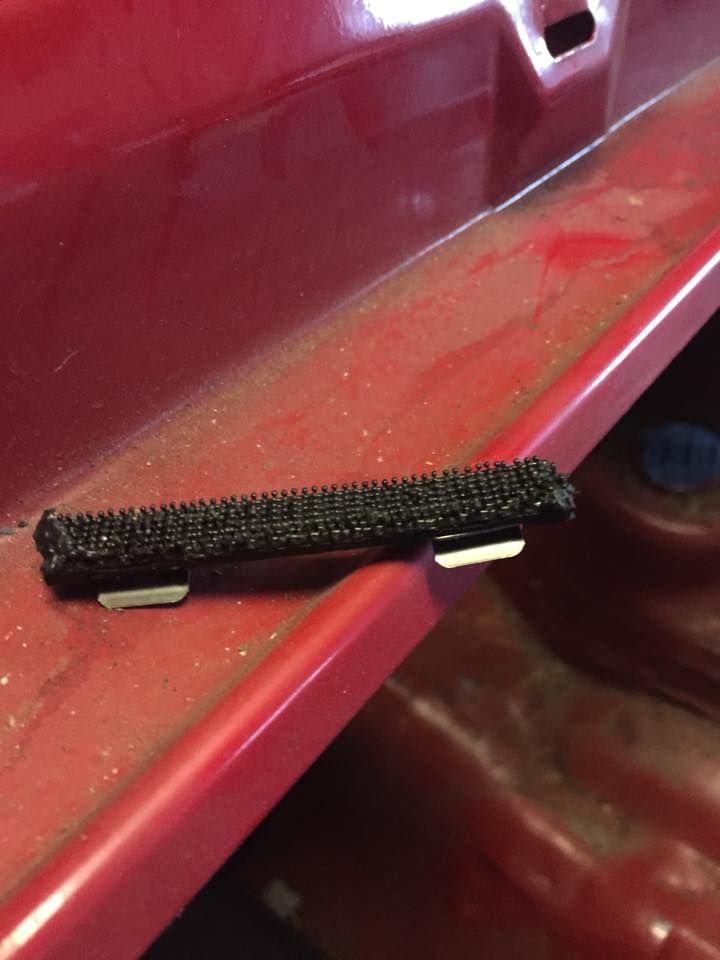

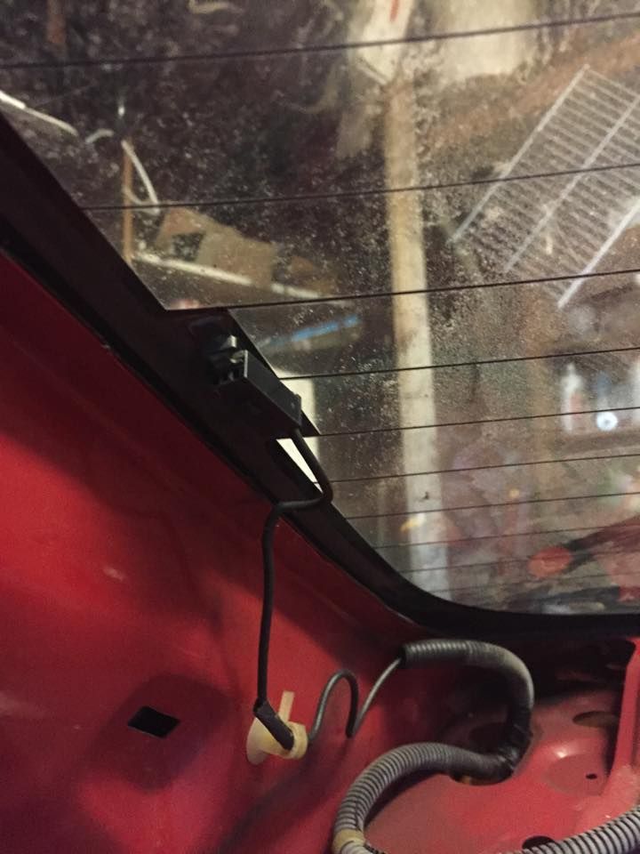

First you must remove all the rear interior panels, speaker deck, brake light, headliner, defroster and these two tabs.
After dropping the back portion of the headliner you'll see these, I took them out for good measure: not sure if it was necessary.
Here is what they look like once removed.
Remove defroster plugs, there are two; once on each side.

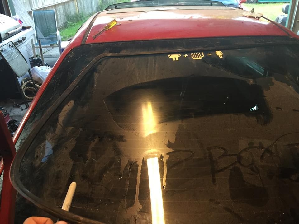

Now you must un-clip this trim piece that is under the very bottom of the window. It is held in by push tabs, pull the piece up and be careful to not lose the little tabs; you need them to reinstall this piece.

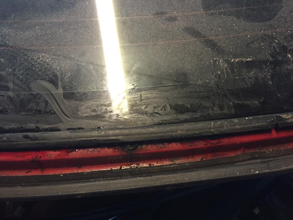

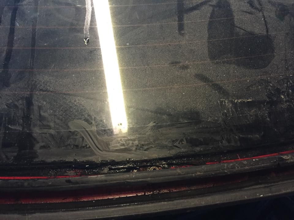

After you remove this you should be looking at the rubber trim and window glass. What I did was get window cleaner and a soapy solution and spray it directly in all the seams of the window. I wanted to loosen up any dirt and grime, after words I got a blow dryer and heated up the bottom portion.\
Once you feel like the rubber trim is a bit more flexible it is time to pull it off, SLOWLY!!! I pull a bit off towards the back of the car, NOT UP!!! Pulling straight up may crack the corner of the window, thus ruining the whole process of trying to save your WINDOW!!!
Pull slowly and use the soapy solution and heat when necessary, do this around the whole window, take your time!

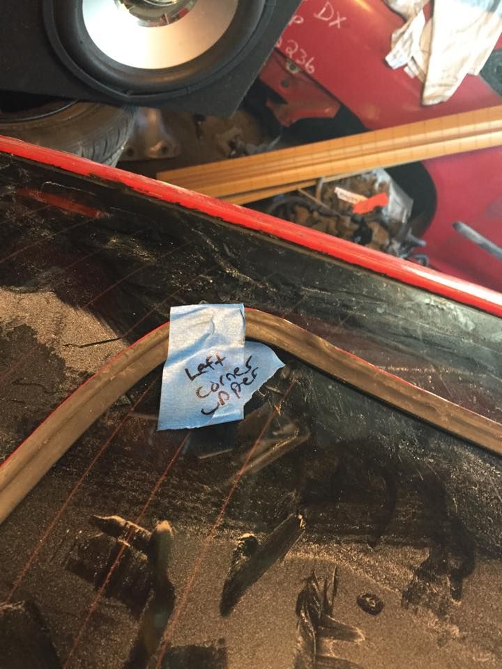

After you pull the trim off the entire window it should look like this, I also taped the corners and labeled for future installation.

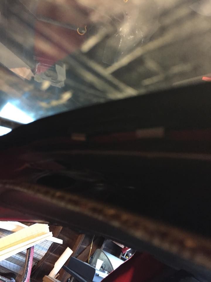

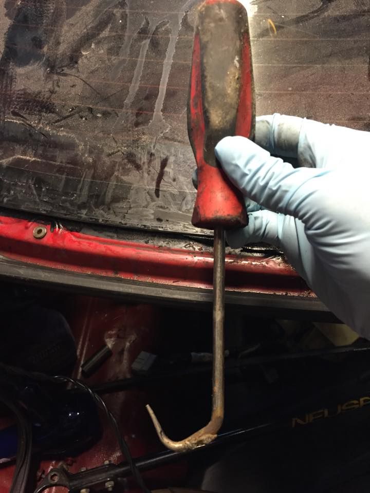

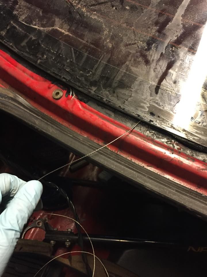

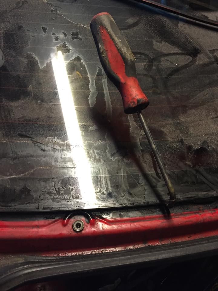

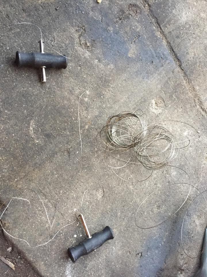

Now that the trim is off, it's time to use your Harbor Freight Window Remover Kit (Fancy Piano Wire) to cut through the adhesive that is holding the glass in place. First you must poke a hole through the adhesive and run the wire through, I poked my hole in the bottom because I had more room. You can use a knife and heat up the tip to pierce through the rubber quicker.
Started with this but ended up using a knife.
Here is my Harbor Freight Kit ($18)
Poke the wire through

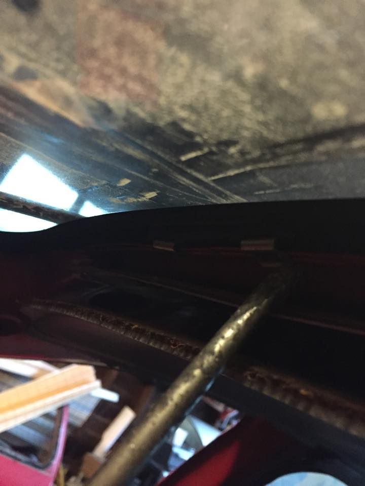

Now get a friend and go in a sawing motion, cutting around the window.

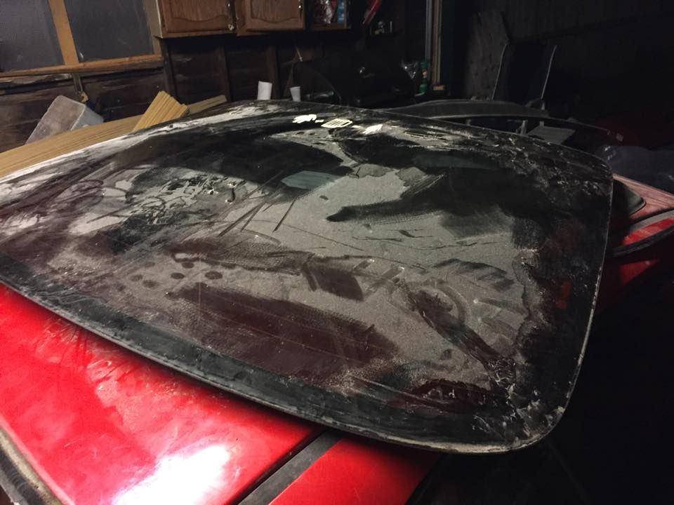

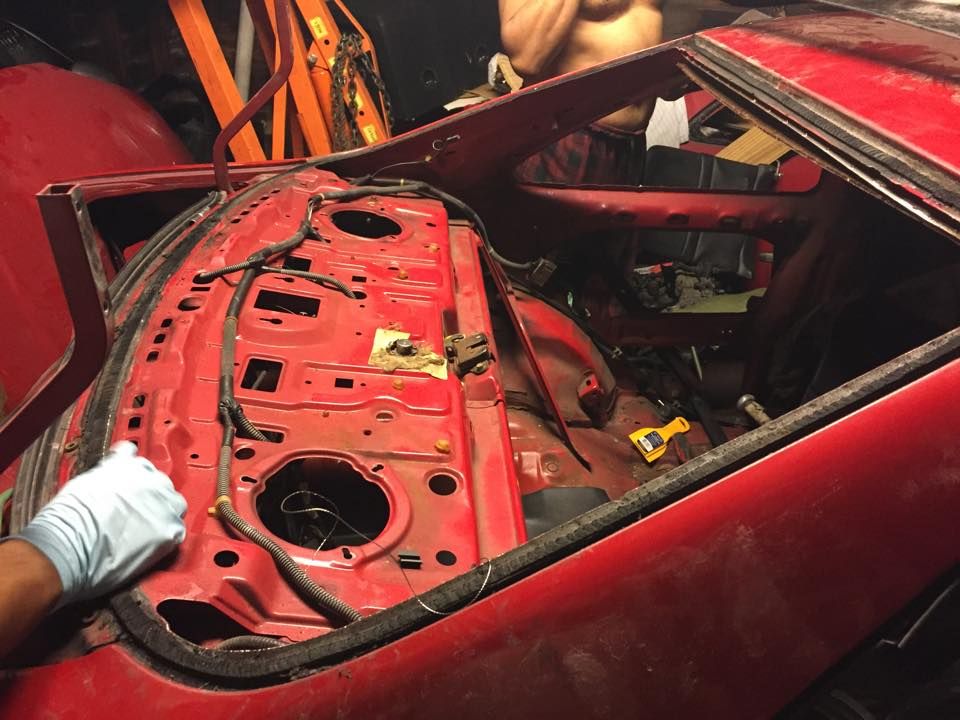

After you've made your way around you should have this!
and this!
And one of these!! :coleman:
