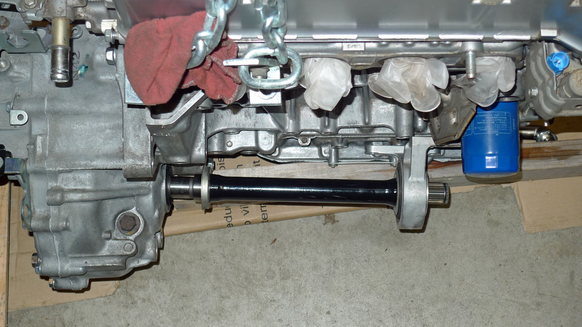

Is this your problem? sorry if it doesnt help, my block is a k24z1 09 crv. had to use the accord/ tsx mt midshaft because of well... you can see.
accord/ tsx midshaft:
a2 midshaft:

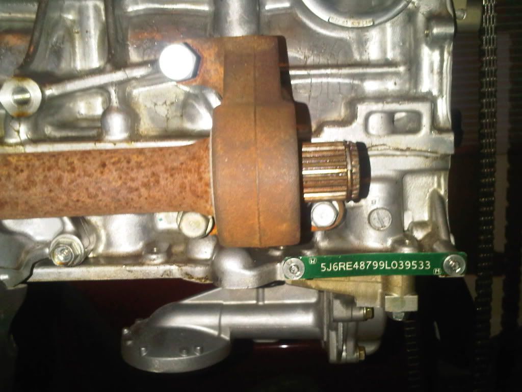

The issue I'm having is shown below...you can clearly see that the halfshaft isn't parallel and is being pushed outward. Again, if I rotate the bracket away from the block it will thread easily with a rubber mallet.
Looks like I'm in the market for a manual halfshaft:rolleyes:
