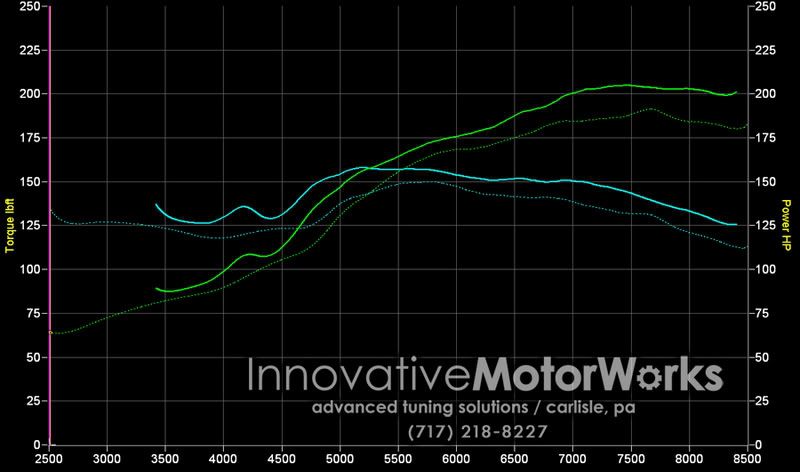

Here's the comparison old vs. new.
Stock k20a2 swap. 11lb flywheel.
Solid line is SSR replica header with 2.5" collector merged to a 3" exhaust Kteller exhaust and maganaflow oval SS muffler. Short ram intake. No RBC.
Dotted Line is Hasport Budget header with 2.25" collector with a 2.36" apexi ws II exhaust. Short ram intake. No RBC
Old setup numbers were 193whp and 152tq
Final numbers were 205whp and 158tq. Vtec set at 4100

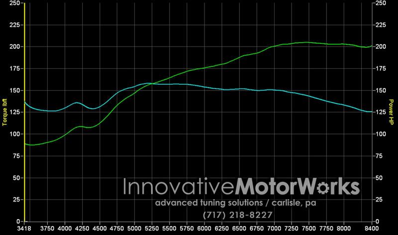

And your final graph:
692 Posts
vtec at 3800? why this low? why not putting it at 4500 when your curve is going down?
Tried VTEC at 4,300 RPM initially, and created larger dip.
I attribute the little bump up in torque @ 4,100 RPM to intake length. It's a short ram that's maybe 12" long.
- Derek
