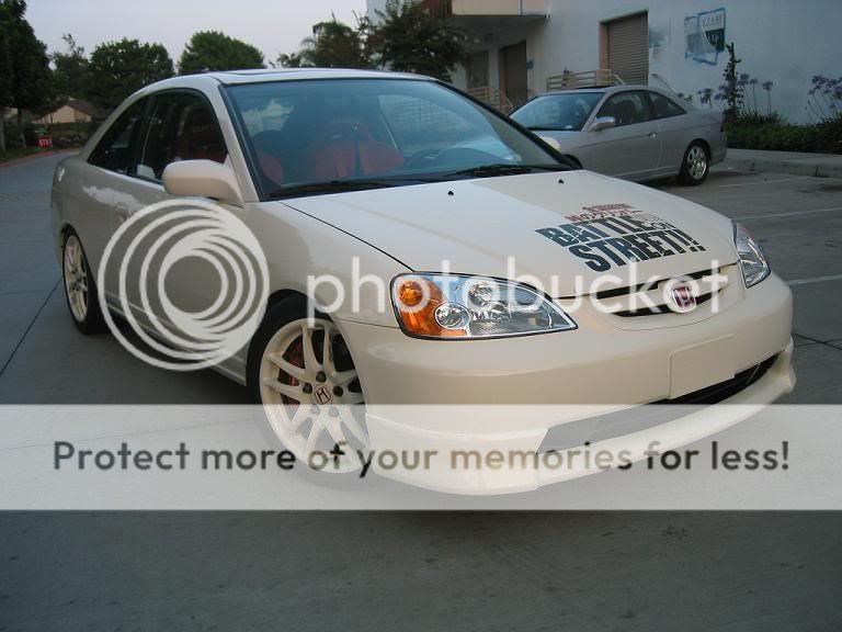

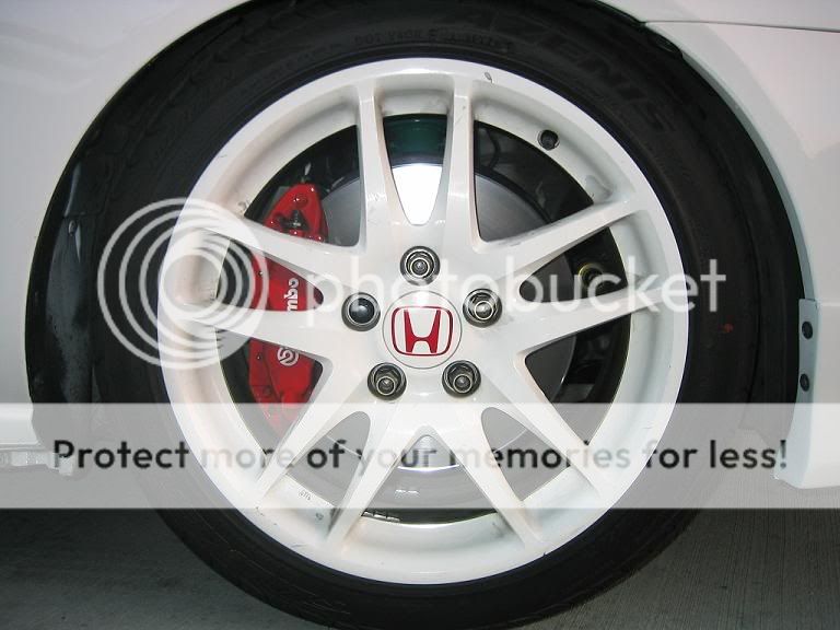

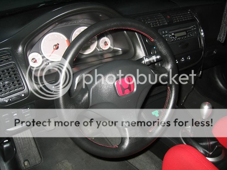

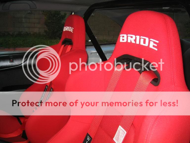

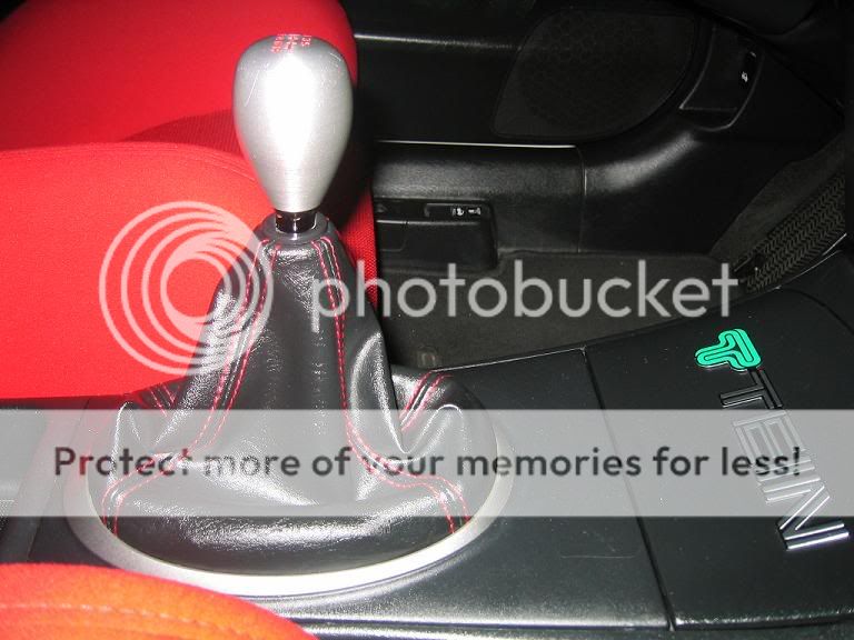

I finally got my car done....it took me about 9 months to get to this point from receiving the Front Clip by boat and swaping the K20A motor, DC5 5 Lug Conversion, DC5 Brembo brakes, DC5 Steering Wheel & Shift Knob Bride Brix II seats, and finally the championship white paint job.....Im currently thinking about swaping into a K24...dont know if i should yet but before anything im planning on geting HOndata's fully programmable ECU....im still running the JDM ECU and it suck....has a speed governer that cuts me off at 115mph....
Well im trying to stick to the whole JDM Type-R theme so I dont want to do any body work or put on any crazy ass kits....so dont recommend any body work but im open to hear some suggestions on the engine set up?

This is awesome. This is exactly what I want to do with my EM2 civic. I know there are some hasport guys part of this forum...can you guys let me know what to do? I have an automatic EM2 civic and if I'm not mistaken, you guys did the swap for an automatic EM2/EM1. I know about all the main parts for the swap, but I was wondering, what you did with the center console. Would a DC5 center console fit? Would an OEM DC5 peddle setup work? Thanks.

We used the 5 speed shift boot for EM. It bolts right in to the console. We used an RSX shift mechanism. And we used a DC5 clutch pedal assembly, master cylinder, resevoir and lines.
