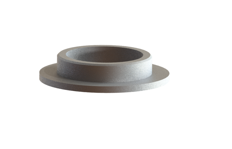

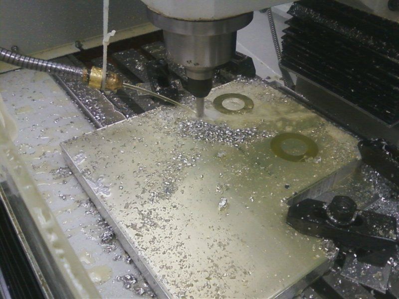

With my CAD drawing and a little help from a machinist, I made these spring seats. Took about 6 hours to finish all four of them.
A lot of material removed

This picture shows just how much of the spring was supported by the original TEIN seats/adjusters. :down: to TEIN for trying to make all their kits fit one type of seat. Now all my springs seat correctly, and are positioned true to the center.

I have the CAD drawing, so if you want it I will send your way.
