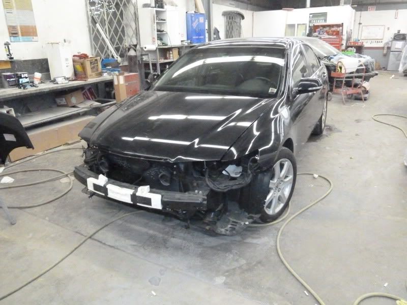

This is how the car sits now at the paint shop.
Why did it go to the paint shop? Well I live in the north east, where the salt hates cars and ruins lives :down:. There is rust starting to form under the doors and side skirt area. I freaked out and sent the whole car to get painted before the rust causes any damage. I love the car and I want to keep the car for a while. Maybe turn it into a weekend toy soon.

Stopped by the shop the other day as the car was getting ready for paint (sorry for the cell phone pics). The car has no trim, handles, not even a windshield. It's getting new trim and windshield along with the paint. My wallet is hurting :silly:.
My friend Ryan doing his magic.

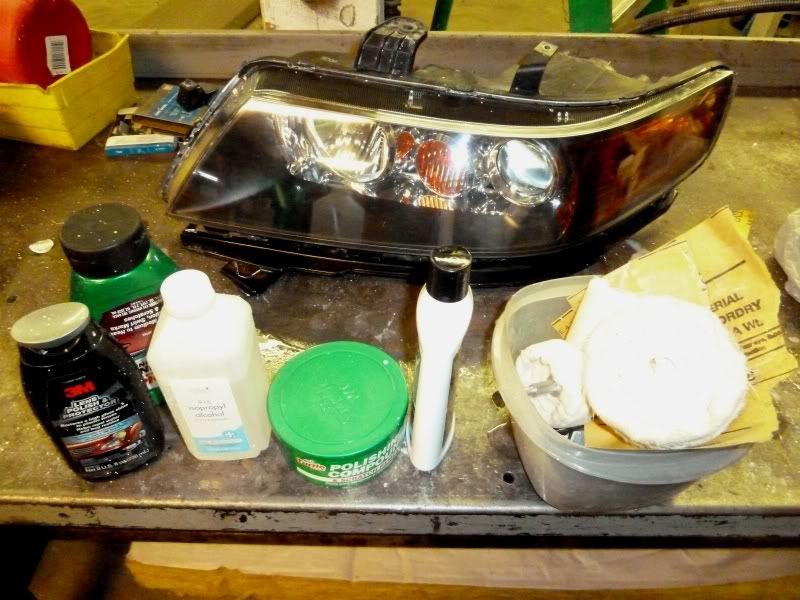

While the car is in the shop I thought I would work on the headlights. They were in very bad shape. Years of NH winters and highway driving did damage to the lights and really ruined the visibility of the HID.
I started with 400 grit, then 600, 1000, 1500. I will hit them up with compound and a buffing wheel in the morning.
5
Finally finished the headlights, and I am really happy with them. I had to hit them up with 2000 grit, followed by 2500 grit, 4 stages of rubbing compound, 4 stages of polish, then 3 stages of 3M lens polish. I used alcohol to remove left over contaminates for every step. Now they look new again.
