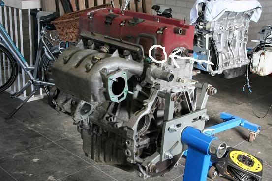

I started the car one day and thought it was idling a bit higher than normal,
Popped the bonnet and noticed a hissing sound, so i knew there was air escapping somewhere,
I traced it back to a broken t-piece that connects via a rubber pipe to the stock air intake,
So for the time beeing ive just tapped the rubber up and its seems to be fine,
But i woul like to replace it with a new one but have no idea what its called,
Pic bellow is it circled,
Also is it a nessicity to have to use this, im not running a stock air intake?

not necessary just plug whole
3,119 Posts
Its an idle air valve. It opens when its cold to allow more air for idle. It will close when the motor reaches normal temp.
