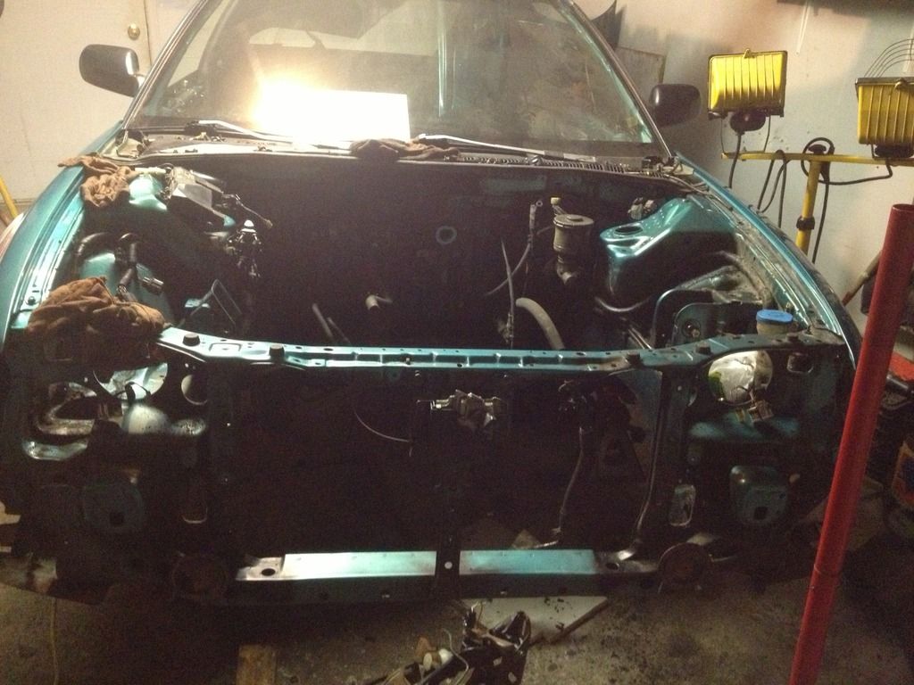

so as some as u guy know i am building a k20 da for street/lapping
the car is a 92 rs auto and the motor is a k20a2 03 here we go boy and girls

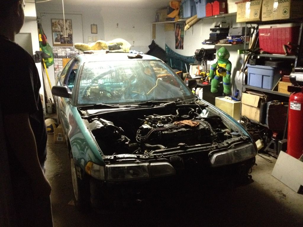

lol only 3 hour after i got home from buying the car

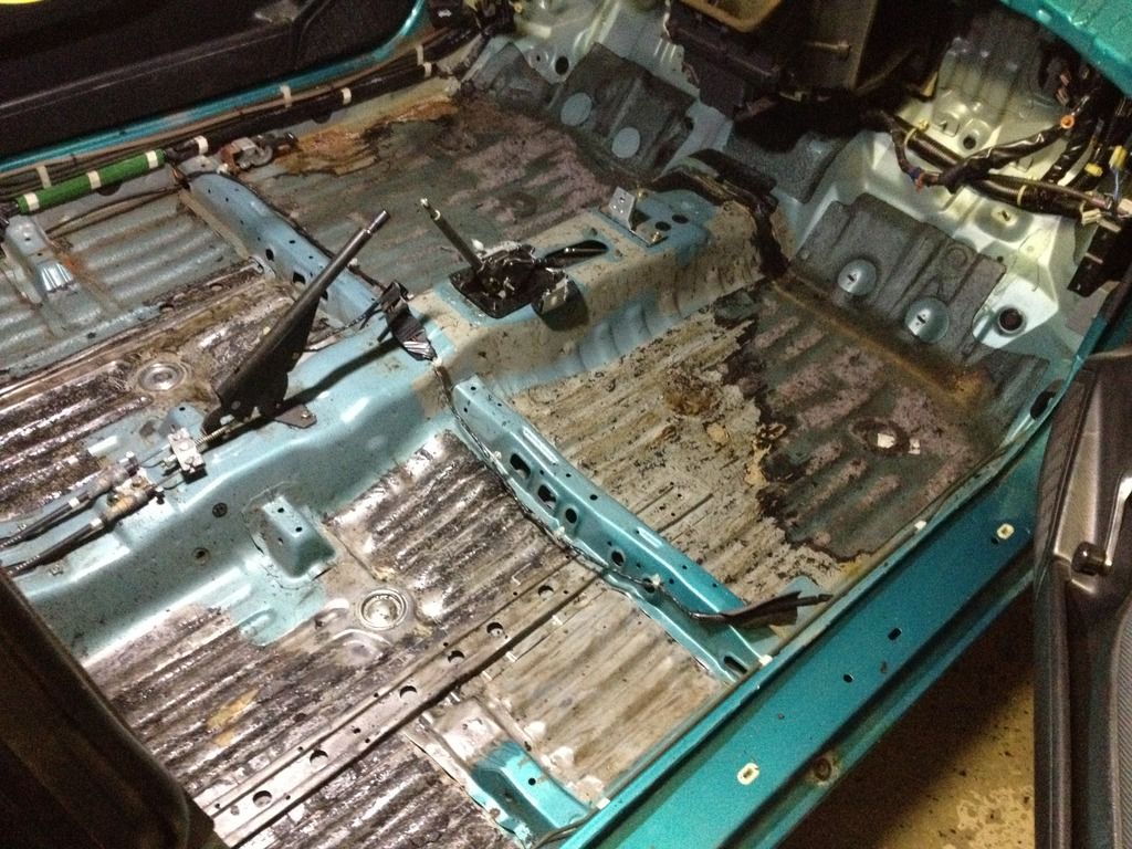

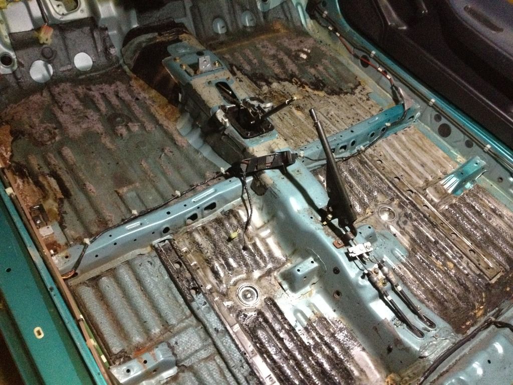

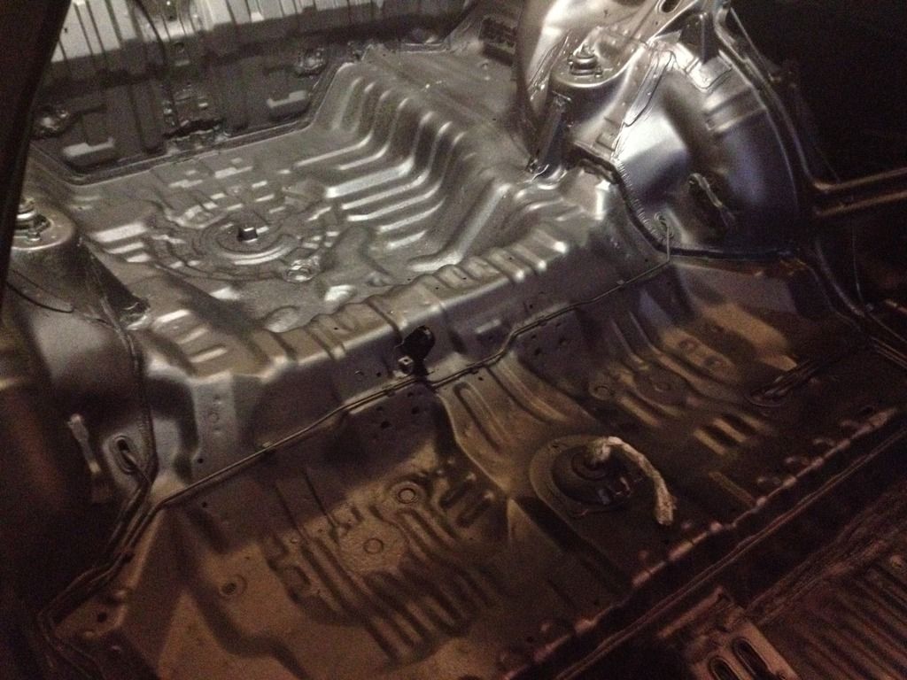

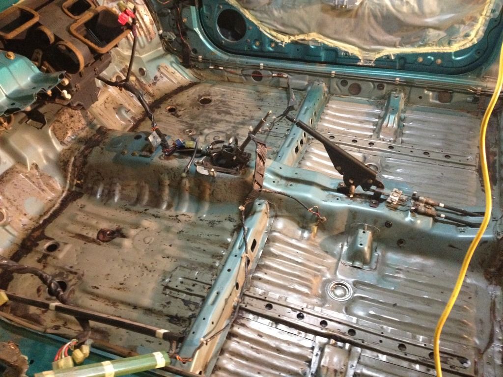

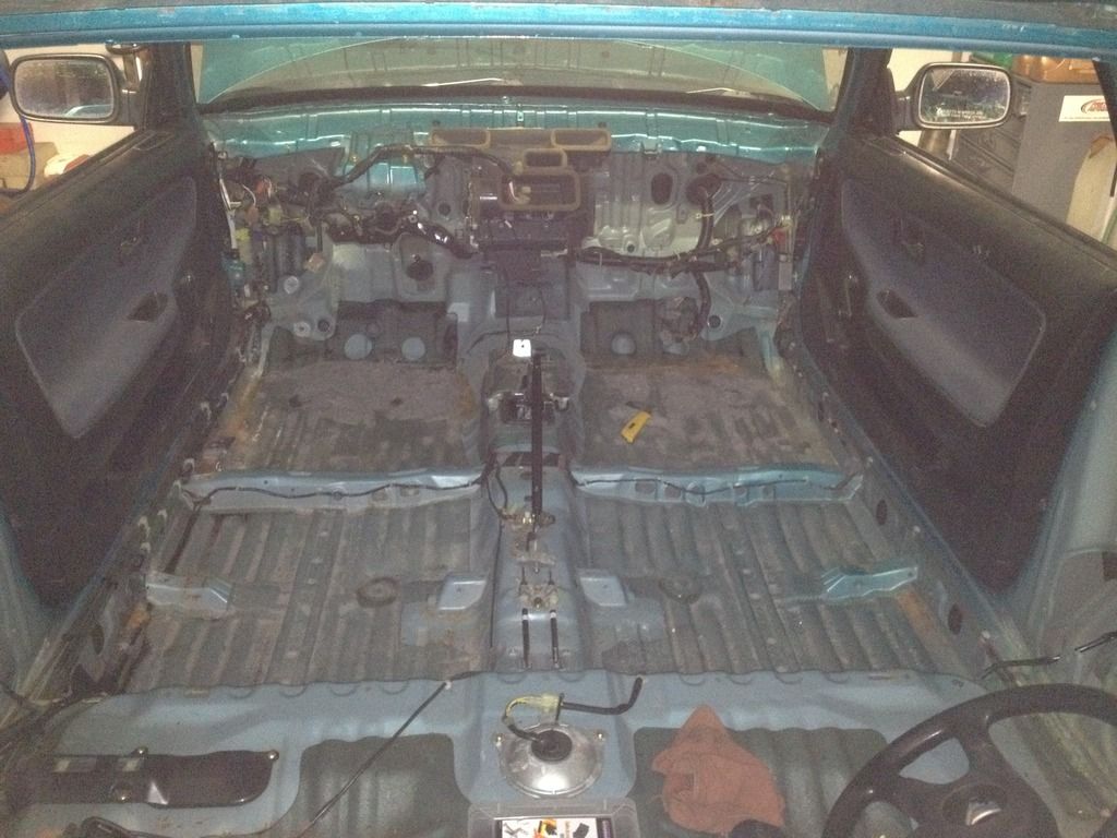

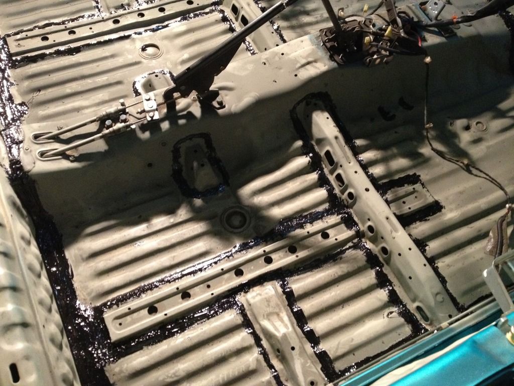

the weight reduction begins and floor reinforcement

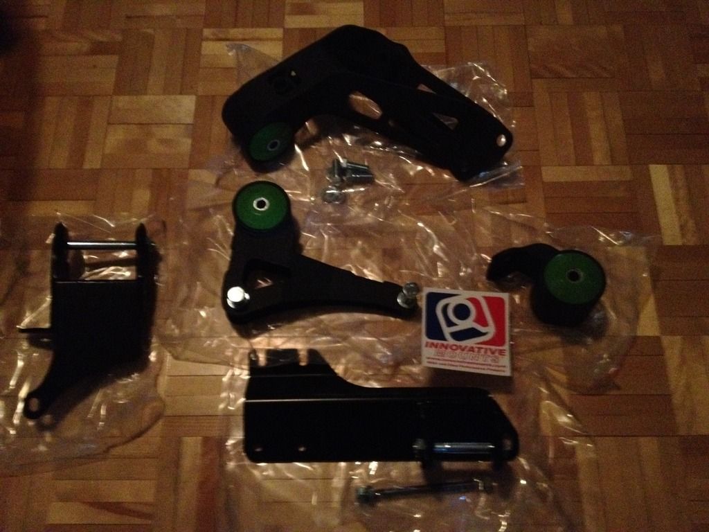

hybird racing mounts and some other things

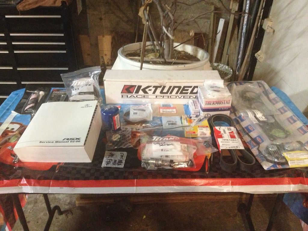

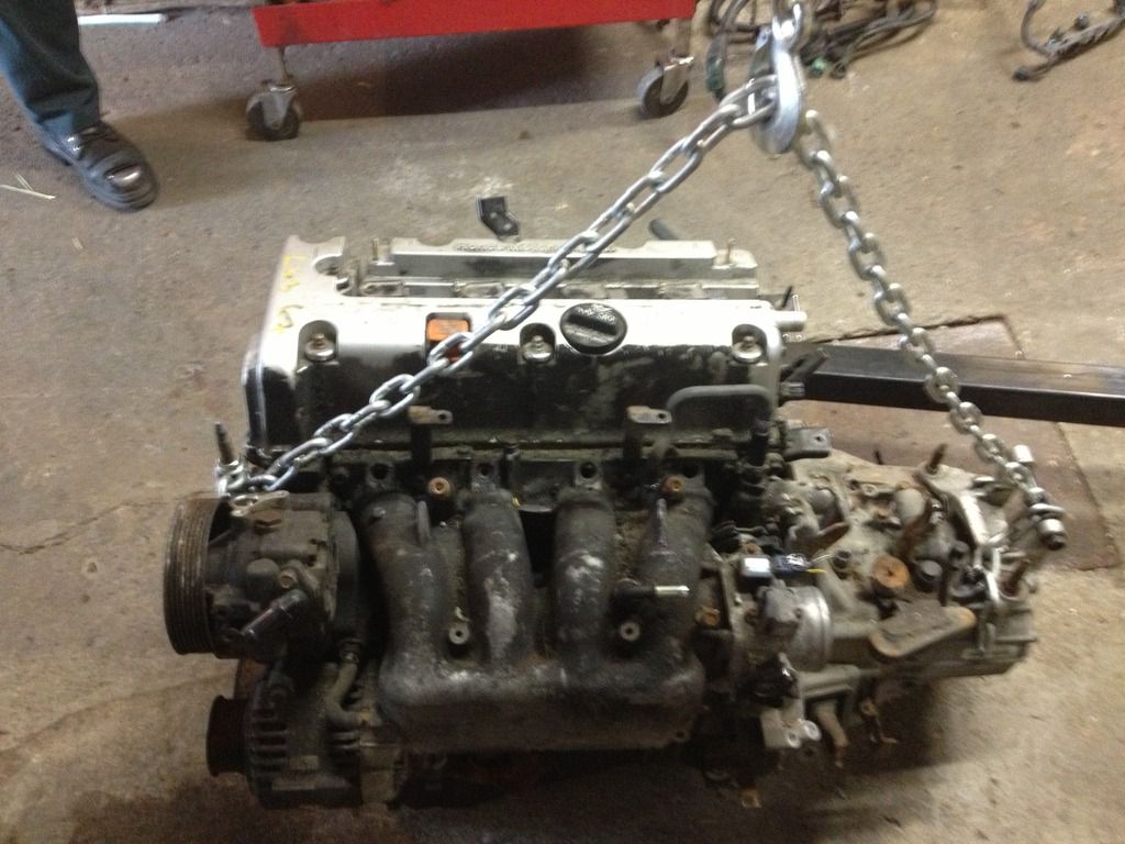

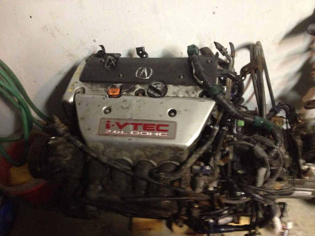

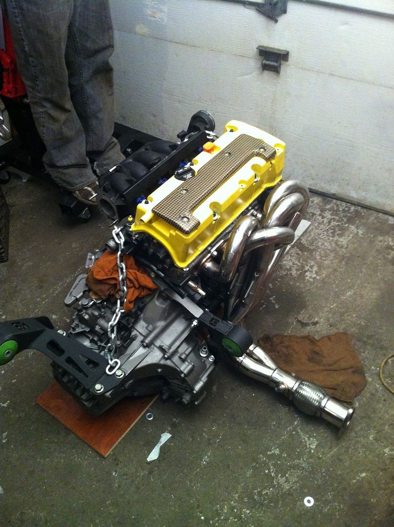

a junk yard find k20a2 complete from rsx type s 2003

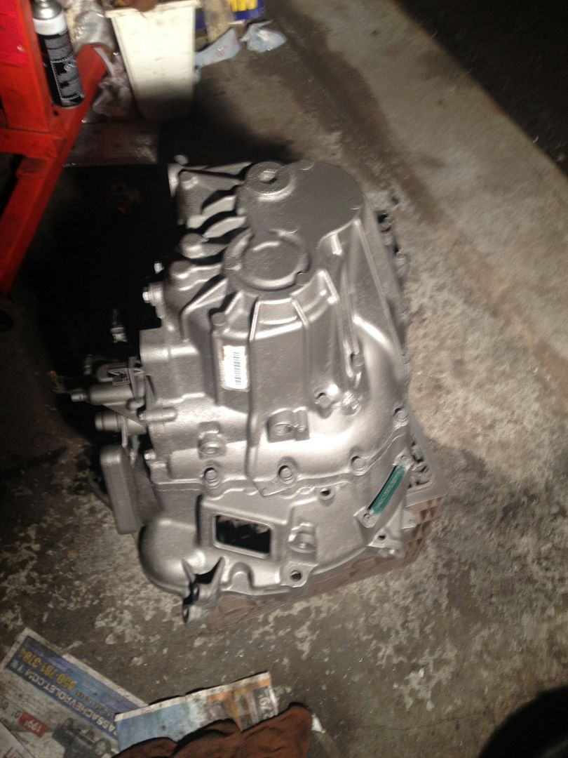

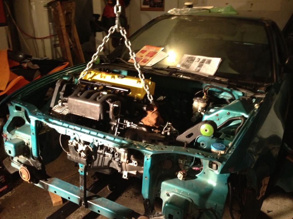

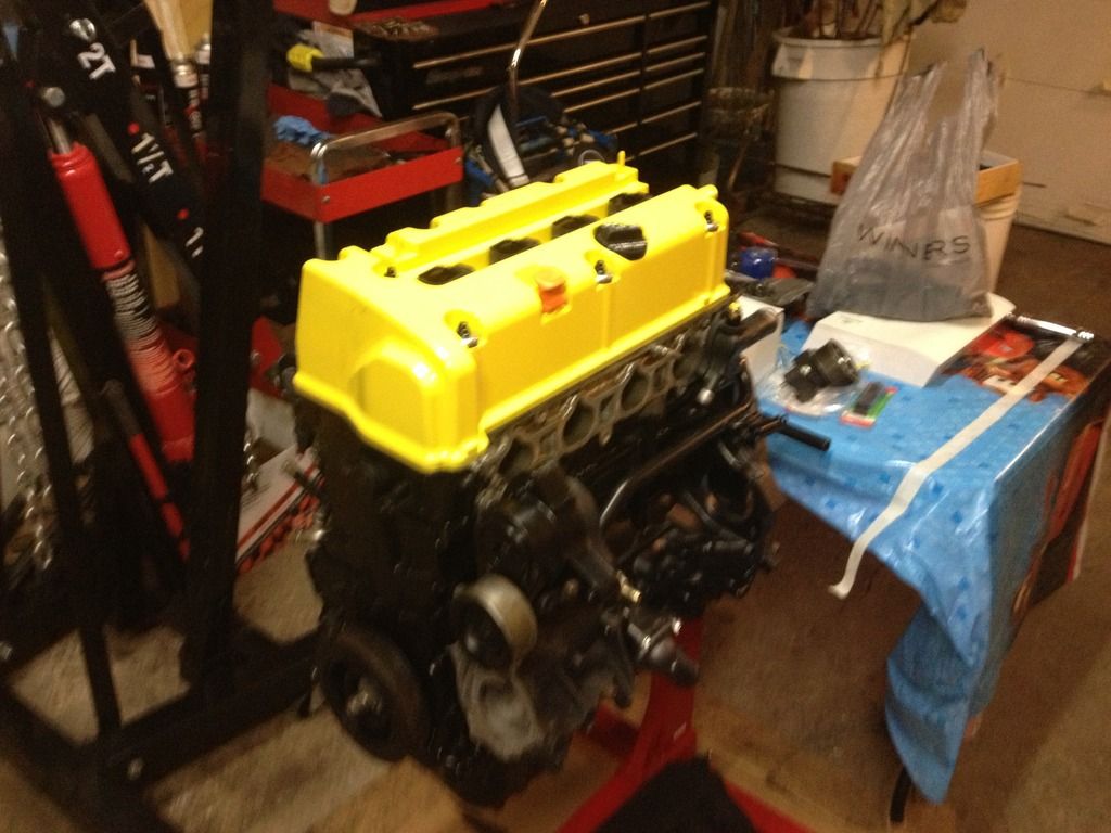

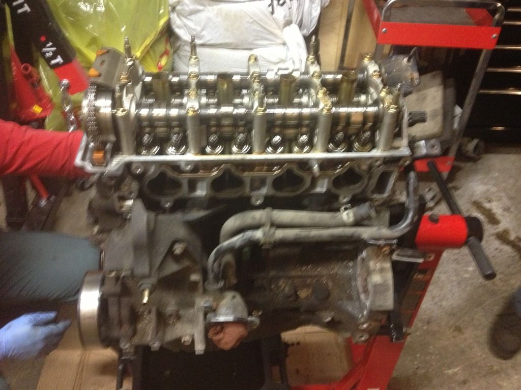

let the k refresh begin
test fit one
more to come soon

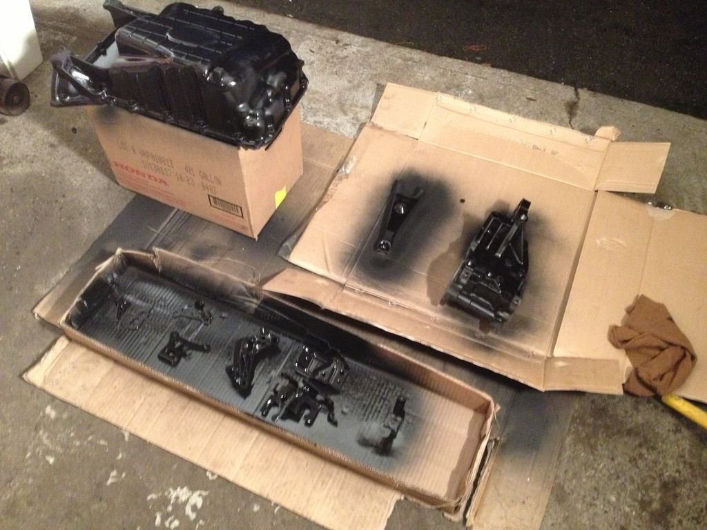

is that spoon yello rocker cover u got?or?
i sandblasted the valve cover and paint it
Engine looks clean! So you went with hybrid racing sides and a rear innovative mount?

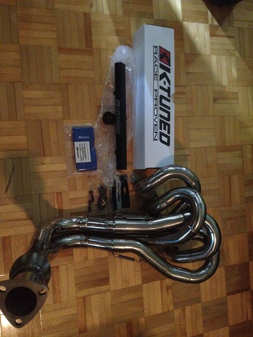

yess and i went with ktuned ram hearder i will post pic soon how it a clears with no mod
yea, if you have innovative's rear mount.. no modification needed!
i have all the mount from them, the rear mount bolt in where the old stock mount was i will post a pic soon u will see

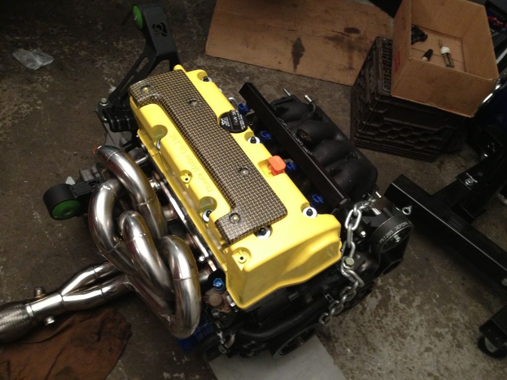

update the motor & header are in i will post pic soon
9

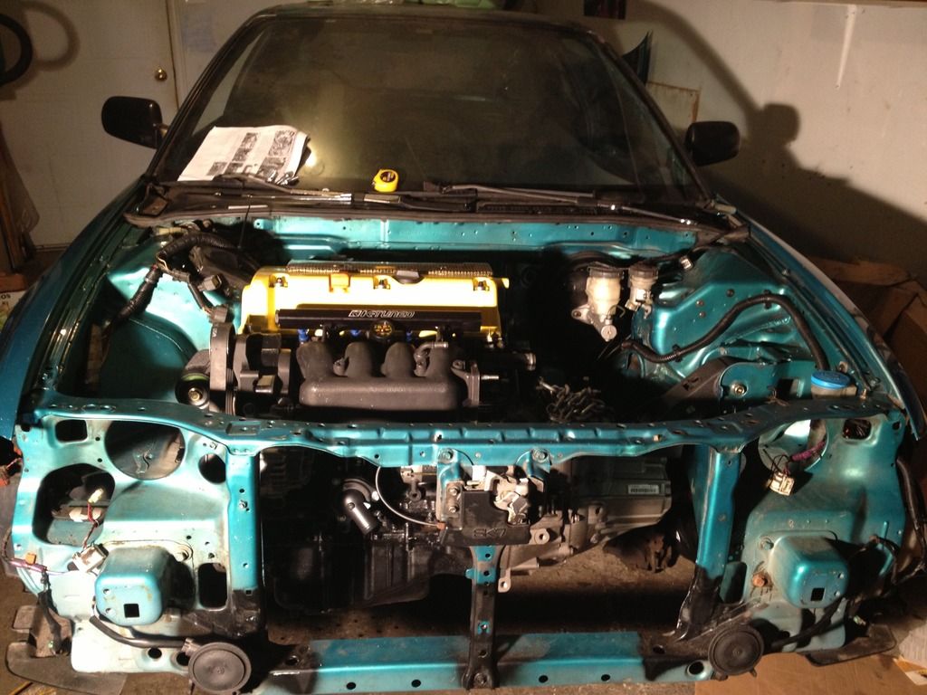

so here are the photos have fun
so the k tuned ram headers fit just just with hybird racing mounts :drool:
the only thing i am sad about is the how low the oil pan is, so maybe in a few years i will get a dry sump system
Brake lines are way to close to your header. Why didn't you want to tuck them?

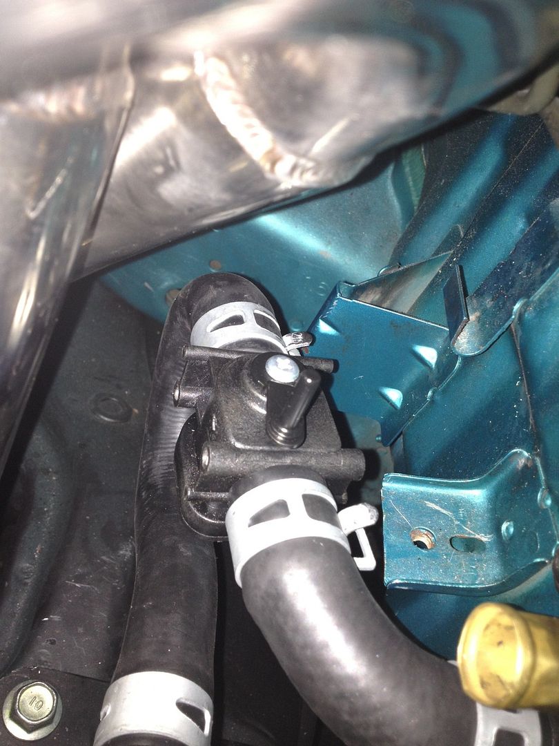

More pics & info on your heater hose set up please
2
i am going to run the car for a bit like then i will redo my lines and up grade the full brakes system i will run a hi temp racing brake oil so i will be ok and here are the pic i use a lot oem hose and cut to fit with a TL 08 water valve, it is the same as a da but the braket are not the same. it fun to be a parts manger at acura lol.
Looking good man! I ditched the heat when I destroyed the plastic outlet in the firewall getting the old hoses off. Oh well. Your set-up is cool!
Do you have to cut and weld the passenger motor mount??
yess but it not hard
