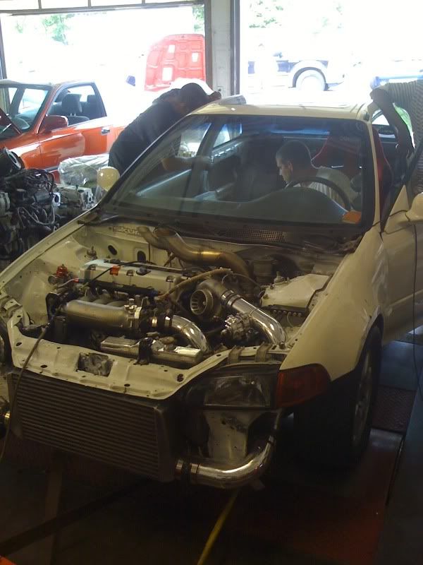

Took some time off work last friday to dyno some cars, here is one of them. The car turned down on 19psi went 10.6 @ 133 at MIR friday night 2nd pass with the boost reallly soft 1st and 2nd gear. With a few more passes this car should be in the 10.2 range. Id also like to thank joe @ tempest again for letting me use the dyno
this car made 380whp on 6psi
and 450whp on 11psi
motor
stock k20z1
stock headbolts and hg
supertech springs and retainters
supertech keepers and spring seats
drivetrain.
stock ep3 trans
obx diff
comp twin
turbo setup
t3/67 non ho
fuel
1000cc injectors
255intank and 044 inline
tuned by me on 25lbs
pull was 3rd gear and can see alil wheelspin

3rd gear pull on 225 50s just trying to save the trans. Ive broke a few doing 4th gear, so i try to go as far as i can in 3rd. I left this car and just went to the track . and the last car was 4th gear pull, just making over 700whp.

lol its a ex eg coupe. a dyno is a tuning tool, if you start with 400hp and end with 500hp you made a improvement regardless of the dyno being used. aslong as its not a land and sea junk thing :p

When you said you had 1st and 2nd gear with gentle boost is that tuning 'boost by gear'? Also are there any specific parts in the Z1 over an A2 motor that you would want to but in an A2 to build for boost? Cams? Also what intake manifold?

Yes he has boost by gear dialed in damn good. Its just the testing stages with it right now. The z1 cams are slighty more aggressive than the a2 but u should just keep either one u have. As far as manifold goes, RBC would be ur best bet. Keep it simple
