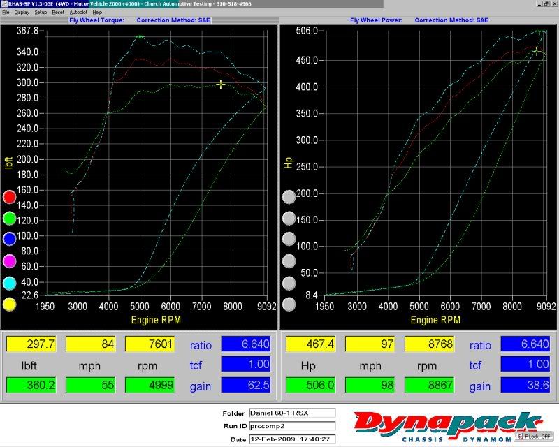

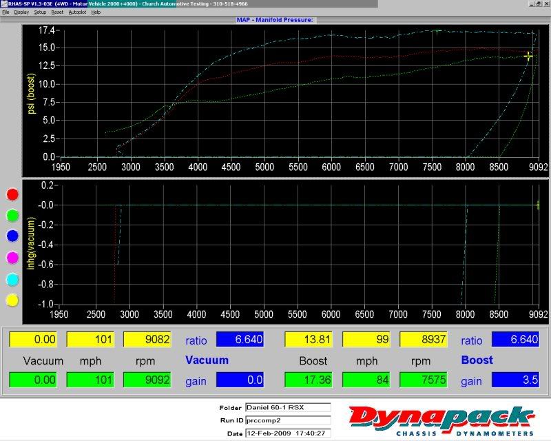

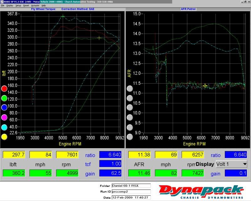

thought i share some graphs for my first round of testing... this setup is a daily driver...
the following is the post break-in tune, done on pump gas and still using non-synthetic penzoil
during this tuning session i broke 3rd gear...was fixed same day so no biggie...
check out the graphs, ill post pics of everything else later
anyone that has any questions, feel free to ask...

nice numbers, what kinda turbo setup are they running in this car and in what chassis??

****ing sweet! :up: We need some vids :)

why did 3rd gear break???? were you doing your tuning in 3rd gear? If its a 4spd dog dox that would prob be right but other than that wouldnt the gear ratio not being 1:1 create a false number do to torque multiplying

my daily driven RSX
full race 35r

cuz i do all my tuning in 3rd and the gear finally gave out, it has alot of passes on it and alot of hard miles
its not a dog box
on our dyno it doesnt matter what gear your in, it makes the same hp and torque...
the ratio you see is the final drive and 3rd gear combined....this is not like a dyno jet...
