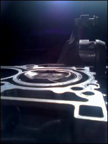

Its lookin like I'm not going to have enough valve clearance for the Type-S valves to clear. I believe a couple of you guys said you'd let me know if I got you pics with the head off, and here's one for now. Thanks in advance!

yea you are goning to need to replace the pistons, the only k24 block you can slap a head on is the TSX. And the pistons arent the only things you need to change.

I figured as much. I'm going to do rods, bearings, rod bolts, as well as head studs. I figure I might as well build it now, rather than being pissed I didn't do it from the start and have to pull the motor out down the road. Plus I've decided I'm probably going to boost it rather than spray on it, so it'll add that peace of mind factor.
K24a1 (CRV) and k24a2 (TSX) doesn't need piston change....

From everything I can see all I am going to need is the CRV mount assuming I run the stock oil pump. I'm not planning on revving the living piss out of it either. I haven't pulled the pan yet (may get around to it tonight), and start pulling the internals, so I can examine the oil pump then.

the difference in a frank built vs k24a1/a2
You must, change or modify piston...
lightly modify k20a2 oil pump...
Its all....
The type S oil pump is not only for high rev... this one is really lighter and doesn't have balancer shaft... so less weight to rotate by the engine....
But in your case, you should send us some other picture, some k24z like the TSX one is so different, I'm not sur everything gonna fit like the k24a series....
