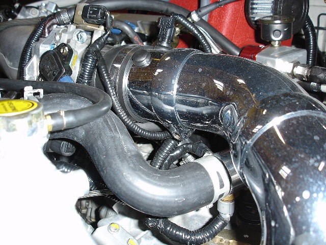

Here's a nice upper radiator hose that will yield good clearances with an intake on most K-swapped vehicles. You can run your intake piping straight out of the TB and not have to worry about the hot hose resting on the piping. It will work basically as is (w/ minimal cutting on the ends) for a K20. On a K24, you can use the front (radiator outlet) portion and then if hooking up a thermoswitch/temp sensor adapter, use a hose on the back end that makes a 45 deg instead of the 90 deg shown, since the coolant nipple sits differently between the two engines. Enjoy...
Hose is Autozone P/N: M248

Quote:
Originally Posted by c_buz
So what does it look like if you don't cut it? Can it still be used? I ask because I have the fan switch in the rad and temp sender n the head. thanks.
It will slap right on if you don't cut it for the hose adapter. The width of the adapter was cut out of the center of the hose when the adapter was installed. Using an adapter is a little more beneficial, since now the hose becomes 2 pieces and you can rotate them a little to drop the setup even lower and further from the intake. The bare uncut hose still yields better intake clearance than most upper radiator hoses out there.

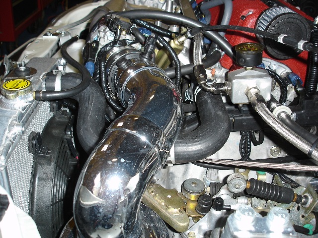

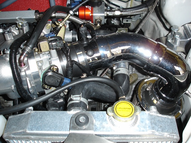

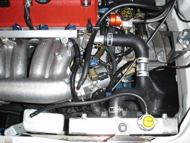

Quote:
Originally Posted by k20asilcoupe
like this a while back when i had mine....
http://www.k20a.org/forum/showthread.php?t=5994
Ah, so you were the true innovator. I didn't even do a search for the part number on here... lol...
Anyway, here are some other pics. These are with an RBC IM, but the PRB/C IM's will still work the same way. The hose will be a little closer to the piping on a PRB/C, but it is better than an RSX upper hose and letting it sit on top of the intake piping. After looking things over, it would definitely help to separate the two and use an adapter of some sort so you can rotate things for added clearance.

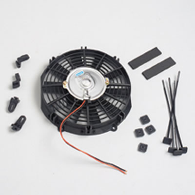

To mount a fan you guys just drill a hole through the fins of the rad??
Also is it better to mount that block on upper or lower rad hose?
I mounted it on the lower, because it was easier to find a upper rad hose that was 1 piece, and then combine for a lower. As for the engine which is better? I guess having it on the upper would run the engine cooler,
00Coupe is offline   Reply With Quote
No, most fans come with these tie wrap looking hold downs that you just slide between the fins.

Old 04-08-2006, 02:01 PM   #18
Vtec_Burnin'
K20a.org Basic User
Vtec_Burnin''s Avatar
Join Date: Apr 2004
Location: FL
Posts: 455
Default Re: Nice Upper Radiator Hose for K-swaps.
Quote:
Any site to order those tie wraps, mine did not come with it. I got SPAL fan.

Old 04-08-2006, 02:08 PM   #19
Karcepts
K20A.org Sponsor
Karcepts's Avatar
Join Date: Sep 2004
Location: Maryland
Posts: 1,423
Quote:
$4.95 from summitracing.com
